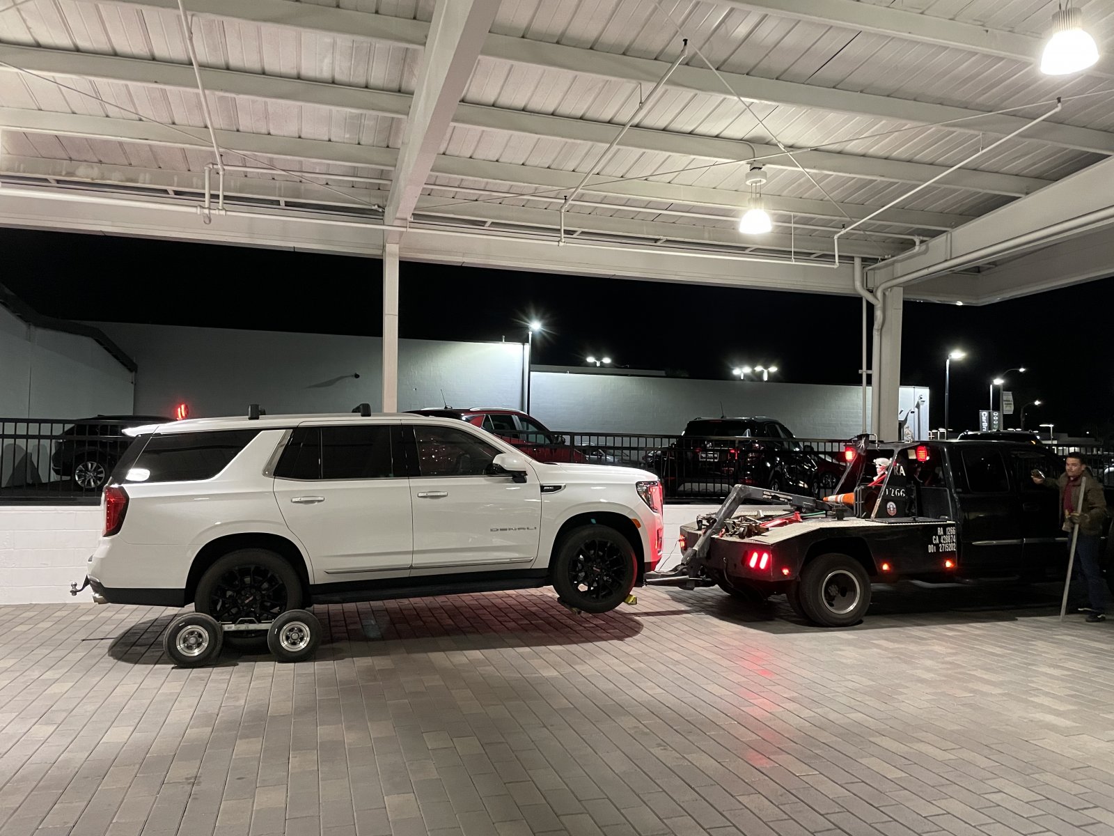

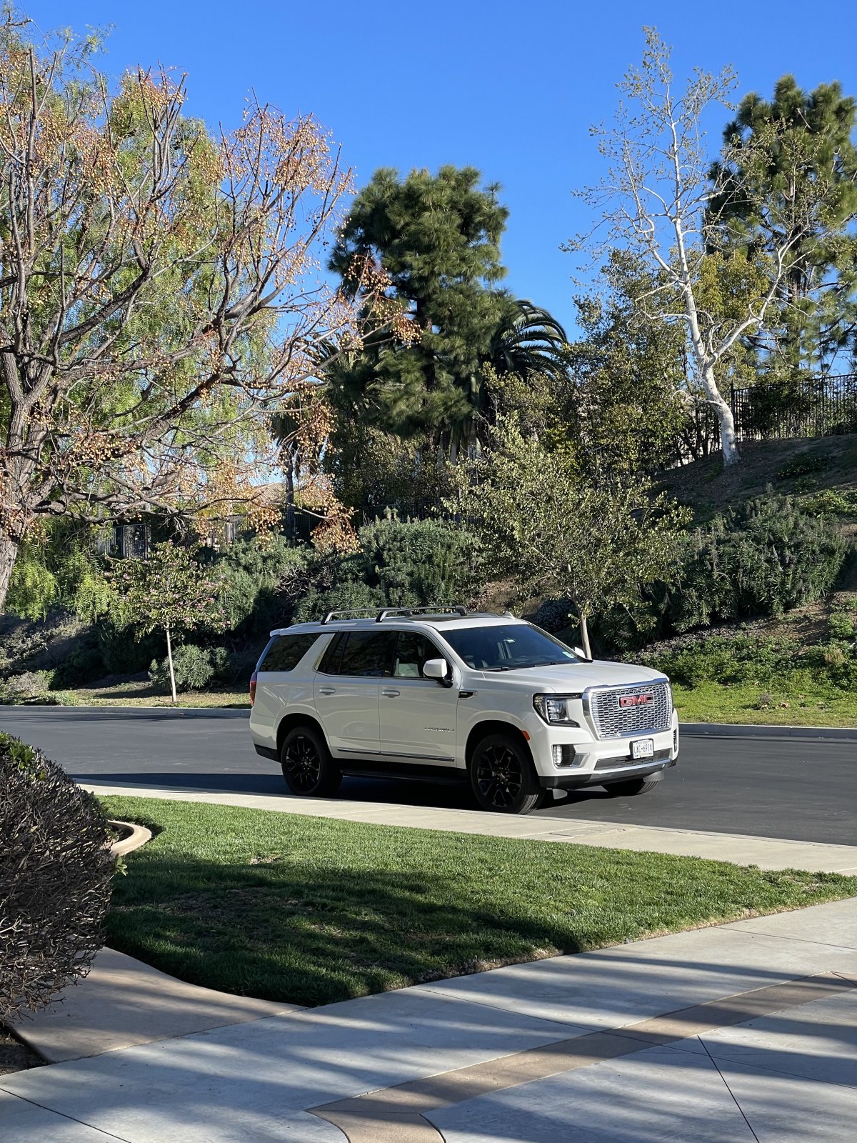

Picked up our truck (finally) after a 9 month wait on the custom order -January 9th. 2023 Yukon Denali with 6.2L. Logged some good mileage, really enjoying the vehicle and all it has to offer. 3600 miles later and exactly 1 month to the day on Feb 9th -
Driving home 1 block from my house, engine shuts off, car goes into neutral and that’s it. I rolled up the hill and pulled over to the curb. Both Kids asleep in the back on an 80° day. Battery good. Car wouldn’t turn over at all. First flatbed couldn’t get us because the car was locked in park and didn't want to damage drivetrain. (3pm) Service dept at the local dealer knew no way of manually unlocking the transmission / getting the car out of “park”.
Fast forward six hours later (9pm) via GM roadside assistance, second truck arrives with correct dolly equipment, all four wheels off the ground and away we go. Cars currently sitting at the dealer with no status updates (after 1 full day) other than potential serious internal engine issues.
What bugs me is zero warning lights, zero signs of issues, really zero anything to clue me in that my vehicle is about to fully fail. With all the tech available, I’m just dead in the water on the side of the road with two sleeping kids in back .. luckily my brother in law came to the rescue in his Tesla.

If you read page 376 in owner's manual in link shows procedure for flatbed vehicle. The tow company that dealer sends should be able to get vehicle set to load but they didn't but also didn't damage vehicle buy not knowing just a lot of frustration for you.
Yeah - this is exactly what we did when 2nd tow truck arrived. Flat bed was not ideal for a car locked in park.
We used the dollies which was the only way to not damage the drive train, per the local GMC dealer .

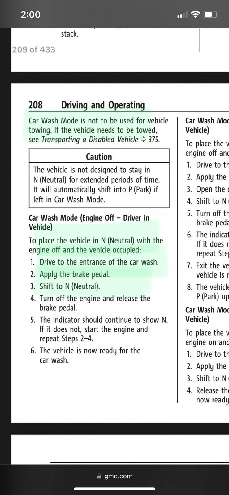

In owner's manual there is way to put vehicle in car wash mode that will let them flat bed and two holes in frame to winch with.They will have to do that at dealer to move in service bay probably.
Interesting- I see it here, page 207-208 of the manual. It does specifically say to not use this for towing though. It also looks like the engine would need to be running in order to initiate the steps for car wash mode. Wouldn’t have been an option for me in this particular scenario - no running engine.
Yea wouldn't use to tow but to get on flatbed would work.
