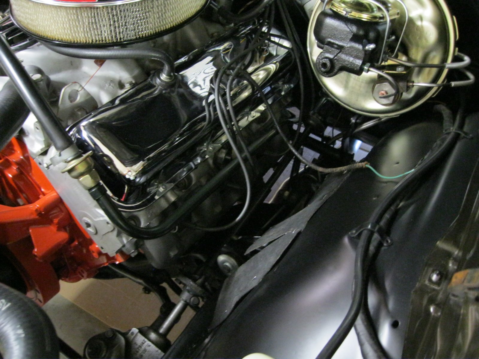

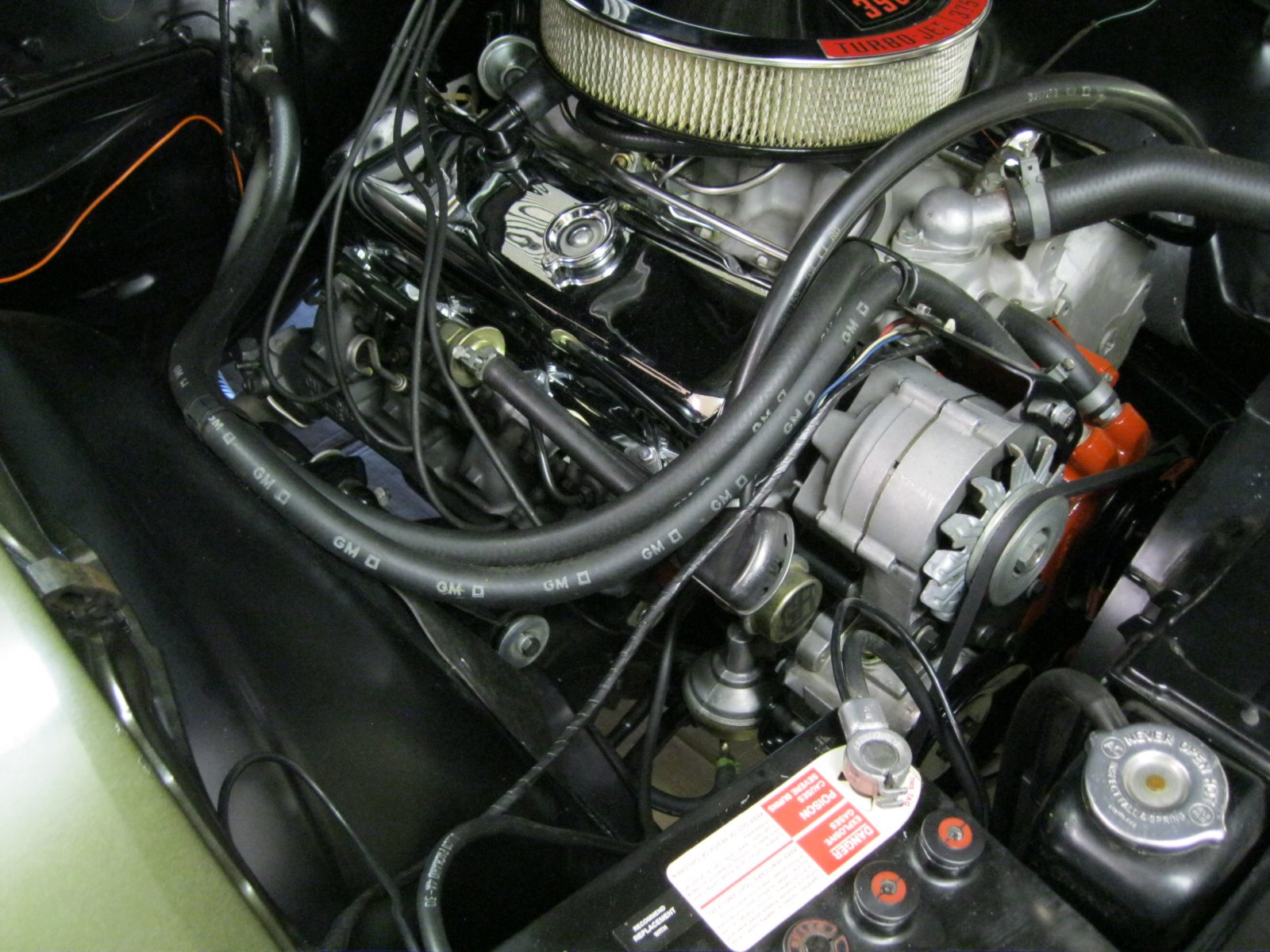

Looking at the size of those ports, takes me back to the old days, when we had big block iron heads to work on. Aluminum heads were rare and cost prohibitive.
Like this
