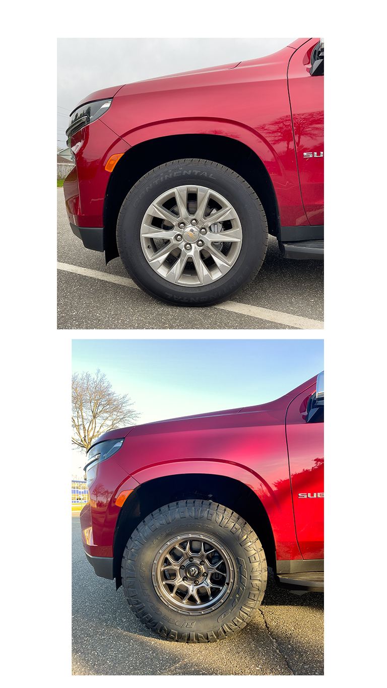

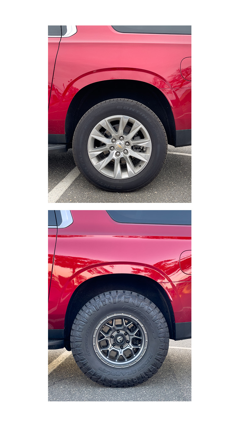

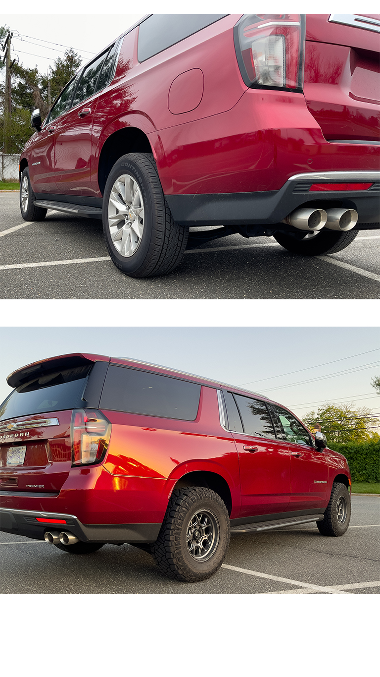

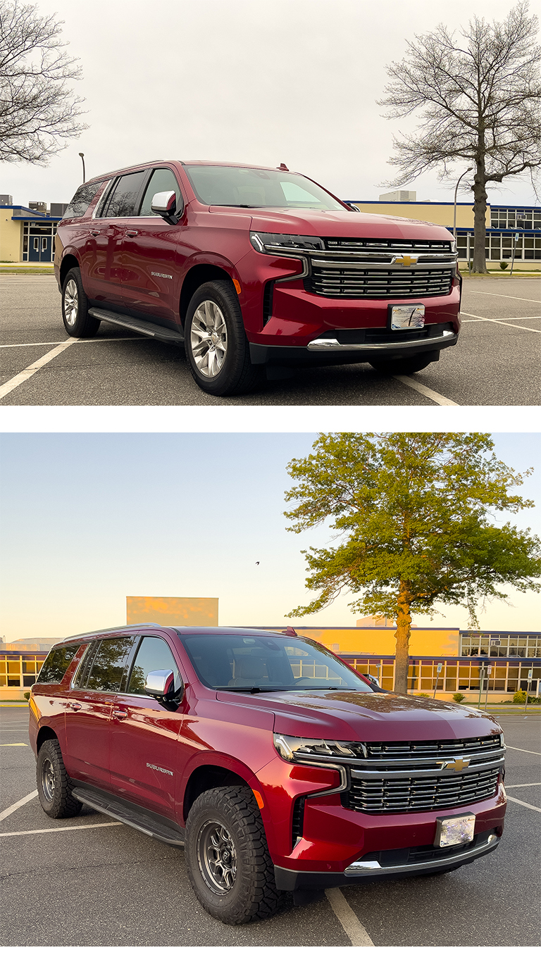

This is an update on my original post. I upgraded the tires/wheels.
The information on this site was fundamental to my project. Thank you.
Below is a side view picture of the before and after
Tire/Wheel Specifications​
Before:
  • 275/60/20 (33x10.8) OEM Tires Continental Cross Contact LX
  • 9Jx20 ET28 OEM Chevrolet rims
After:
  • 305/70/17 (33.8x12) Nitto Ridge Grappler (217080)
  • 9Jx17 ET1 Fuel Tech Matte Gun Metal (D67217908450)

I also had a Rough Country leveling kit. My car has Magnetic Ride Control, and I have had no problems. The installer indicated it added 1.5" of height. I did not get the details of the part that was used. But here is a picture after installation. It looks similar to the one here.

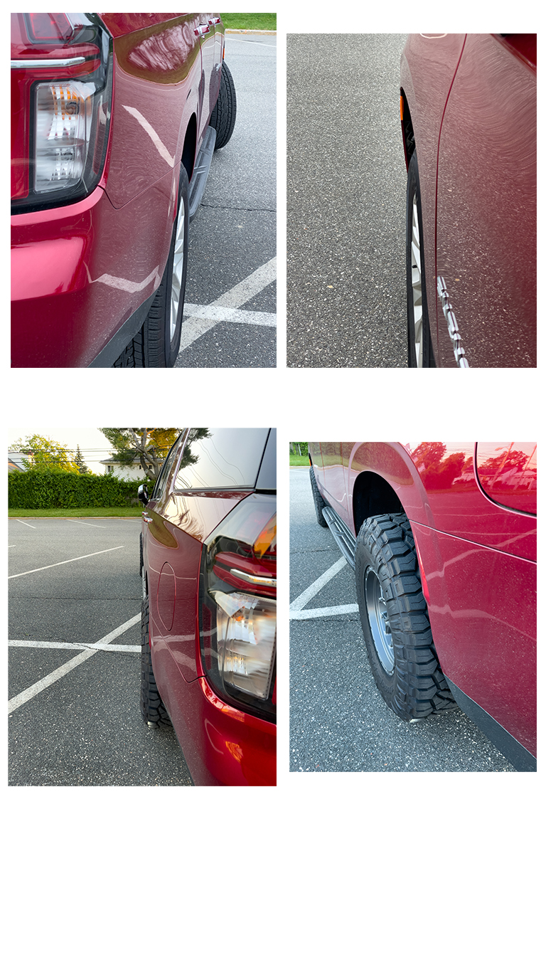

This setup has a little bit of rubbing at full turn. I am deciding between living with it or doing some trimming.
The left image below is the original tire at full turn. Notice the 1/4" gap. The image in the middle is the new tire touching the fender cover. The image on the right is me pushing my finger between the new tire and the fender cover.
The image below shows the driver's side and the passenger's side. Notice that the tire is touching a metal piece behind the cloth coverage on the passenger side.
