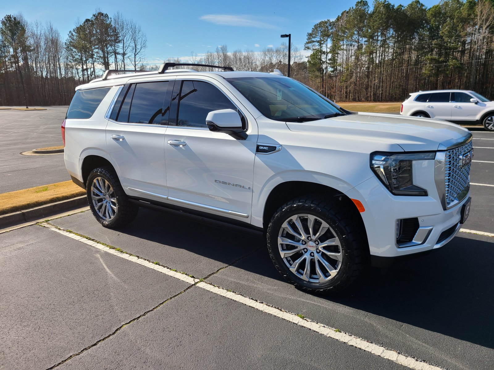

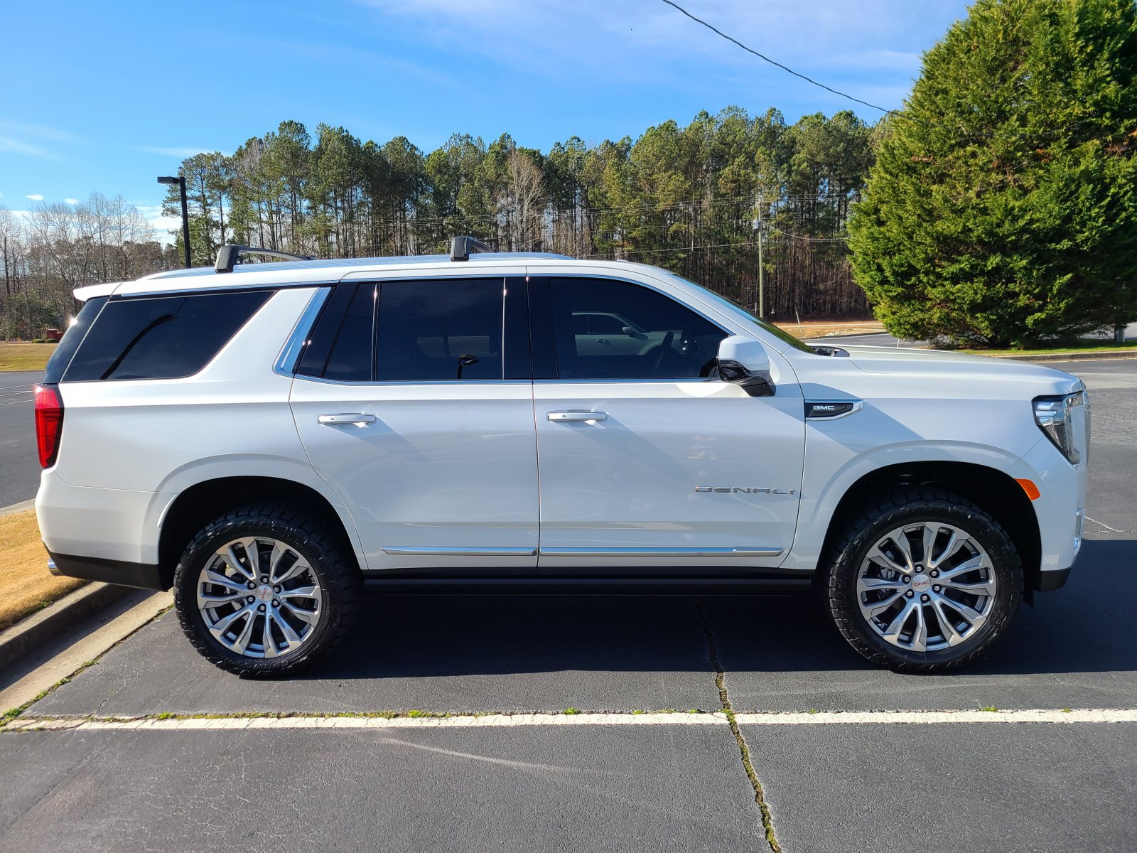

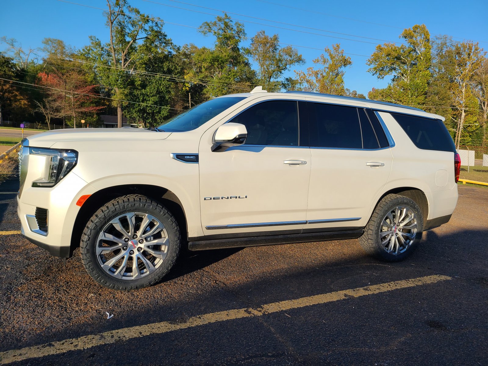

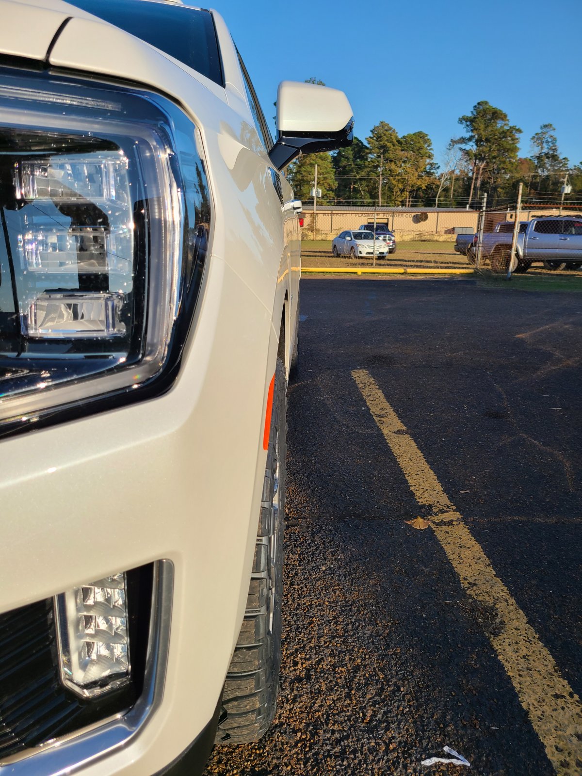

305/45/22 will fit nicely!
Dogged
May 10, 2019
56
78
Just installed a set of Nitto Ridge Grapplers on the stock 22 wheels. Looks so much better. No rubbing at full lock. I don't think it will hit the liner ( but it's within 1/2 inch) with suspension travel. I'll update as I put some miles on it. So far great ride and no road noise.

Hell yea looks great!
They definitely made a bit more room in the wheel wells.

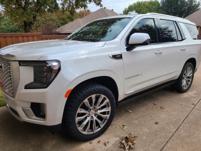

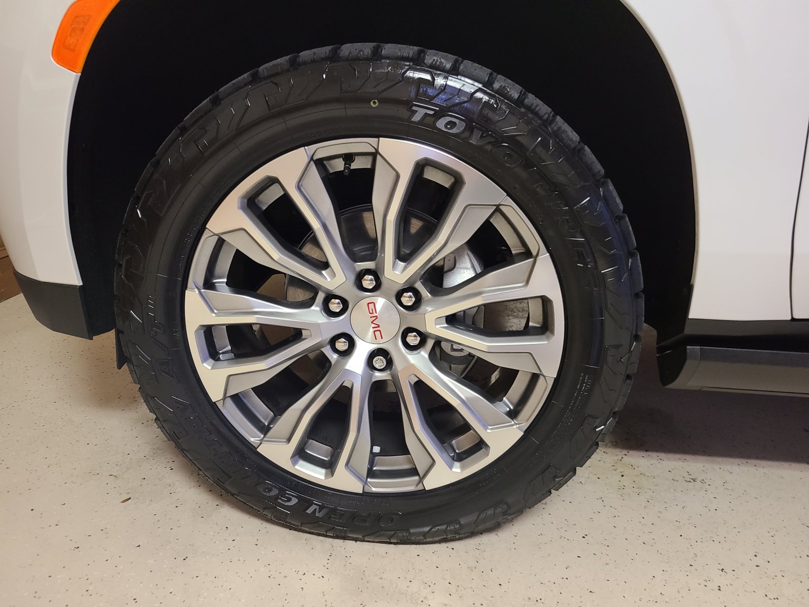

285/50/22
Had very slight rub on inner rear fender well at normal ride height so I did have to zip tie it back just a bit. There's a bracket that the fender liner attaches to that I was able to remove and that gave me the room to pull the liner back and tie it off. You can't even tell it's there unless you're underneath so looks fine.

Any road noise with the at 3's??
