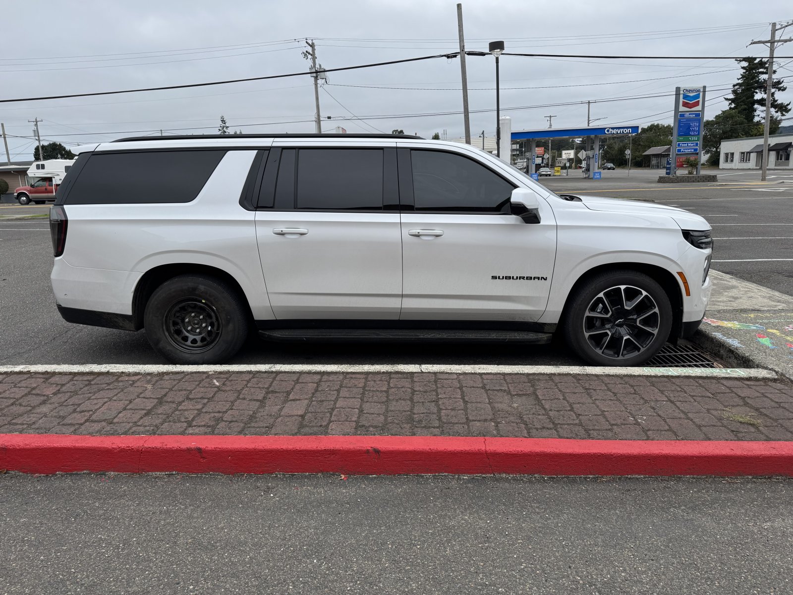

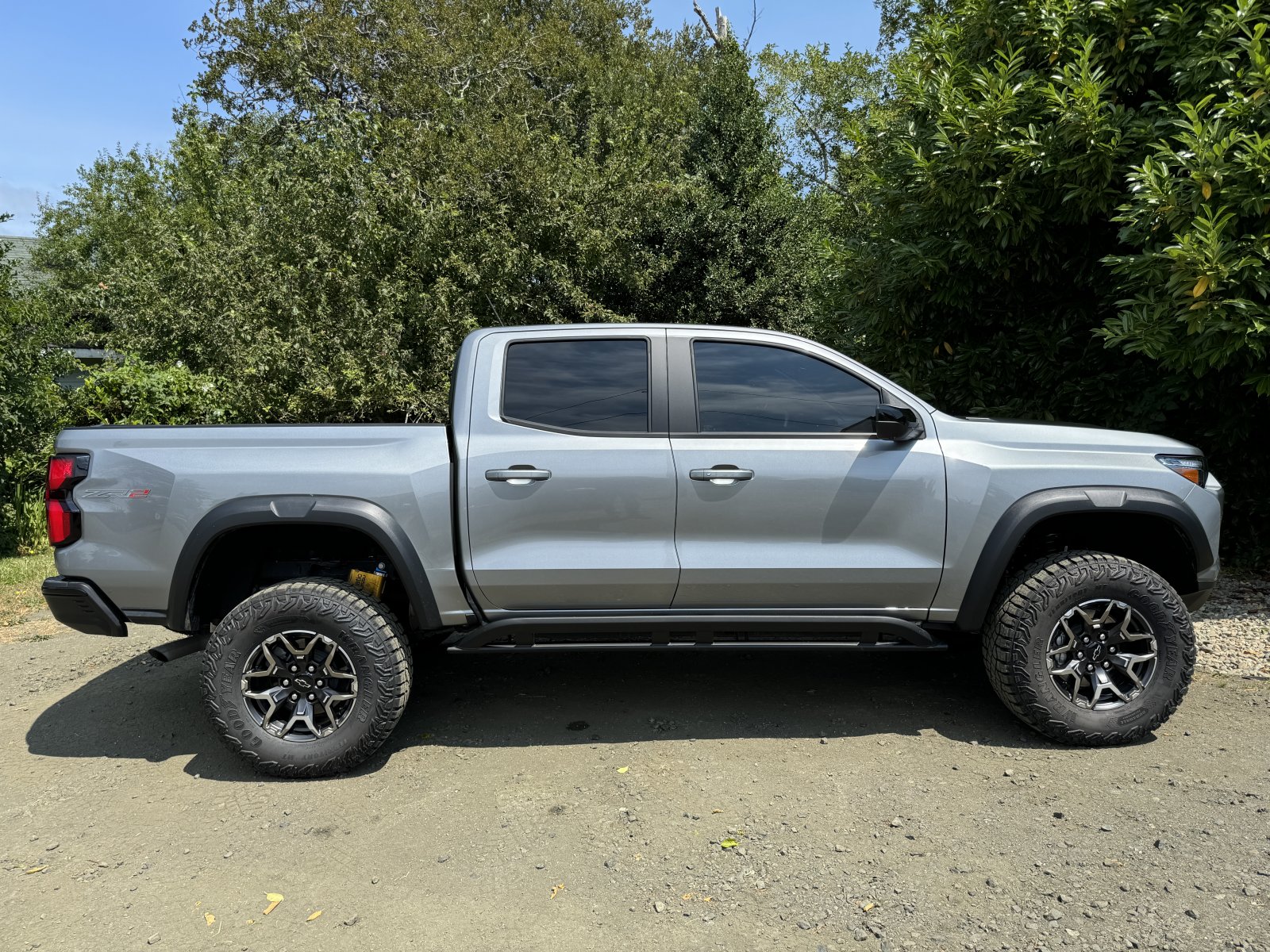

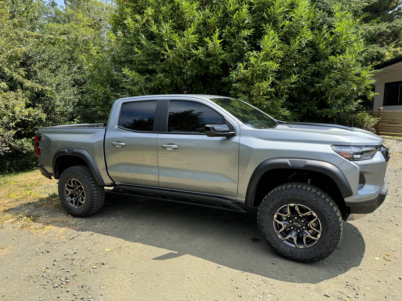

Welp, my wife completely demolished one of our 22” wheels on our 2025 Suburban RST. I kinda knew this was going to happen and now I need to figure out what route I want to take. I think ideally, I would like to go smaller wheel/larger tire. I have a 2024 Colorado ZR2 with 285/70 R17 wheels and tires that I think might look good on the RST, but I’m not sure. Do you guys think those will fit? I have the air suspension, if that matters much. I’m hoping 17’s clear the calipers. If that works, I’ll probably upgrade the ZR2 wheels and tires to 35”s.
If that doesn’t sound good to you guys, do you have a recommendation for an aftermarket setup that looks and works good? Want to go smallest wheel diameter that makes sense, and largest tire that will work.
Any negatives you can think of with a taller sidewall with these rigs? I don’t want it to ride like an absolute boat, but a less jarring ride also sounds nice.
Thanks in advance! These are the wheels I’m considering.

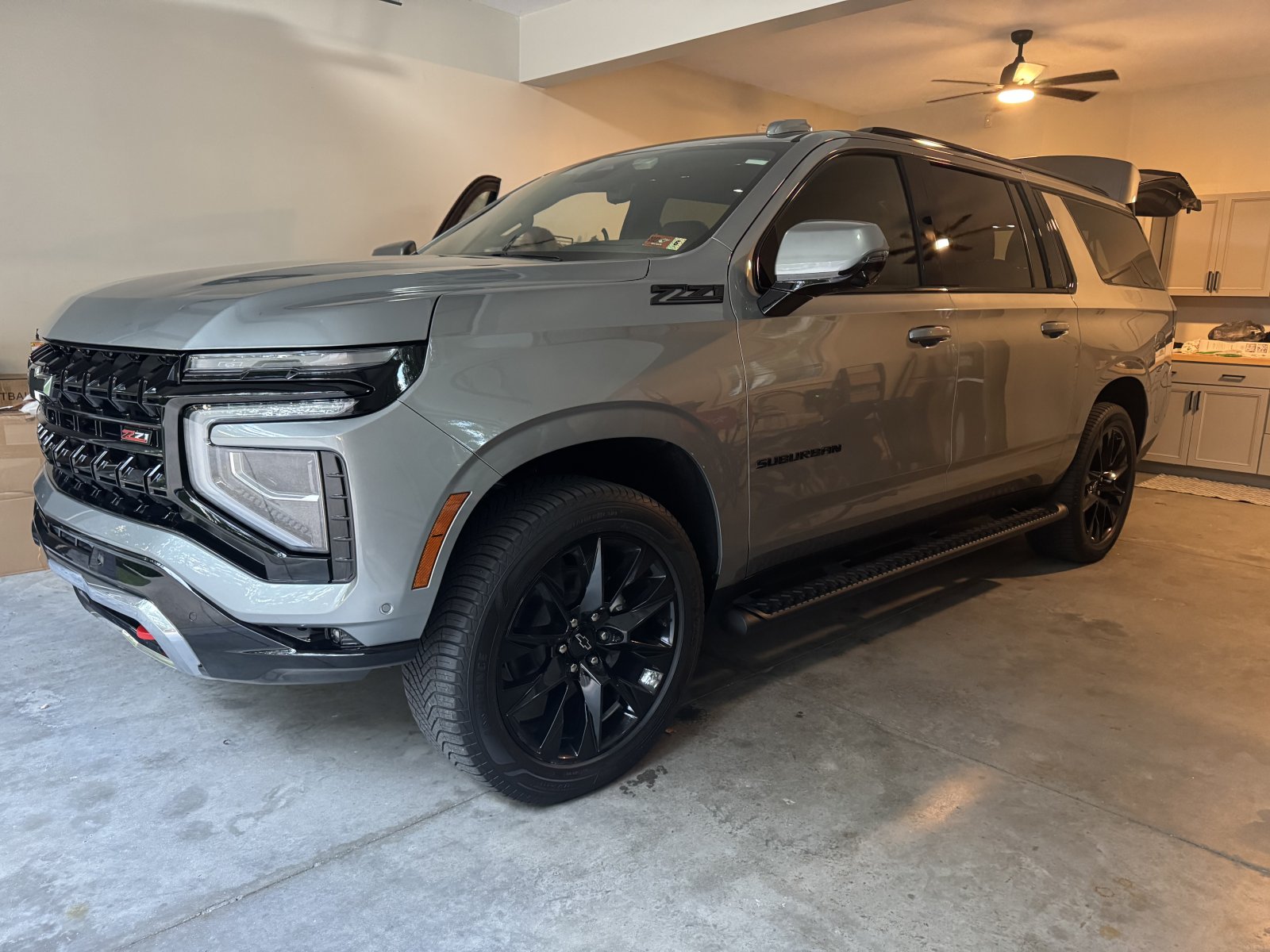

There are other size wheels and tires for your year of truck, 18" and 20". If you keep the overall diameter the same as the original tires you shouldn't need any programming, I don't think there is any available. I went with a 285 45 22 Michelin Cross Climate 2 because I wanted that tire and they don't offer it in the 275 50 22 size. It is a touch shorter than my original size.

I like the Cross climate tires a lot— put them on the better half’s 4runner. I may try the 275 50 20s next time I swap my tires

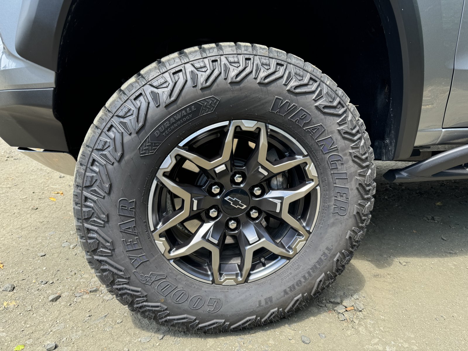

Something to add, I just looked at the factory spare and it is 17”. So I’m hopeful the ZR2 wheels will fit! My only worry is the crunch crunch crunch I may hear when the air suspension lowers

If the GM OE spare 17" wheel & tire fits over the 4 piston calipers,
pics or it didn't happen ...
D
DieselBus
Sep 12, 2025
Well, it at least fits over the rear brakes… ‍

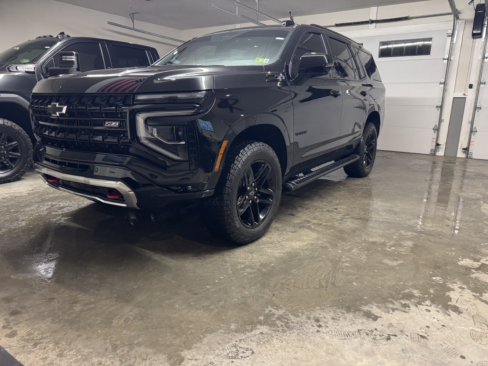

Tons of Replica wheels in all shapes and sizes on eBay. I run a set of 20” trail boss replica on my Tahoe. And I have a set of z71 style replica 22” wheels on my wife’s suburban.
Those who like the Michelin Cross Climate 2’s should look at the Goodyear Weather Ready 2. I have never been a Goodyear guy but they have been excellent for my wife and they come in the factory size.
