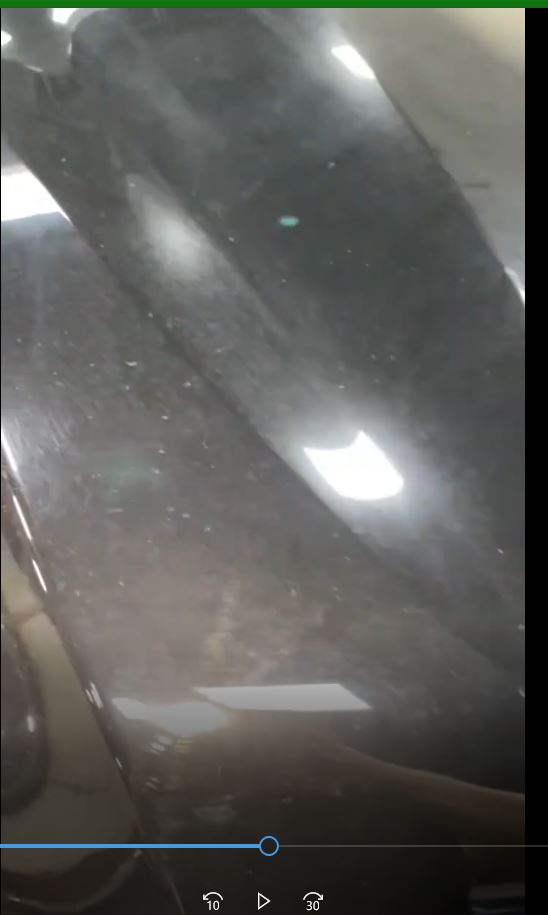

My 2022 Tahoe 3.0 was built in May of 2022 and finally was able to take delivery 2 weeks ago. Sitting in Texas for the last 7 months I had my worries about the paint condition and tires (flat spots). My concerns were validated upon delivery.
-Paint was already swirled from being washed with all the dirt and plenty of hard spots - see BadPaint.jpeg

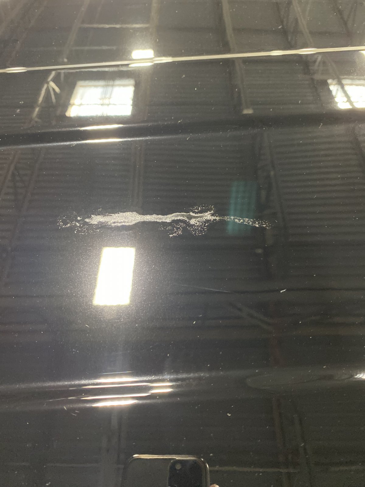

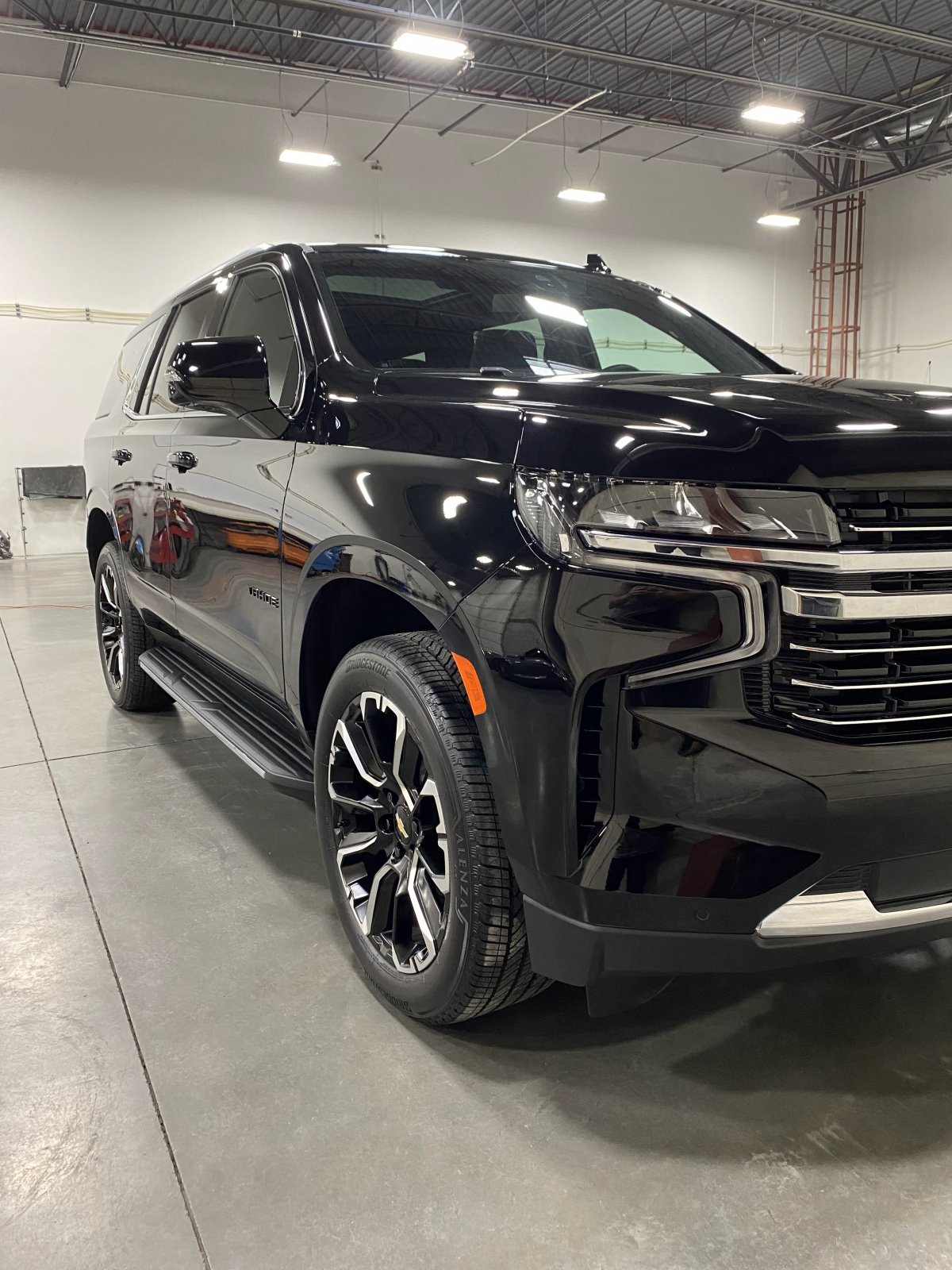

Purchasing dealer offered to buff the paint, I didn't want them to make things worse and took it some someone that actually knows paint and does high end ceramic coatings on everything from $300k boats to Lambos. Still waiting on the solution for the roof paint. It was my coating guy that found it. Was a PDI even done on this?

Also posted a photo after 25 hours of paint correction and ceramic coating. Looks great now.
