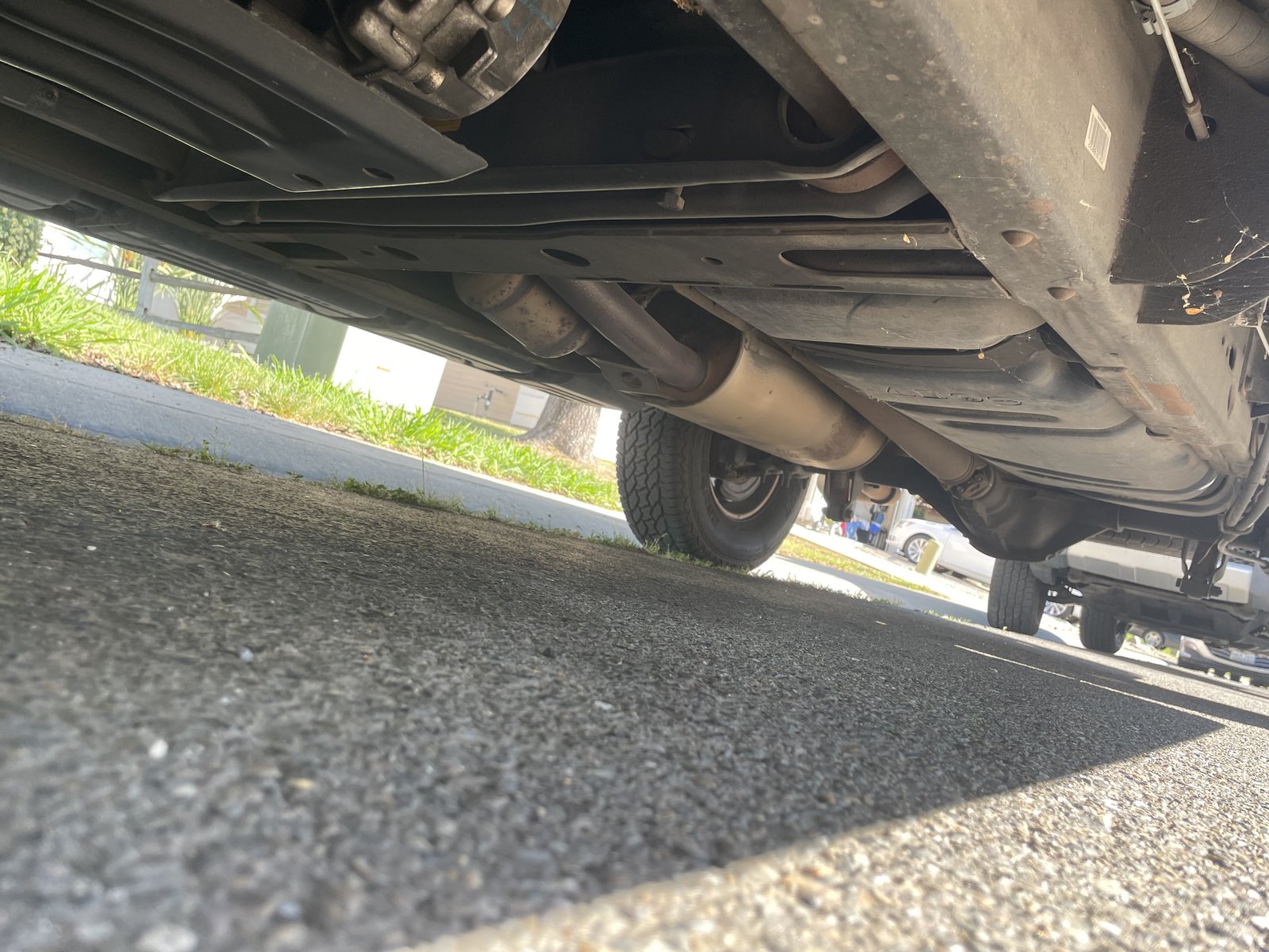

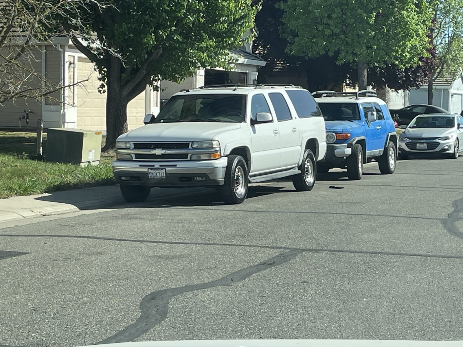

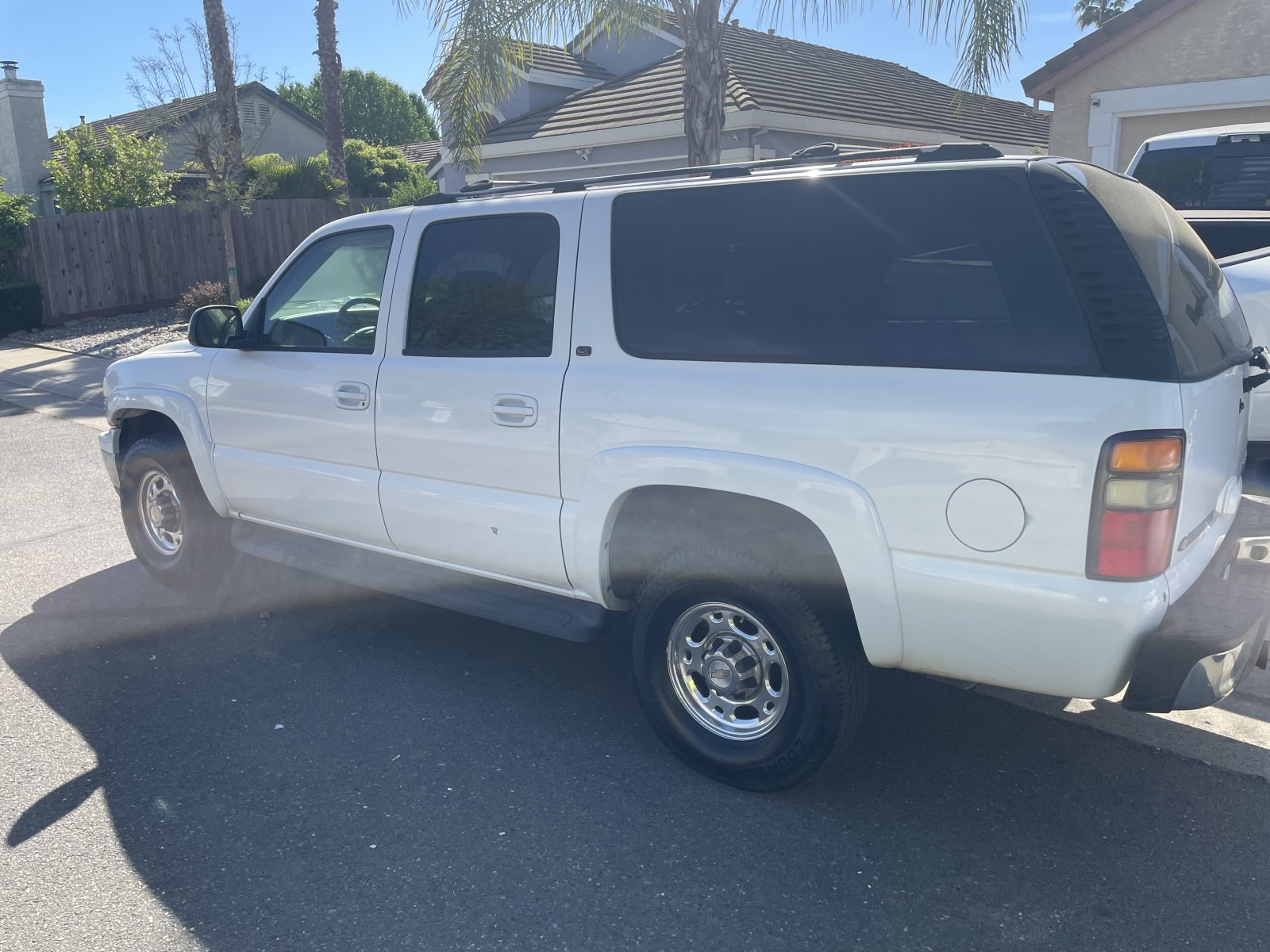

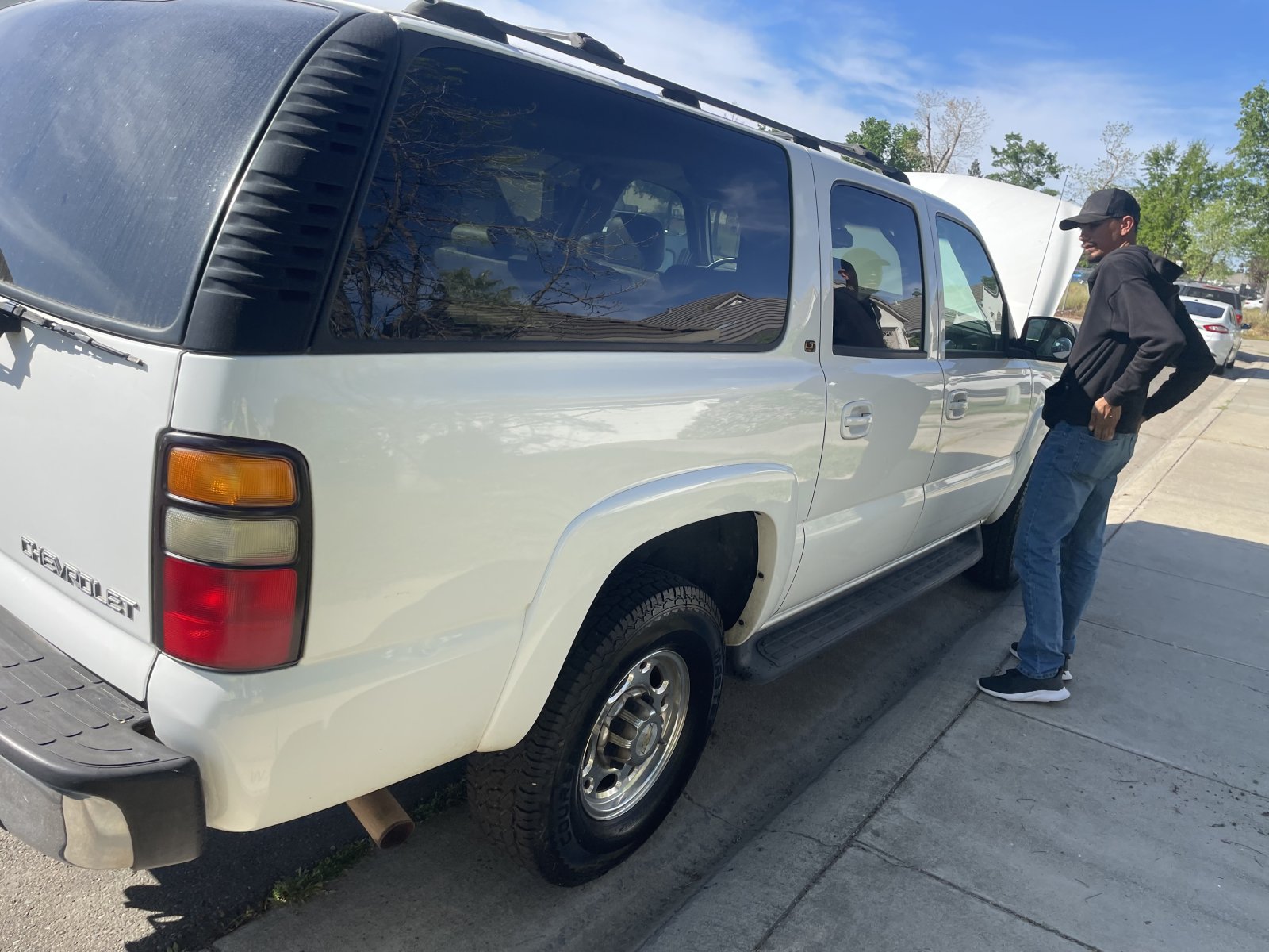

OK, heres the deal..Guy bought it to flip, so it was tire shined up and slimy. It drove fine, you can feel old shocks and suspension, but no weird noises no problems. Started out cold. Felt more like a 2000 era vehicle than my '12 tahoe (duh) Has a trailer brake controller, so who knows. GT5, 4.10 gears? Pretty clean body (3 small spots of flaking paint) about as good as you get. No rust, I'm in california. Interior has a few broken vents but otherwise not bad! Tires were good! Thick tread.. Not as clean feeling as my '12. OBS NBS seats really are more comfy!! Little exhaust leak somewhere on passenger side..
I drove it a good 15 minutes.. Coolant tank looks low or dark, but I think it's just how older ones look..Heres some quick pics I took..

Any broken exhaust manifold bolt heads?
I did not check yet, but since my '12 has broken manifold bolts, it would not deter me if I wanted to purchase.
I do worry about a broken cat or oil leaks (since it's been ghetto detailed) but driving around it felt solid, just a little dated. And I doubt fluids were changed.. Considering running a carfax, but this vehicle would only be a backup, and without garage space, would be left in the elements, so I'm wondering how much I really need it..
