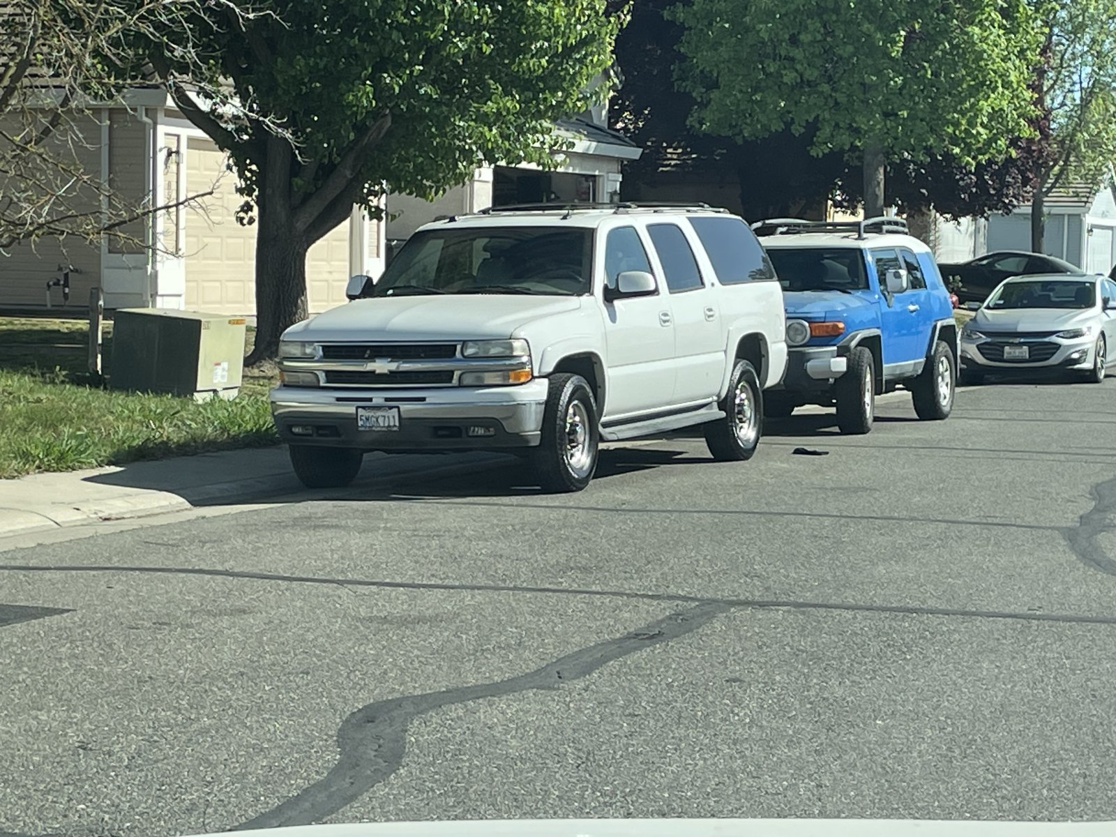

Thanks to Bigburb3500! I'm in for $6k..!
Hoping to do some final checks for any major issues I could have overlooked (4wd etc) and hopefully pick it up soon! (tomorrow at the earliest..)

You are "in for $6k" on a bid or you bid that or offered that and was accepted?
Hoping! I offered 5,500. He countered with 6k. I said yes.. (But I need to verify 4WD works)
I'm on for tomorrow afternoon!
Carfax looks good, but nothing recent.
Trans fluid flushed at 61k in 2009, regular service until 2012.
Last service with various repairs in 2018. (encoder motor sensor, brake booster, o2 sensor)
Just smog checks after that upto 2024.
I think this is a great deal on this truck. Clean it up nicely and this is an AWESOME truck. Now that I convinced you to spend $6k… drop another $8k on the 10L swap! Hahaha
I’m good at spending other ppl’s money

If they are selling that blue FJ Cruiser too, they will make up what they lost in profit on the Suburban. Those Cruisers sell for top dollar in CA.
