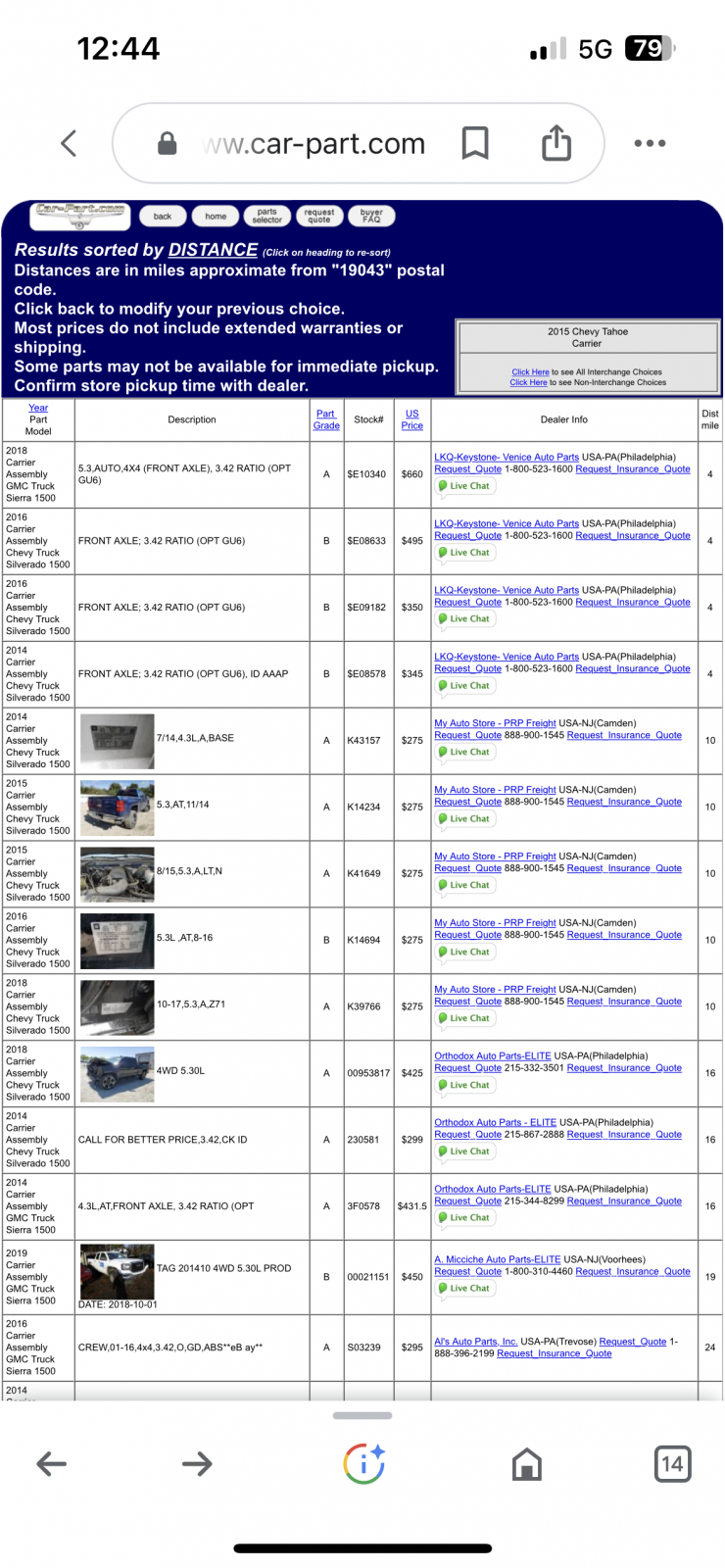

Go to www.Car-Parts.com. That will give you a list of used parts available in your area.
You will want to search under Axles and Brakes/carrier assembly.
wjburken
Dec 26, 2017
10,315
29,545
Eastern Iowa
Here is what I get when I search your zip code.

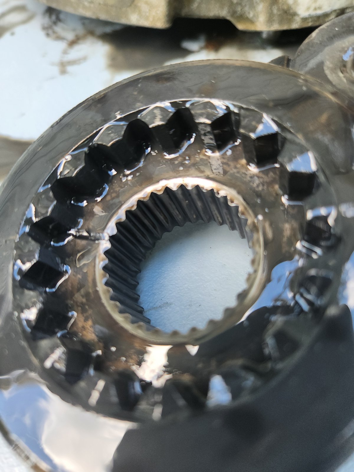

Well gents, the mystery continues as the diff looks fine to me. But I am also a novice so who am I to say.

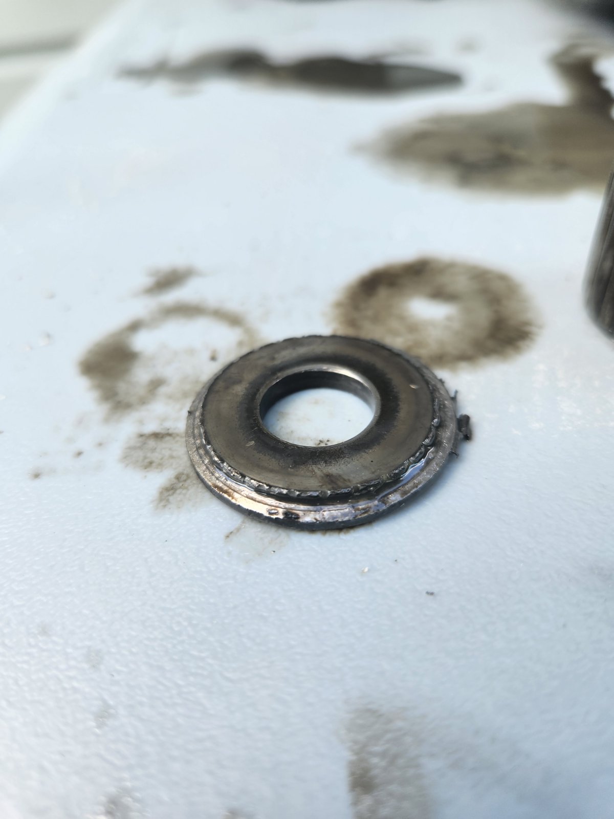

Actually I found this, maybe the source of the metal?

What is this washer for? Looks like it was just free moving around against the teeth.
fatmonk8
fatmonk8
Mar 16, 2023
261
85
Looks like this gear is for the 4wd. Makes sense as I didn't realize it would put the tuck in 4wd while in automatic mode while driving on pavement. So probably wore down after being driven in 4wd all the time on pavement.

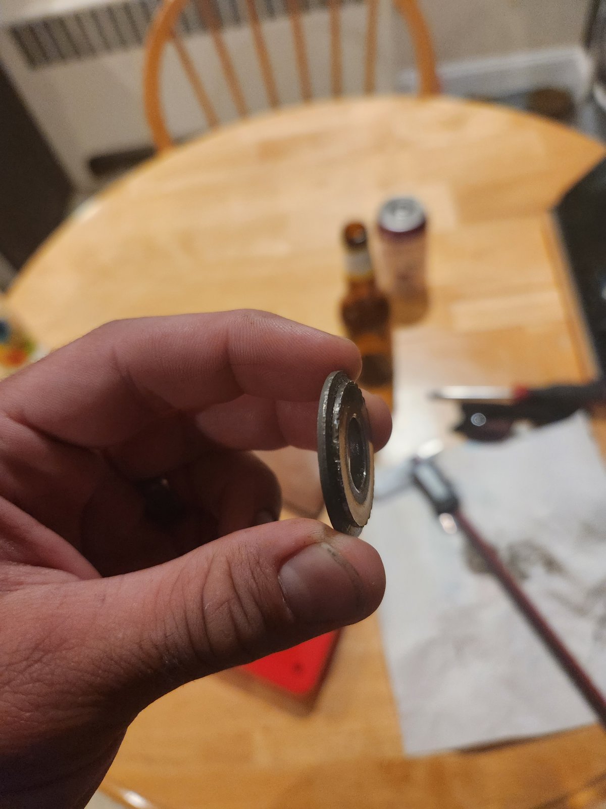

Found the part!
It's a 3.55 mm Front Drive Axle Clutch Gear Shim.
Pretty sure the shim is not supposed to have this shelf on it. It's worn down pretty bad.
