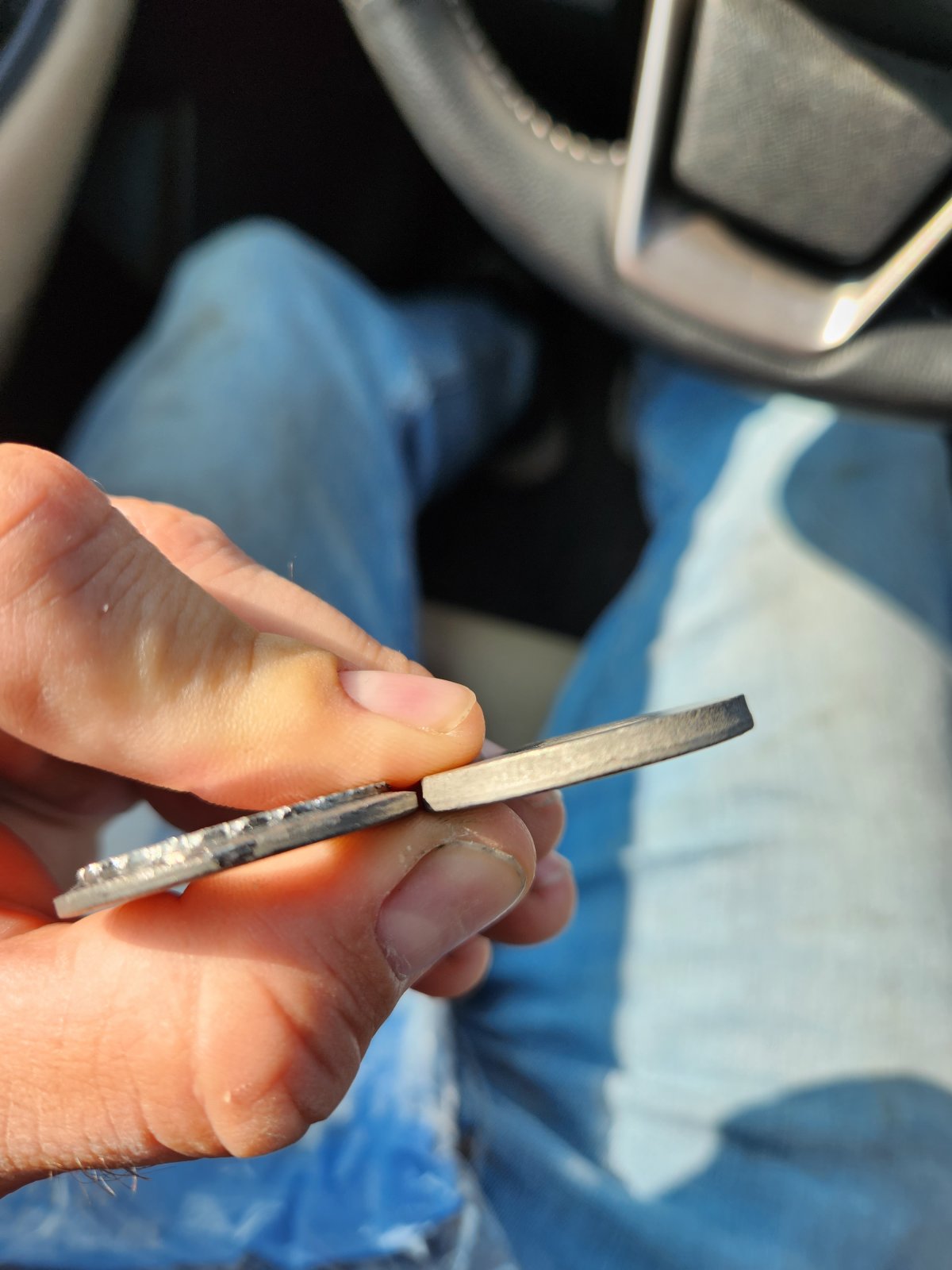

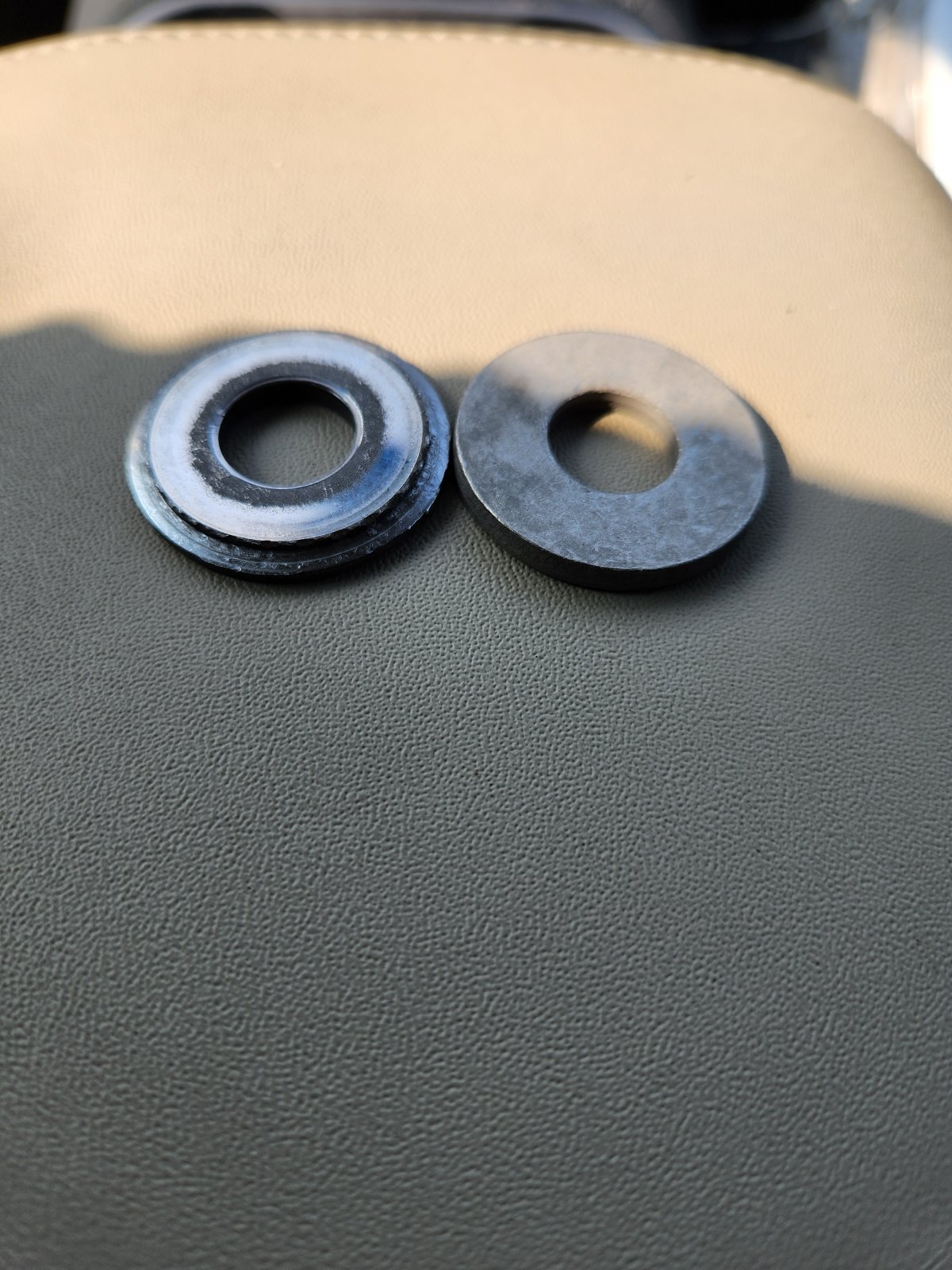

Not if the system is working properly, and if it was in 4hi you'd probably notice it "jumping" or jerking during hard turns or when the drivetrain binds on hard pavement. Called "crow-hopping." Perhaps a bad encoder motor could set it to 4hi but show the AUTO light on.
I had just the opposite happen to mine. We'd switch to 4hi, the 4hi mode light would light on the dash, but we could feel it slip in and out as if it were in AUTO. That was an issue with the encoder motor, verified by using a Tech 2 to show that 4hi was commanded but AUTO was actual.
Interesting, I guess I'm just trying to figure out why this shim was so worn down. Figure it be due to driving rwd on pavement. But maybe not :shrug:

Yeah, she was tore up.

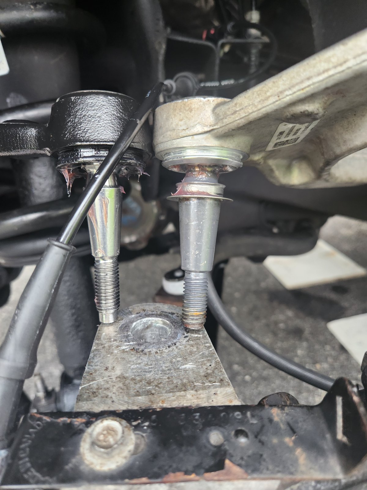

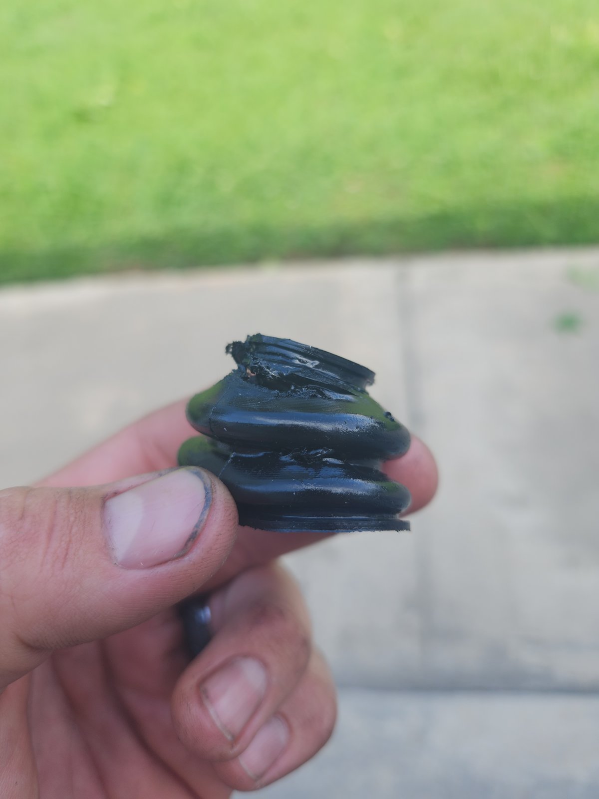

Either I bought the wrong control arms, or I am installing them wrong. Boot of new ball joint.
It's almost seems like they tighten too far down.
