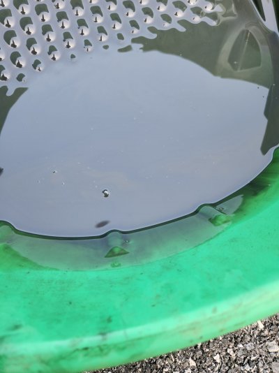

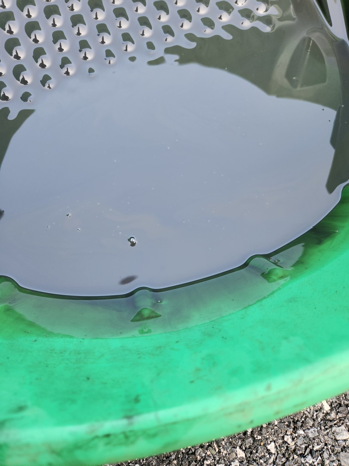

I also dont see any big or small pieces of metal in the old fluid either

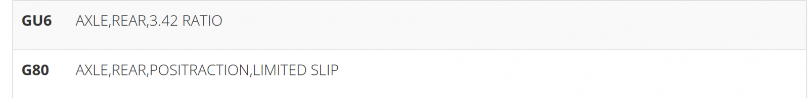

These are the two codes I see, but they say rear, would that be the code I am looking for? I didn't see any other codes pertaining to the axle or differential.

Yep. So you just need a new/reman front diff unit that has the same gear ratio and otherwise fits your vehicle.
