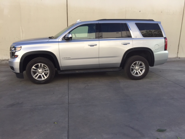

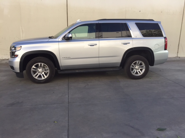

These are the pictures that EGR sent me. I have not ordered yet but will paint mine to color match the tahoe
Something looks off about them now, but I do think they'll look great once they're color matched.

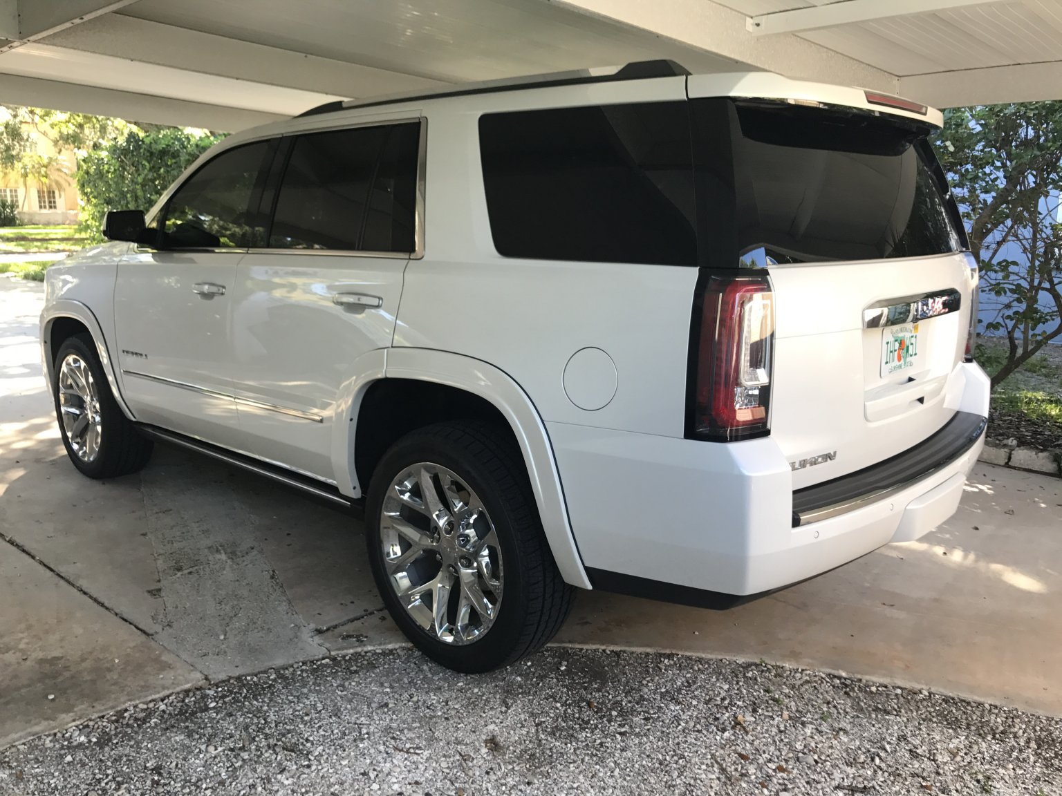

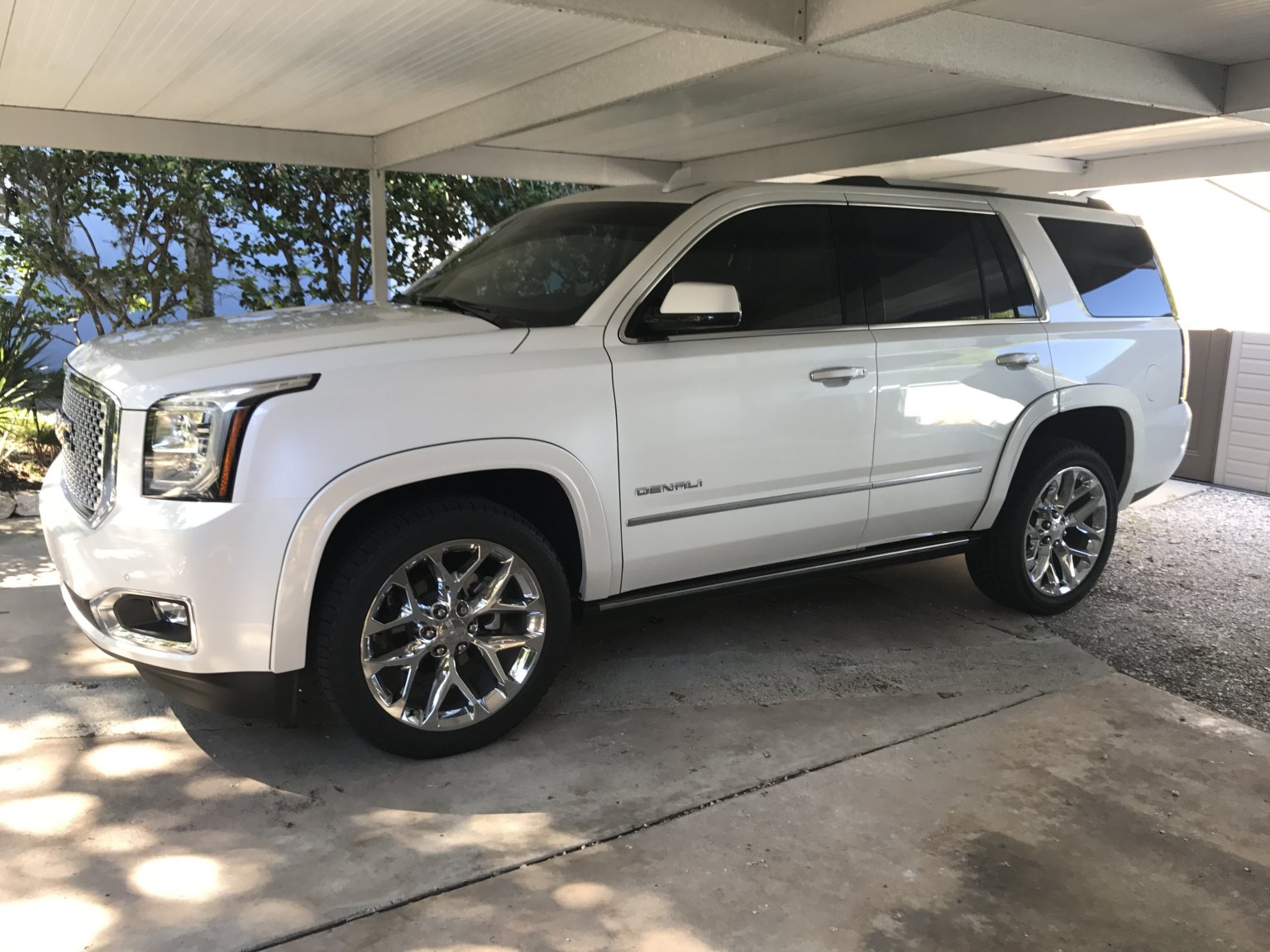

I'm an idiot and bought the EGR flares planning to put them on my Yukon XL. I even had them painted to color match. Then I went to put them on and realized how dumb I am, they're made for the Tahoe, which means that the rear flares are two pieces because the rear wheel well is split by the rear door. On my XL the rear wheel well is not split so it would've looked pretty dumb.
I'm incredibly lucky because my parents have a Yukon the same color as mine so they got free fender flares. Helped install them yesterday and they look great in my opinion.
The only hiccup during install was on the rearmost piece. The Tahoe has sheet metal that goes all the way down, while the Yukon (at least the Denali), has a black plastic trim piece that sits down lower than the sheet metal on the Tahoe does. I had to trim the bottom edge of the flare to get it to fit but that trimming was enough to make it fit flush and it looks fine.
I'll get some better pics out of the garage and post them up soon.

Yeah i would definitely like to see some profile pictures out side. They look pretty good so far. Nice work on your parent Yukon...
