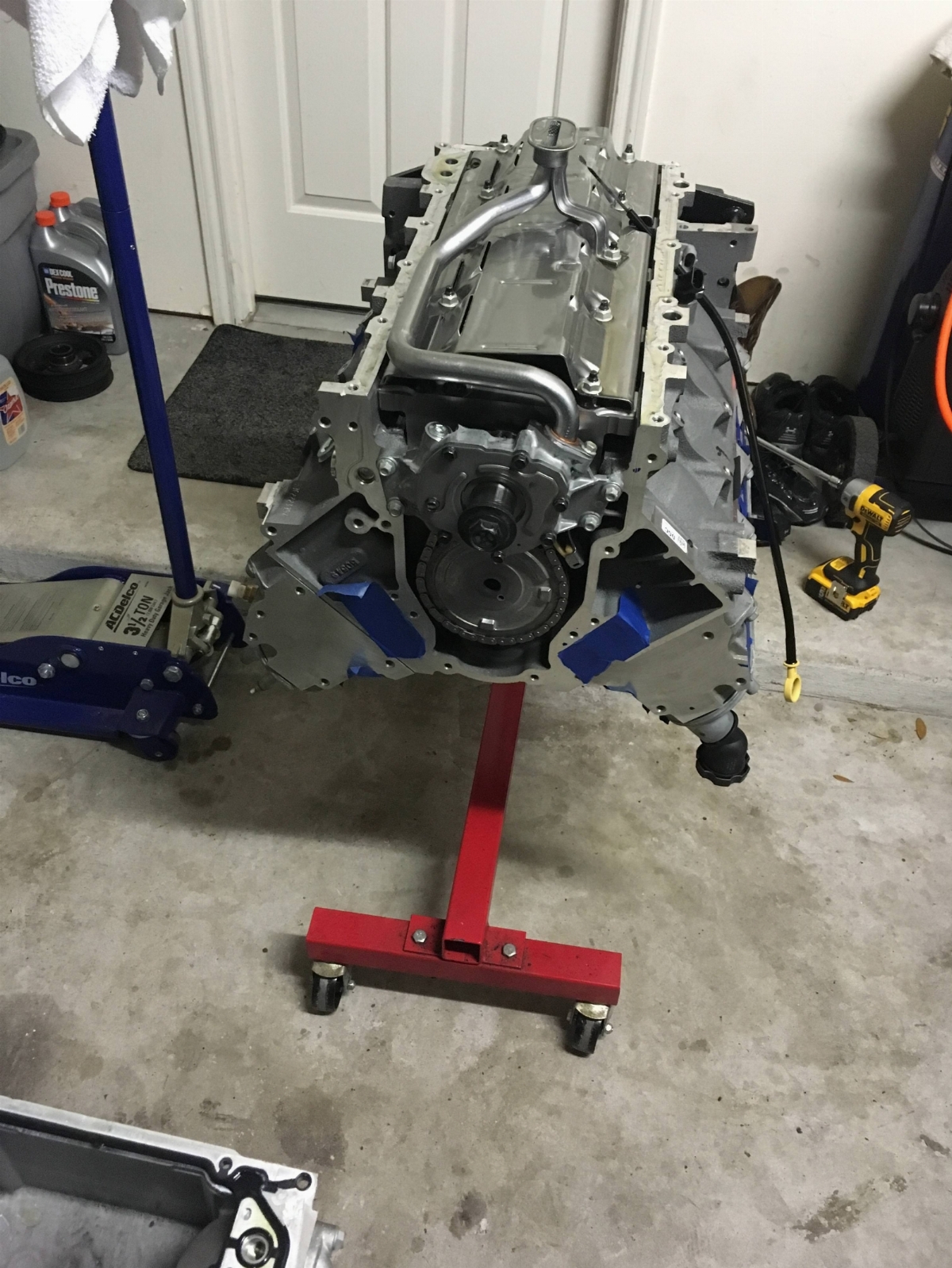

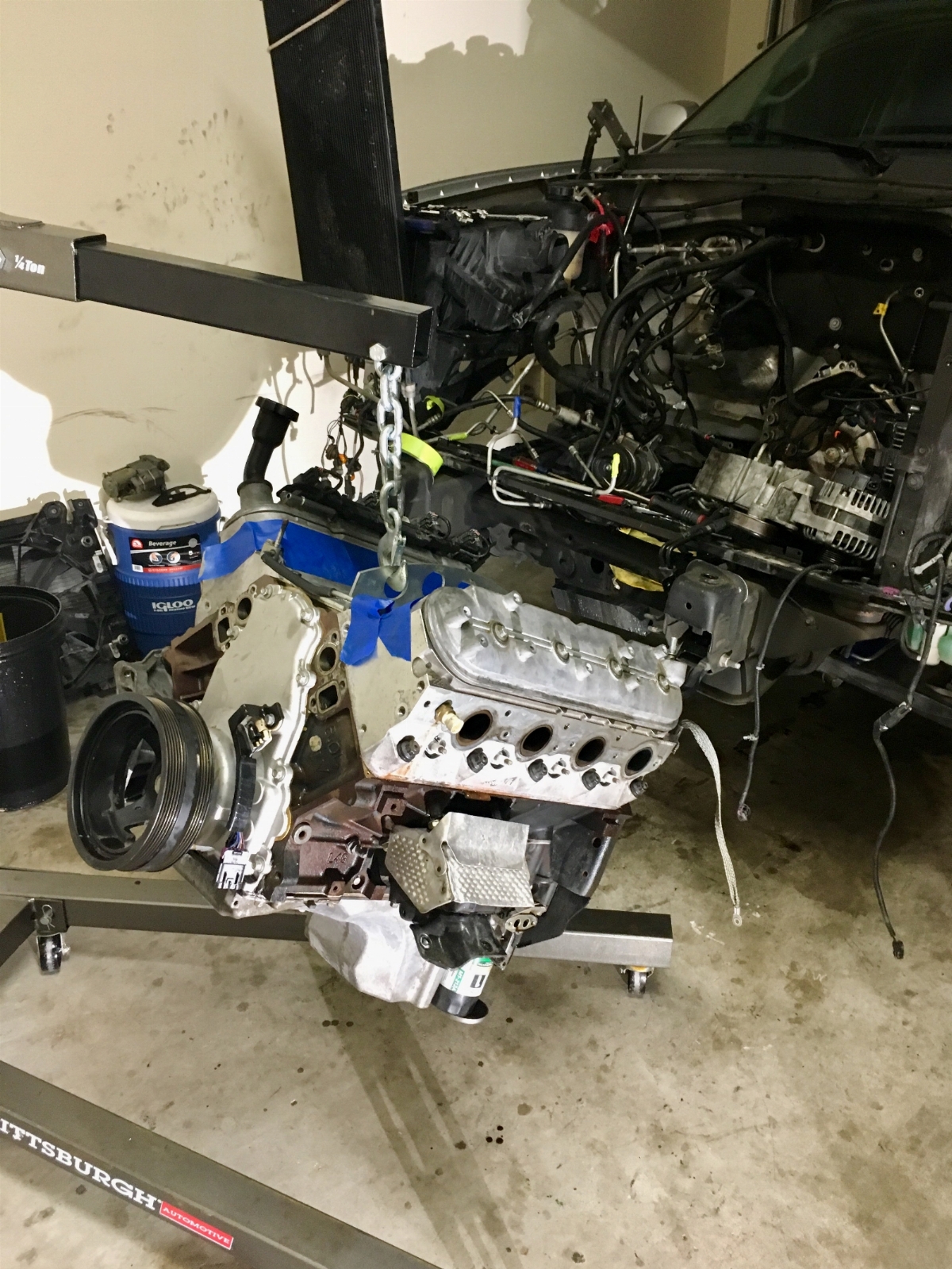

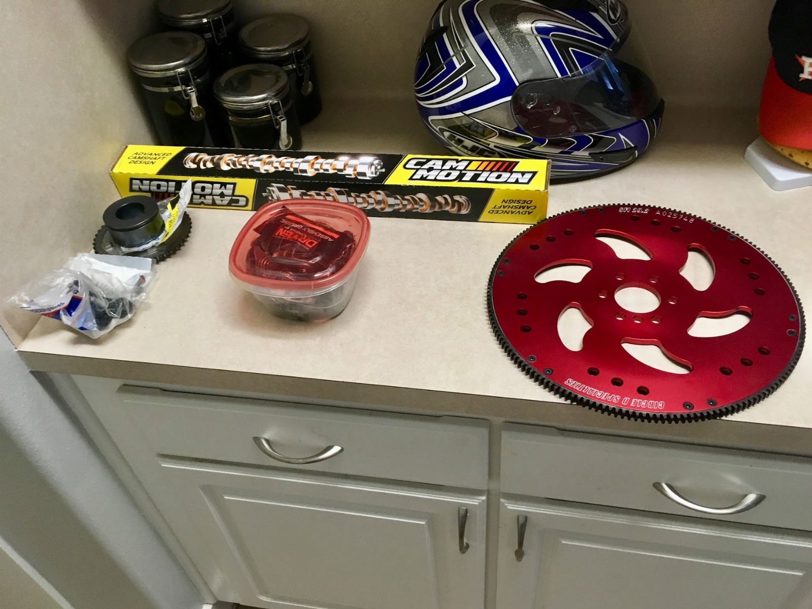

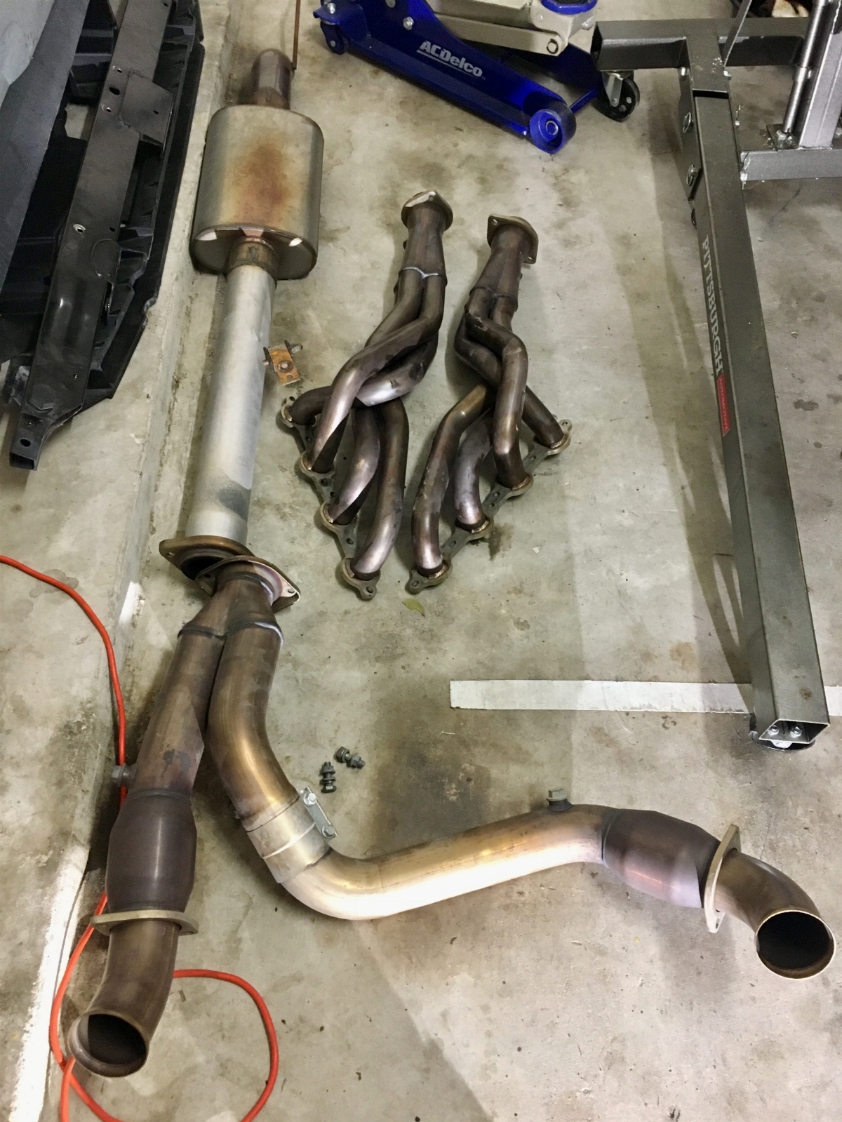

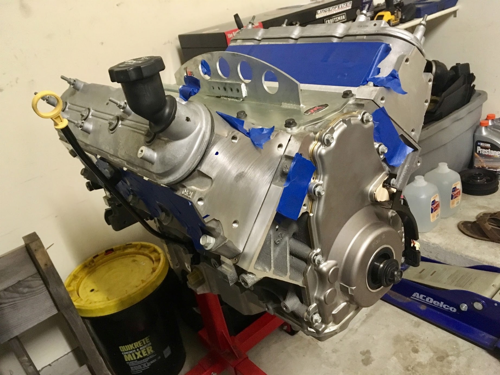

You swapping out the TSP cam for Cam Motion?

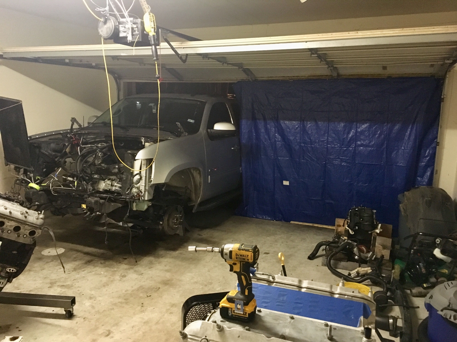

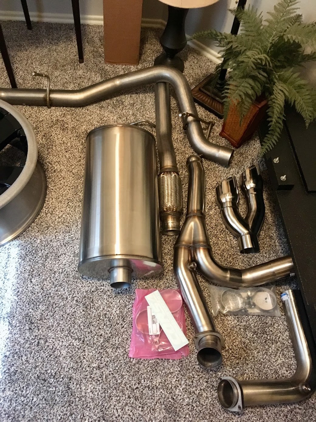

Check a couple posts back for pics of the new LS3...
But Im swapping out the whole set up....see below
Current Set Up:
Iron L96 6.0
Compression 9.7:1
BTR .660 Springs
Straub Trunion Upgrade
TSP 212/218 .600 .600 114LSA
TSP 7.4 Pushrods
ARH 1 3/4" LT w High Flow Y-pipe
into 3.5 Pypes Muffler dumped before the axle
Stock Flexplate
New Set Up (To-Be-Installed):
Aluminum LS3 6.2
Compression 10.7:1
LS3 Blue Springs
Cam Motion 206/216 .553 .553 117+4LSA
LS3 Pushrods
Kooks 1 3/4" LT w Off Road Y-pipe
into Corsa Catback
Circle D LS Billet Flexplate

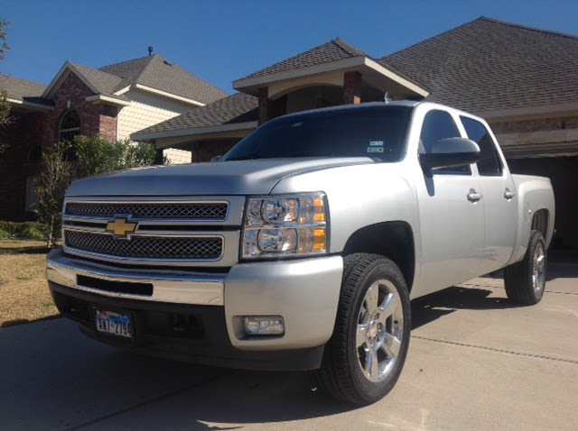

Yep, they're back. What made you switch from the 2011 CC to the Avalanche?
A couple reasons, one of the main ones was 2013 was the last year of the Avalanche so they were offering DEEP discounts that were hard to pass up (I was able to get in a new truck with a lower payment than my 2011), also I prefer the interior of the Avalanche (my 2011 had the Truck Dash not the LTZ Dash), the midgate is very useful, the Avalanche also has the Factory storage bins in the bed and a factory bed cover, coil spring suspension in the rear vs leafs meant a much more comfortable ride...thats pretty much it, both have been great trucks for me

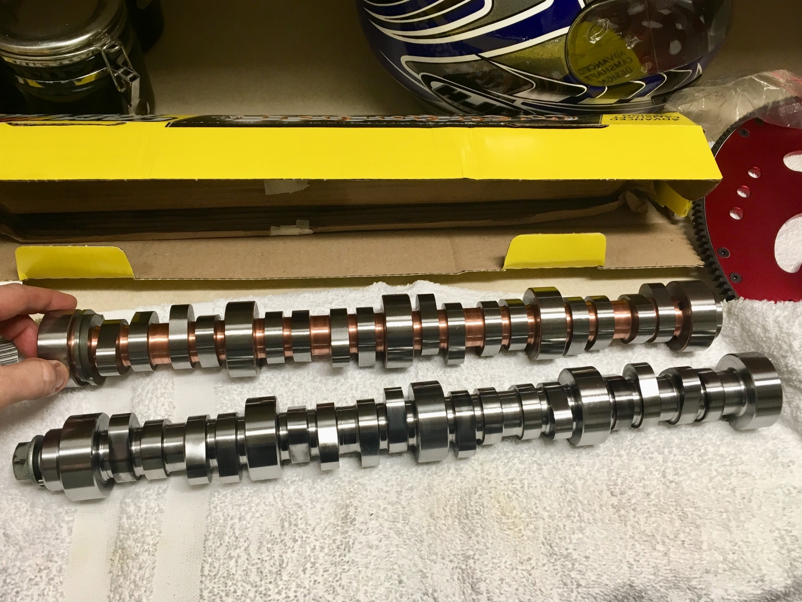

Looks great Chris. Couple of questions if you don't mind? Why are camshaft manufacturers offering cams made from different materials? I do not recollect this being offered when I used to build engines near 30 years ago. How long have you been racing and what are your thoughts on engine breathers versus catch cans? I'd never heard of the latter until last year.
I'd say you made a good choice then with the Avalanche, those reasons would have moved me to do it too but the power of the 6.2 is what I'm sure lead to this project!

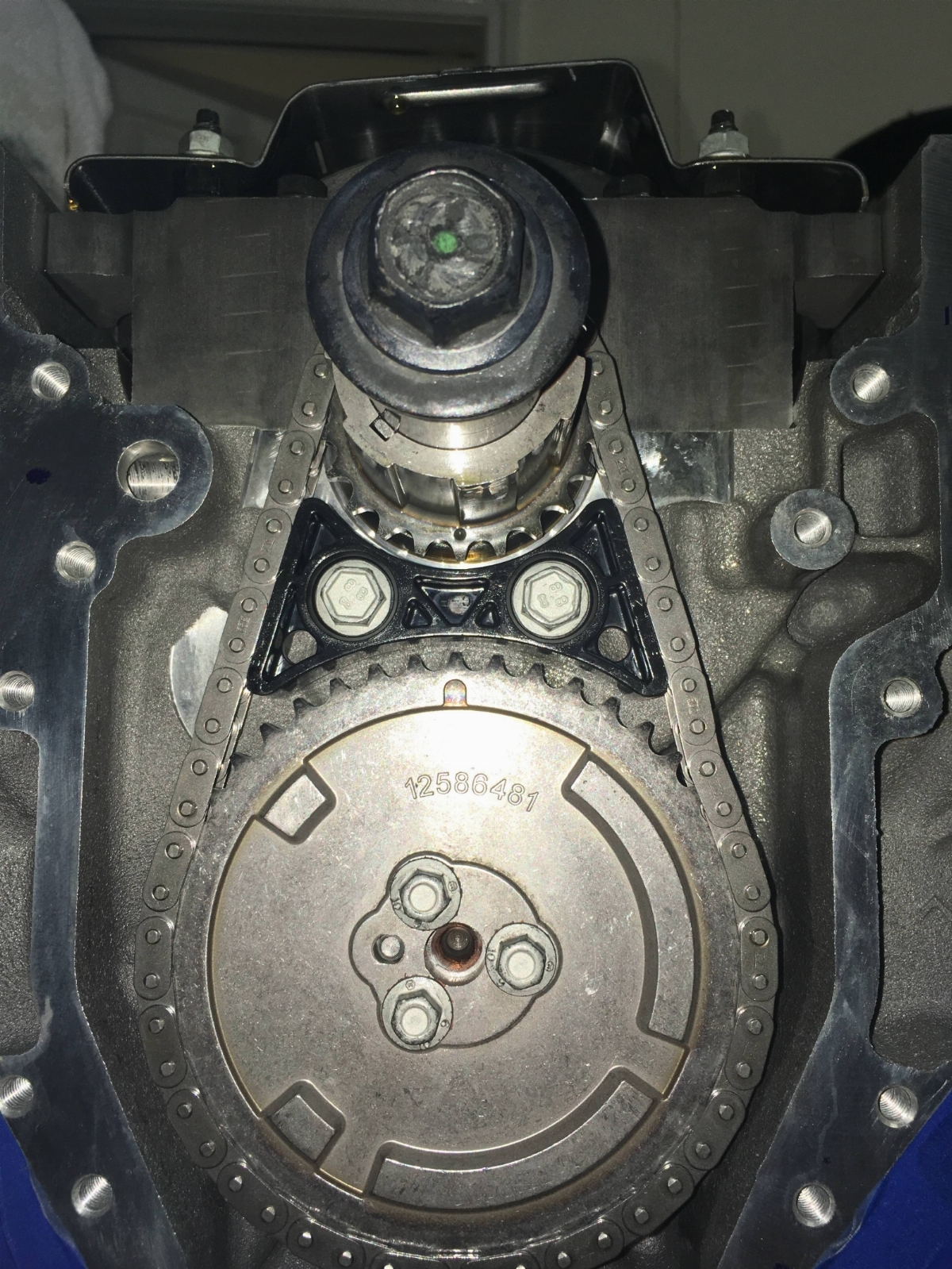

Working on cars/trucks has been a hobby of mine since growing up. Ive been tinkering for about 15 years....
As far as the cam material question....The only cam manufacturer that I know of that offers different materials is Cam Motion, I went with their 8620 Carburized Nickel-Chromium-Molybdenum Camshaft simply bc they told me it would be ground in house. If I went with a 5150 Core there was a possibility I could get a Comp Cam core. I was trying to avoid this as I have read of several people having an issue with Cam Whine (search YouTube) due to poorly polished lobes. I believe TSP and Cam Motion both CNC their cams in house.
On Catch Cans vs Breathers, I have always used Catch Cans on my set ups. A lot of people swear by Breathers but they both seem to be effective in preventing oil vapor from entering the intake. To me its just easier to empty a can every oil change than worry about changing or cleaning another filter...Ill be going with an Elite Engineering Catch Can for the LS3
