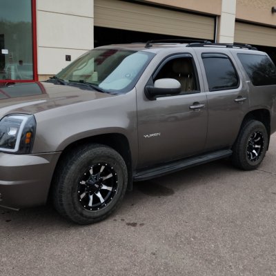

Welcome to the Forum from NH.
Pics of the truck, please.
You are already receiving clarifying questions and sage advice from the knowledgeable folks on this Forum.

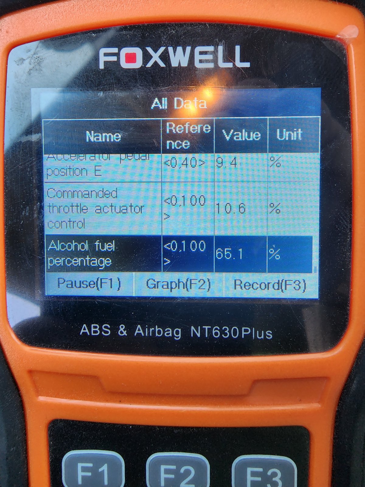

One other thing -- I think there may have been an update for the FF trucks due to it (the PCM) thinking that the ethanol content was high, causing it to add fuel. Find a scanner that can read the ethanol content -- as the PCM thinks it is -- to confirm that it's showing a correct value (10% or under, based on your fuel type in use statement).
Like the cam-crank correlation, it's something to check just to rule it out as a variable/cause.
Scanner shows 65.1% for alcohol fuel percentage.
BINGO!​
Get that reset right away, unless you're running E85! When you reset it, I believe that it also resets the LTFTs.
Not sure what part of the country you're in (?), but see the thread below for Tech 2 scanner owners; if there's one nearby, maybe get some help there.
