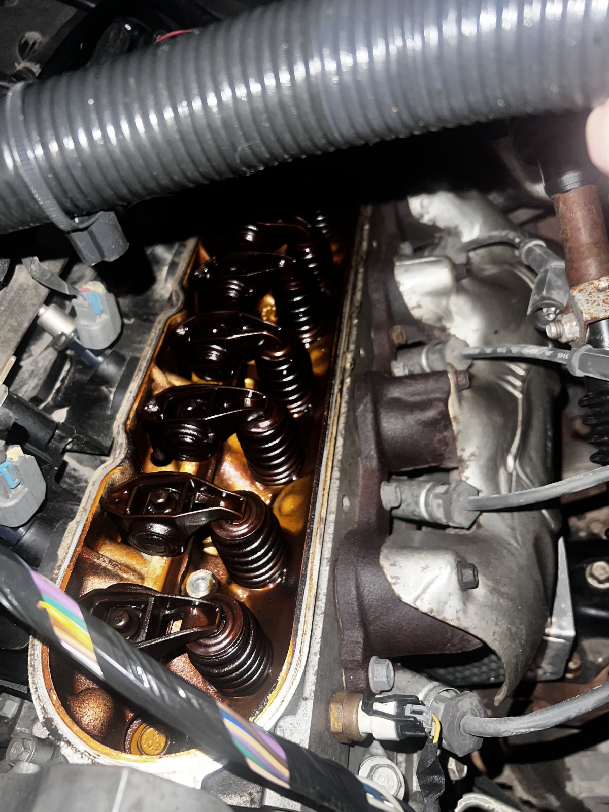

Took off the passenger side valve cover and did the same thing. Everything looks okay nothings loose and everything is moving as it should. I’m really not sure what to look for from here.

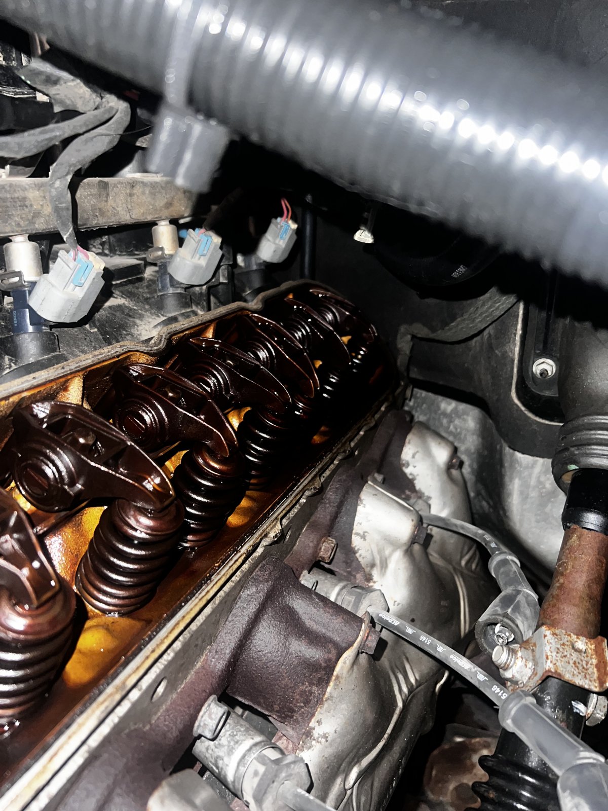

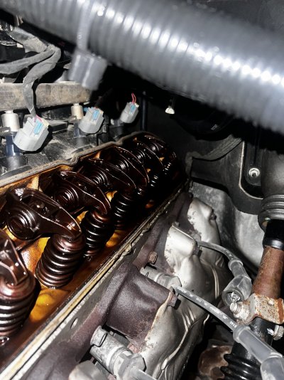

Did you happen to take any pics of how it looked under there? Curious of amount and/or type of buildup, if any. It could still be a collapsed lifter. Maybe not totally, but "weak". It might be solid enough that you can't feel anything or compress hard enough with your fingers but be too squishy when being thrown around by the cam lobe.
What oil do you use? I'd hate for us to send you down a rabbit hole. But, even considering how cam mics can color sounds, it really does sound mechanical. I'd say to invest the $8 in a mechanic's stethoscope and try to narrow it down to a particular area or cylinder.

I use 5w30 Mobil One synthetic with an ACDelco filter. Here are some pictures of the driver side. I didn’t stop to take pictures of the passenger but everything looked the same as far as color and buildup.
