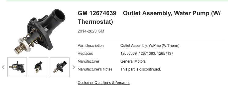

This seems to be of concern, the thermostat is discontinued. Im sure that is just that model for some reason, but still strange to see discontinued on a thermostat.
gm changes part numbers like women change clothes, superseded
Superseded Part Number
12674639 GM12671393 12666569 12650534 12671393 12650536
those may be old as well
best thing to do is call your local dealer parts department and give them the last 8 of your vin and they can tell you the current part number.
if they won't give it to you, then hang up and call ANY other gm dealer parts department, some are dicks
27,743
42,165
after a little searching it appears that is the correct part number, but I don't think it is discontinued there just isn't any in stock OR they are in the process of changing part numbers
there appear to be some around online....
ac delco list's the same part number
and autonation list's the same part number and autonation is a HUGE gm parts dealer
this part is good for 2015-2020 6.2l gm isn't going to stop making parts for vehicles that are still under warranty, so somethings up
