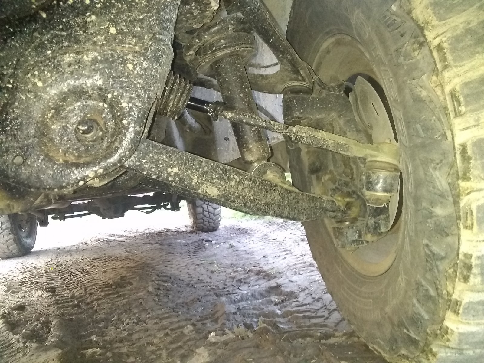

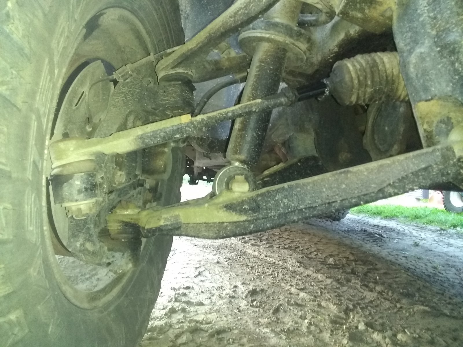

Is it the knuckle or control arm 3.5? I have the 3.5 knuckle lift for 07-14 gm trucks from rough country in the front of mine
@87carl Can I see pictures of the front suspension? I'm curious of how the knuckle looks and the suspension angles.
I haven't had time to put cv axles back in I pulled them and differential out when I was doing timing chain so I could get oil pan out. I was waiting till I changed alignment cams to put them back in. This is with it slightly turned toward passenger side
