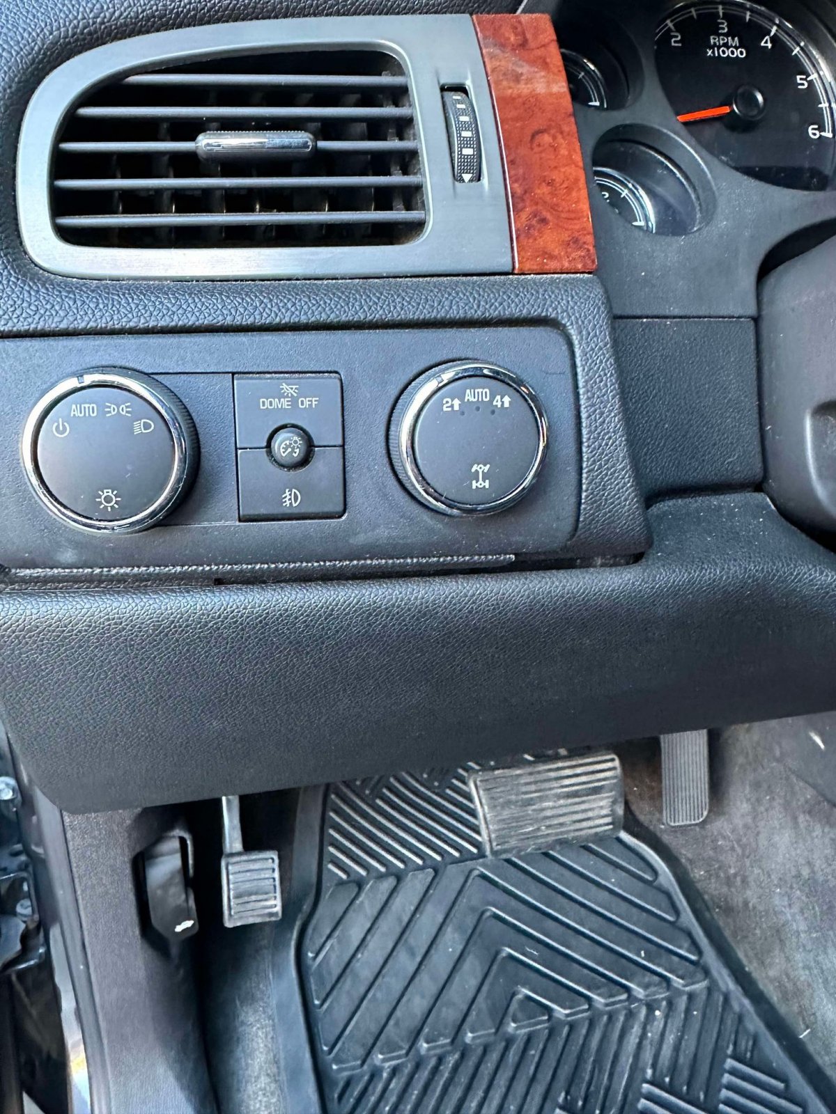

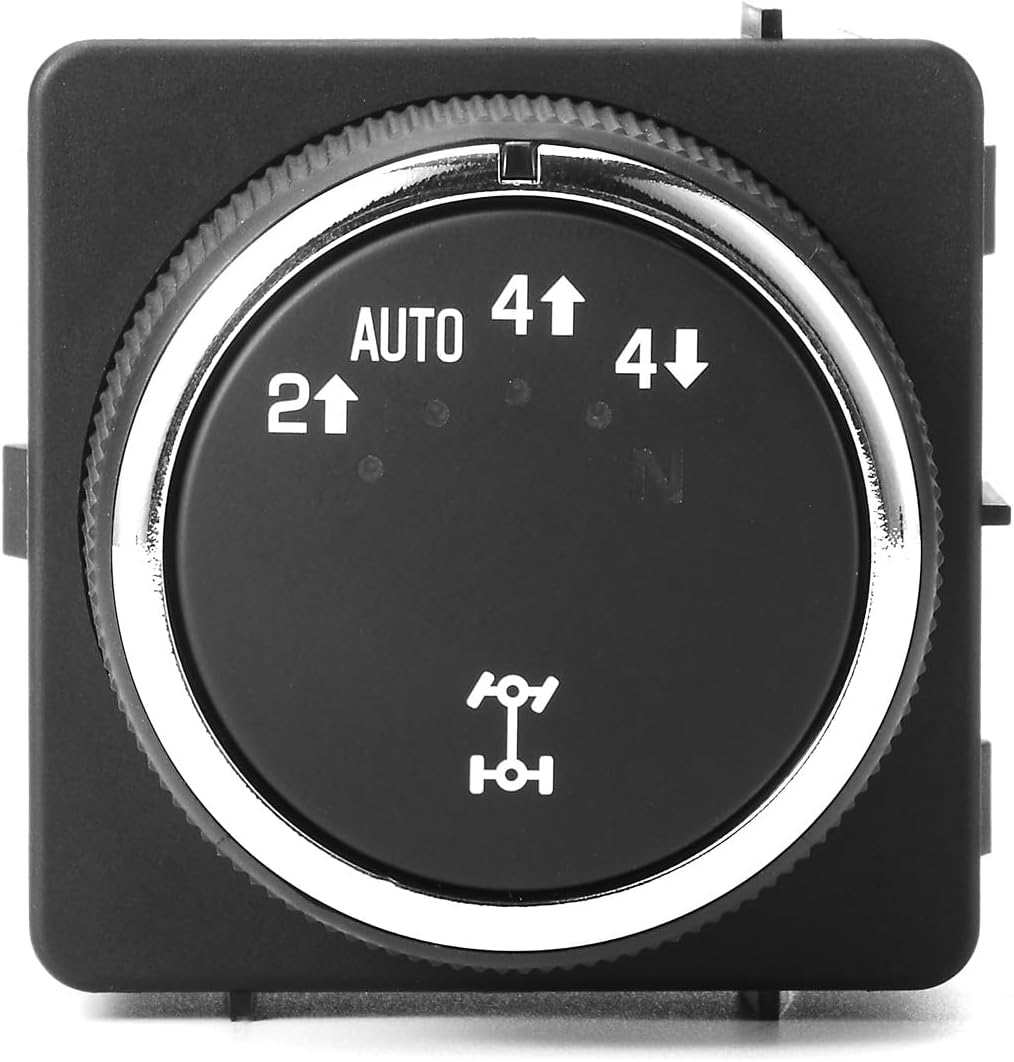

Currently interested in buying a 2010 Suburban but questioning the 4 WD set up in this one. See posted pic, this is what the dash looks like showing 2 hi - auto - and 4 hi. I've seen others with a selector knob showing 2hi - auto- 4hi and 4 lo.
Whats the difference? I know in the pic there is no 4 low selection, that's apparent - but when it's in 4hi mode is it TRUE 4 WD? Or some type of limited slip/AWD set up which IMO is not a better set up for ice and snow. I've googled the heck out of this topic and come up empty. I live up in the CO Rockies where I need a solid 4x4 system and don't want any rinky d ink AWD/hybrid set ups that don't fully engage all 4 and/or work on a limited slip some basis of sorts. I am almost assuming that this vehicle has possibly some rinky-din k 4x4...or maybe I'm totally wrong and that when its in 4hi the front and rear is always engaged. And the only difference is that it has no 4 low. Any help is super-appreciated.

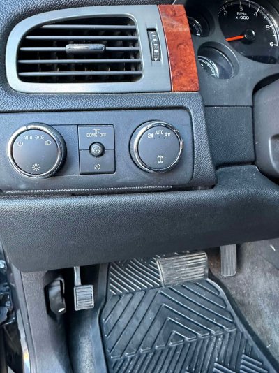

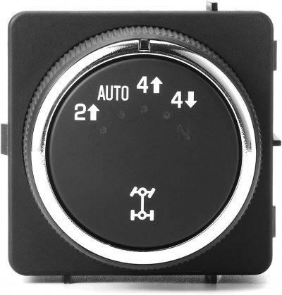

In viewing other surburbans/yukons for sale I've seen this type of selector knob for the 4x4. This is why I'm stumped. It's def' got to be a different 4x4 set up.

That simply a single speed transfer case. It is true 4WD. You just don’t get the 4 LO option.
Oh wow that's a relief as I really like the rig. Are you 100% sure? :) just checking...my apologies.
30,478
47,818
One is a single speed transfer case
One is a 2-speed transfer case
Auto- is 4wheel drive on demand when wheels slip is detected
Only the Yukon Denali/escalades generally have AWD
In all cases the front is a open diff
Most have the G80 rear end which is a automatic locker at speed, I believe around 15mph is when it locks if a wheel slips
Ok, that helps and that's where I was getting confused....seeing Denali's, Escalades with AWD lisitngs. Plus I never knew there was a single speed t case that had no 4 low. I'm a 66 year old geezer and would be happy with a 4x4 manual shift lever and 2 hi, 4 low and high and a neutral.

It's in neutral when shifted to neutral, are you asking about this for when it would be towed? I believe that requires the driveshaft to be disconnected

The 2 speed transfer cases can be shifted into neutral to totally disengage everything. I don't think the single speed ones can.

The singles speed transfer case, MP3010, was generally paired with 3.08 gears. 2010 was the first year of introduction of this transfer case and gear combination.
The 3.42 geared trucks were usually paired with the MP3023, 2-speed transfer case.

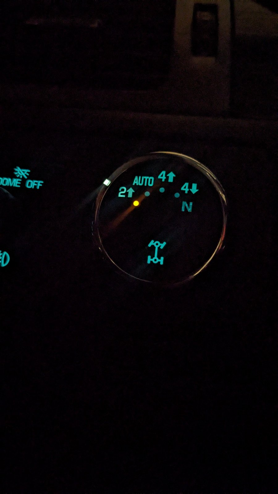

so looking at my sector. according to the owners manual. my t case will go into neutral for being towed behind a trailer. so it's definitely more of a old school 4x4 t case the op might be looking for. if you look you can see where the N would light up when in neutral.
I don't know what trucks they would have put this in thou. it might be a one off thing.
No, that's the 2 speed one which is more common then the single speed 4hi only.

*MP3010 Single speed *MP3023 Dual speed
*BW4485 AWD
Not sure what models the two different 4WD xfer cases are specific to but the AWD were the only option on 07 & 08 Esky & Denali.
9-14 Esky & Denali were AWD only with a few (uncommon) available with a 2WD option.
GM only did z95 Magneride on 09-14 Esky. 07 & 08 Esky were z55 autoride. All 07-14 Denali were z55 autoride.

Thanks all. My concerns were not so much about having the 4 low - as most people mentioned its rarely needed. But I was concerned that the 4 Hi was a REAL 4 hi and not some kind of AWD set up...like in the Escalades and Denalis.
