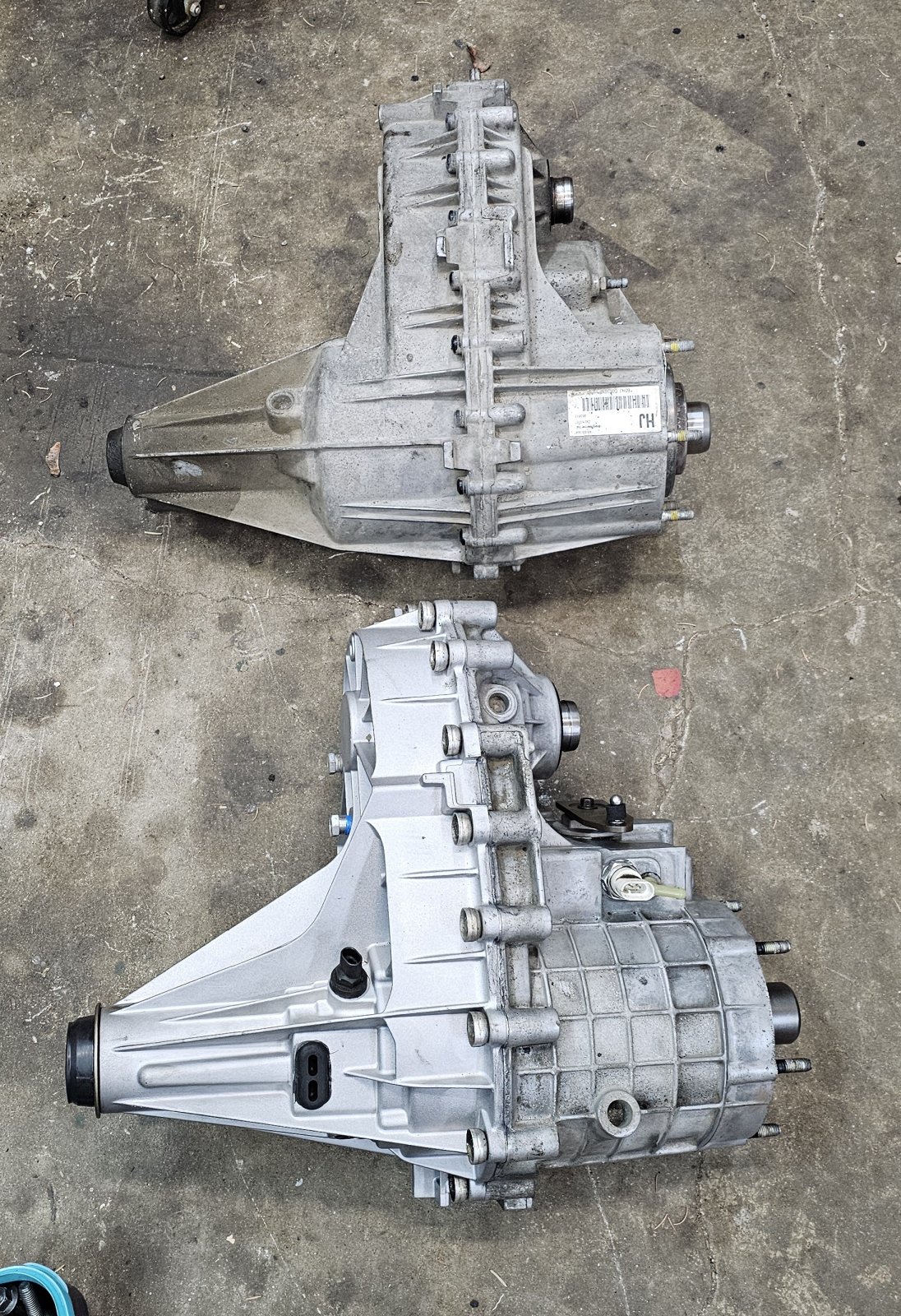

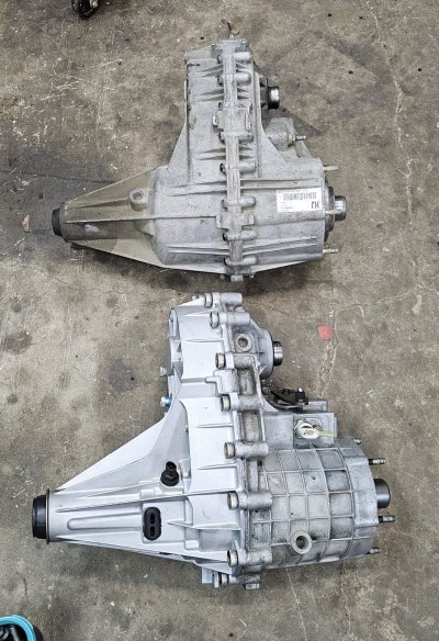

The TC has to be a NP261HD and it has to come from behind a 4L80E as it has 32 spline output shaft and is the same bolt pattern, shaft depth as the AWD TC. LD (27 spline) XHD (29 spline) will not work so count the splines to be sure.
Not all HD TC's will be stamped HD.
Use your original drive lines.
I pretty much rebuilt my 261 with new bearings, forks, chain, range gear, aluminum rear case half, seals and case saver

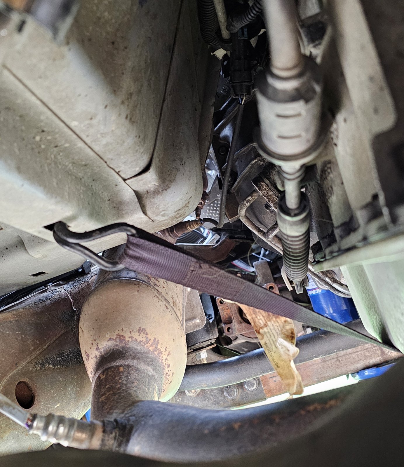

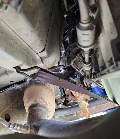

To support the transmission for cross member removal GM provided a place on each side of the transmission you can hook a ratchet strap to.

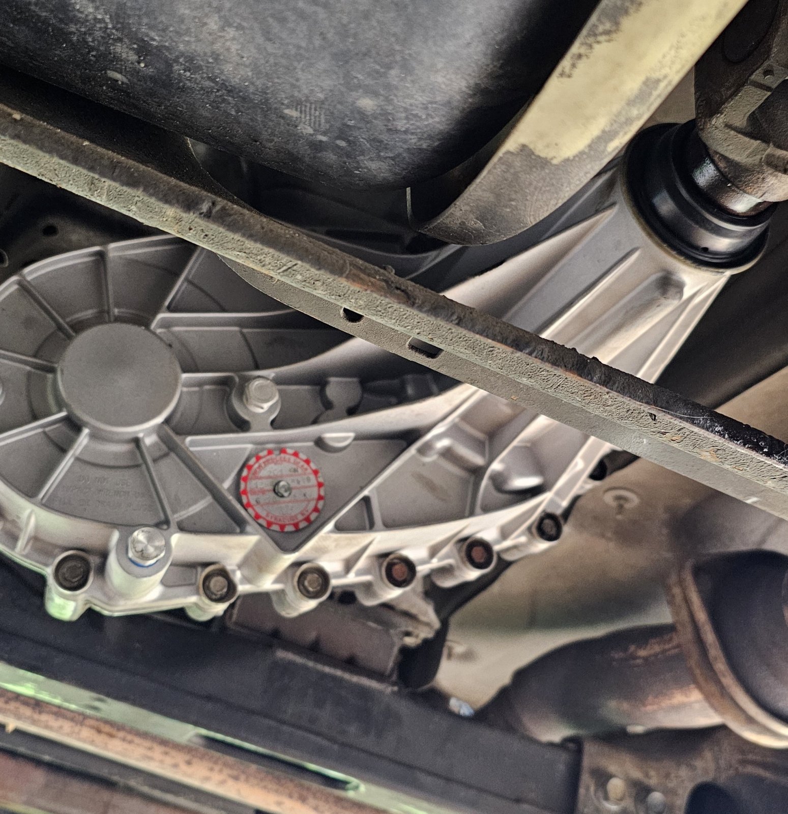

Swapping them is easy. I swapped mine in 3 hours by my self.
It's not that heavy so just get under it somehow and bench press it into place.

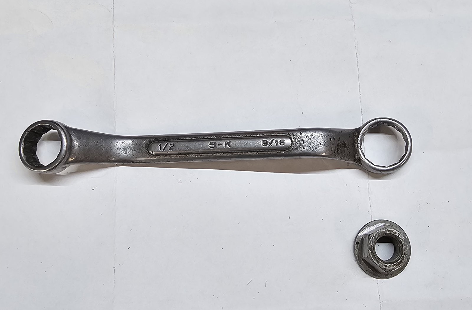

1 challenging thing is the nut at the very top of the TC adaptor. There is not enough room to get a ratchet or full size wrench on it.
I got lucky and had a small old worn out 9/16 wrench that would fit good enough to get the nut off and on.
At this point i can drive in 2WD

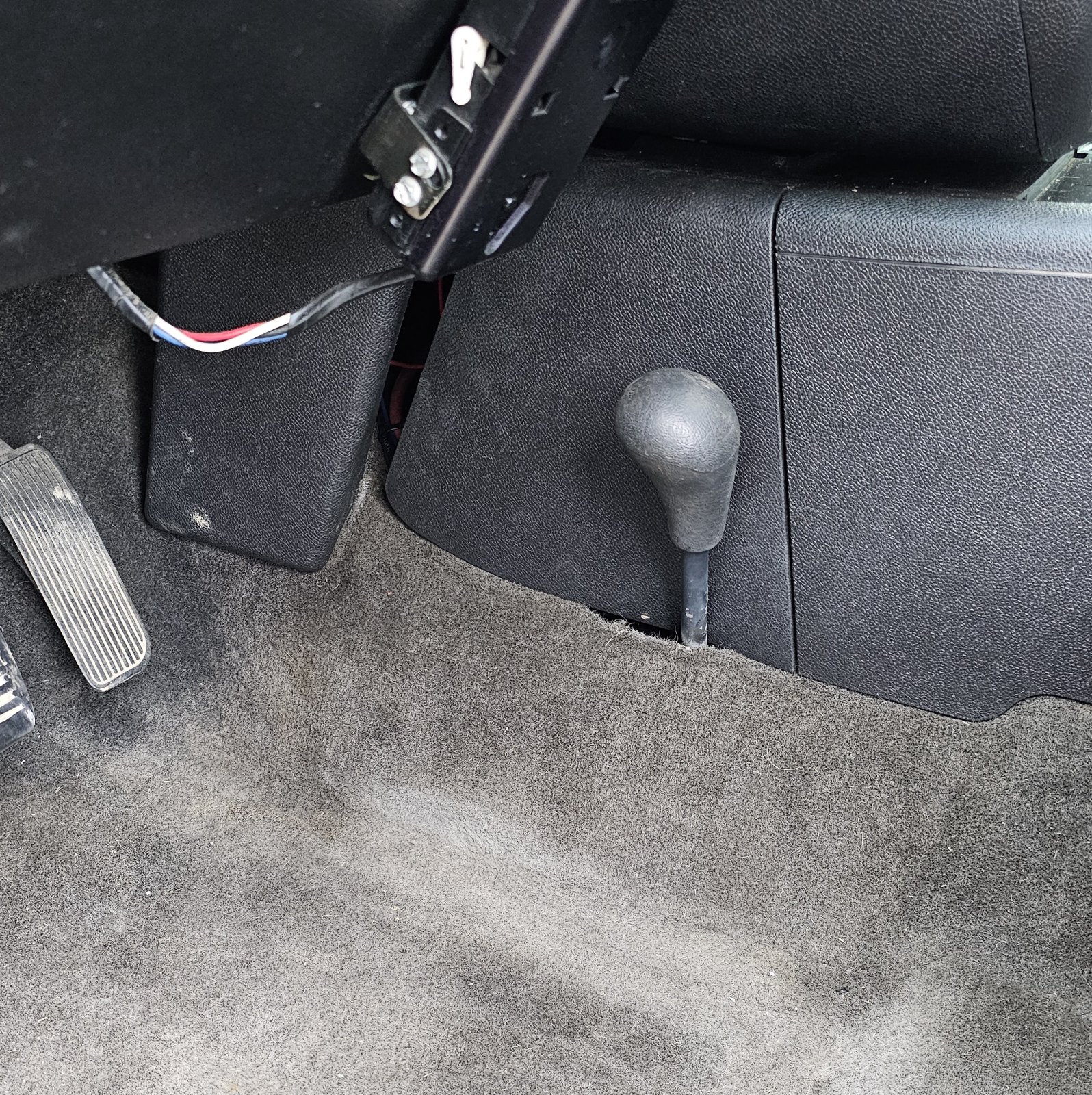

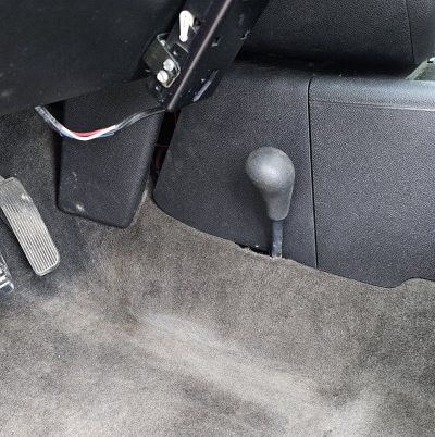

i dont know if the electronically shifted 261 lets you select a neutral position on the case, its there but only because TC wants separation before going from 4hi to 4lo iirc. a manually shifted (stick on the floor) 261 you can put it in neutral - theres currently a manually shifted 261 in my yukon. i used the factory sandwich plates to bring stick thru the floor and bent the lever to come out just below the console
Could you post a few pics of the shifter installed?
I'll be installing that today and knowing the location would help a lot!
Thanks
randeez
Sep 29, 2017
8,173
25,875
south florida
when i get home i can, not much to see cause of carpet and console covers everything up. with the factory sandwich plates its obvious where it goes, theyre contoured to the floor pan/trans tunnel (for the most part), so just need to line it up mark where to cut for the shaft to come thru and has indentations for the bolt holes to be drilled out in the floor pan also

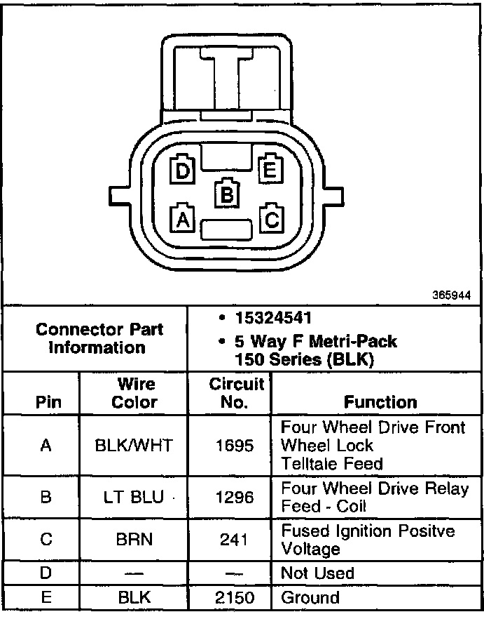

To wire it all together so is all works as it should.
On the front actuator:
Wire B: is a ground and would go to an indicator light for 4 low and 4 high. The light would have 12V with key on.
Wire E: Ground
Wire C: Switched 12V Positive
Wire A to transfer case wire C.

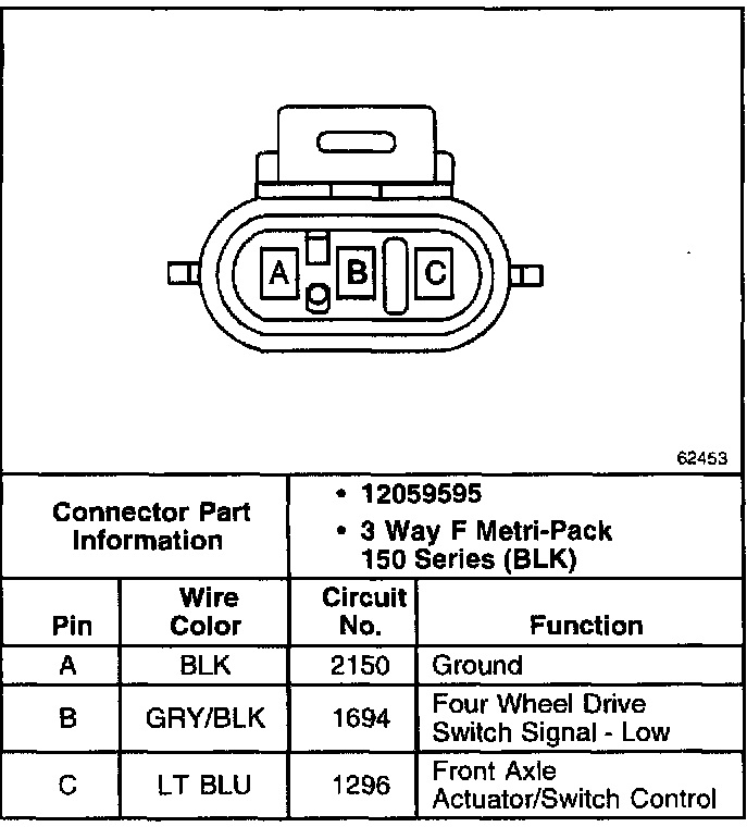

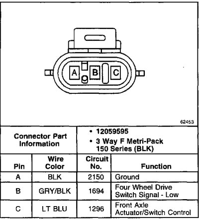

Transfer case range plug.
Wire A: Ground
Wire C: to wire C from the actuator.

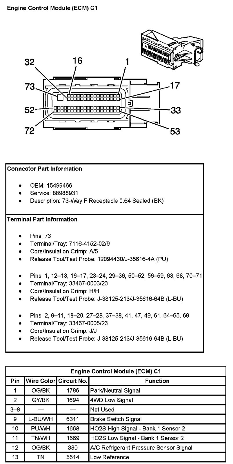

Wire B: goes to the ECU. Plug C1, Pin 2. It is a gray/black wire you might already have it.
Test all connections with key on engine off trans in neutral. You should hear the actuator move going in and out of 4 low and 4 high.

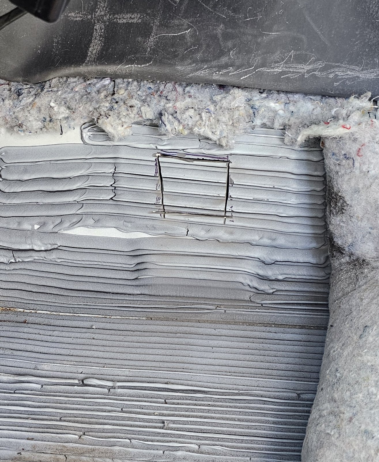

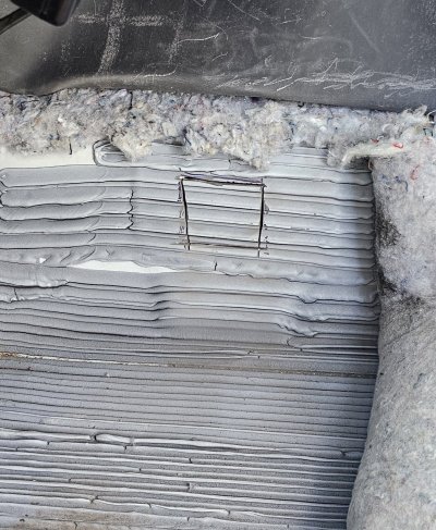

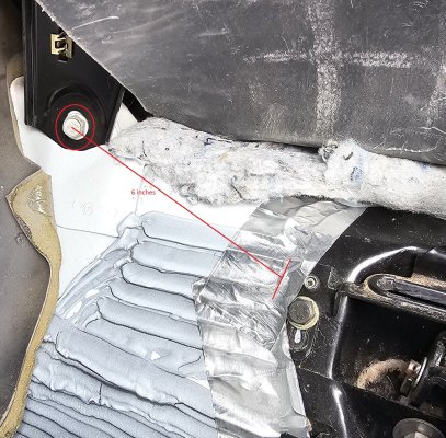

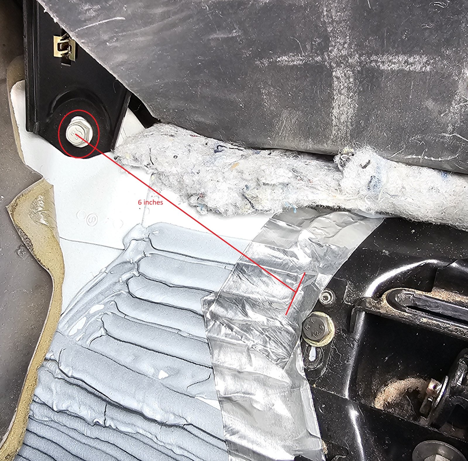

For the shifter i had no idea where to start and make the hole. My guess was about an inch to far back so i had to make the hole a little to big so i could get the linkage to line up.
I also did not use the plate that goes on the outside as i did not get it or lost it. My shifter is mounted solid with 3 bolts/nuts and thick fender washers on the outside.
The edge of the shifter ended up being 6 inches from the circled in red bolt.
After bending the shifter out a little bit it ended up being in the perfect spot. Easy to shift and not even close to touching my leg.

Tried hooking up pin 2 on the ecu to the transfer case today and it seems to do nothing when grounded.
I'm not sure at all if the ecu switches to 4x4 mode and i do not know how to tell.
The ecu has X, Y, Z mode and right now all modes are set to X. All modes are also set to the same settings.
Plan is to read my Avalanche with HP Tuners and see if 4WD mode is set different and if it is copy that mode from the avalanche to my ecu and try it again.
