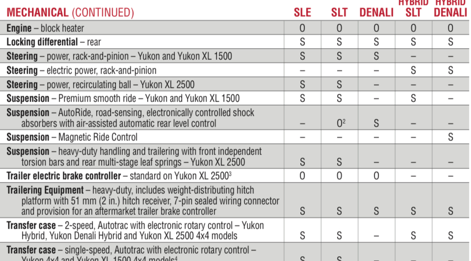

Don't just buy any 4x4 you see, make sure it has the 2-speed transfer case (NQH) and 3.42 gears (GU6). We also like the heavy duty cooling system (K5L) with the 700 watt cooling fans, external transmission oil cooler (KNP) and engine oil cooler (KC4).
2009 was the first year of the 6L80 transmission.
2010 introduced the single speed transfer case, MP3010 (NP0) and 3.08 gears (GU4). Great for snow and highway cruising. 2010 also introduced VVT for 5.3 engine.
By early 2011 all the AFM enhancements had been introduced making the system very reliable. It's not a big deal to delete it.
In 2010 there were a handful of Yukon XL SLTs with the L9H 6.2 engine. They did not have AFM. They can be found as RWD and 4x4s. They pop up from time to time for sale.
