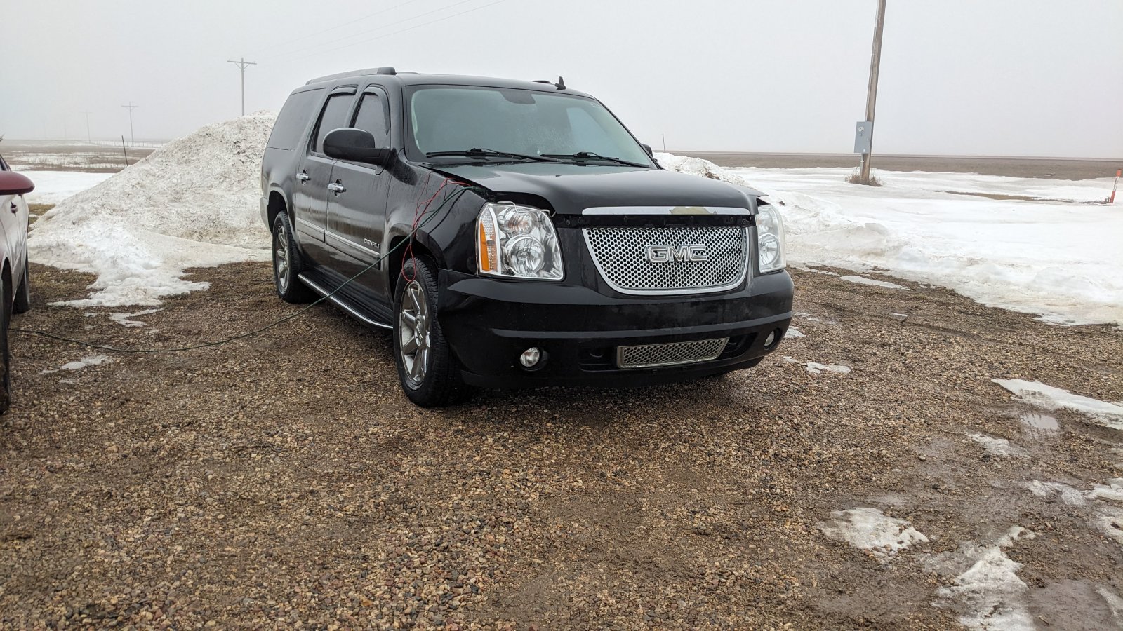

Here's a couple pictures! Black interior as well. Few minor things to take care of too with time. Also have a 2013 SLT (Yukon), but not an XL. We have found with 4 kids, really wanted the extra room, love the style of these rigs, and the 2013 has been VERY good to us!
Thank you for the Welcome!

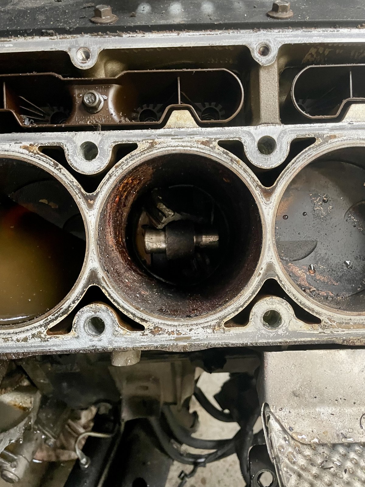

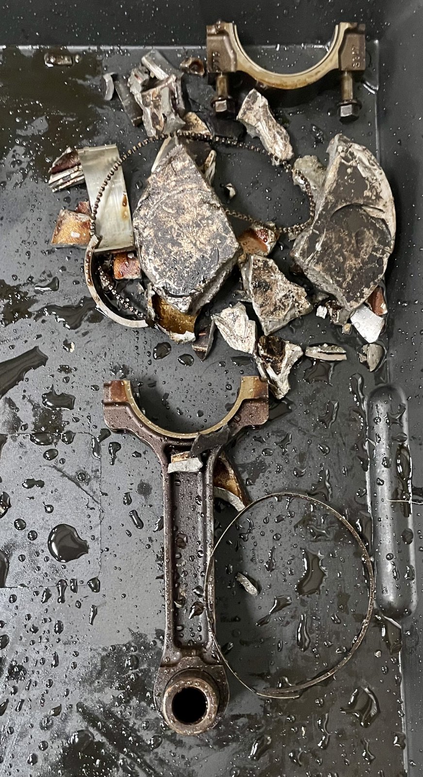

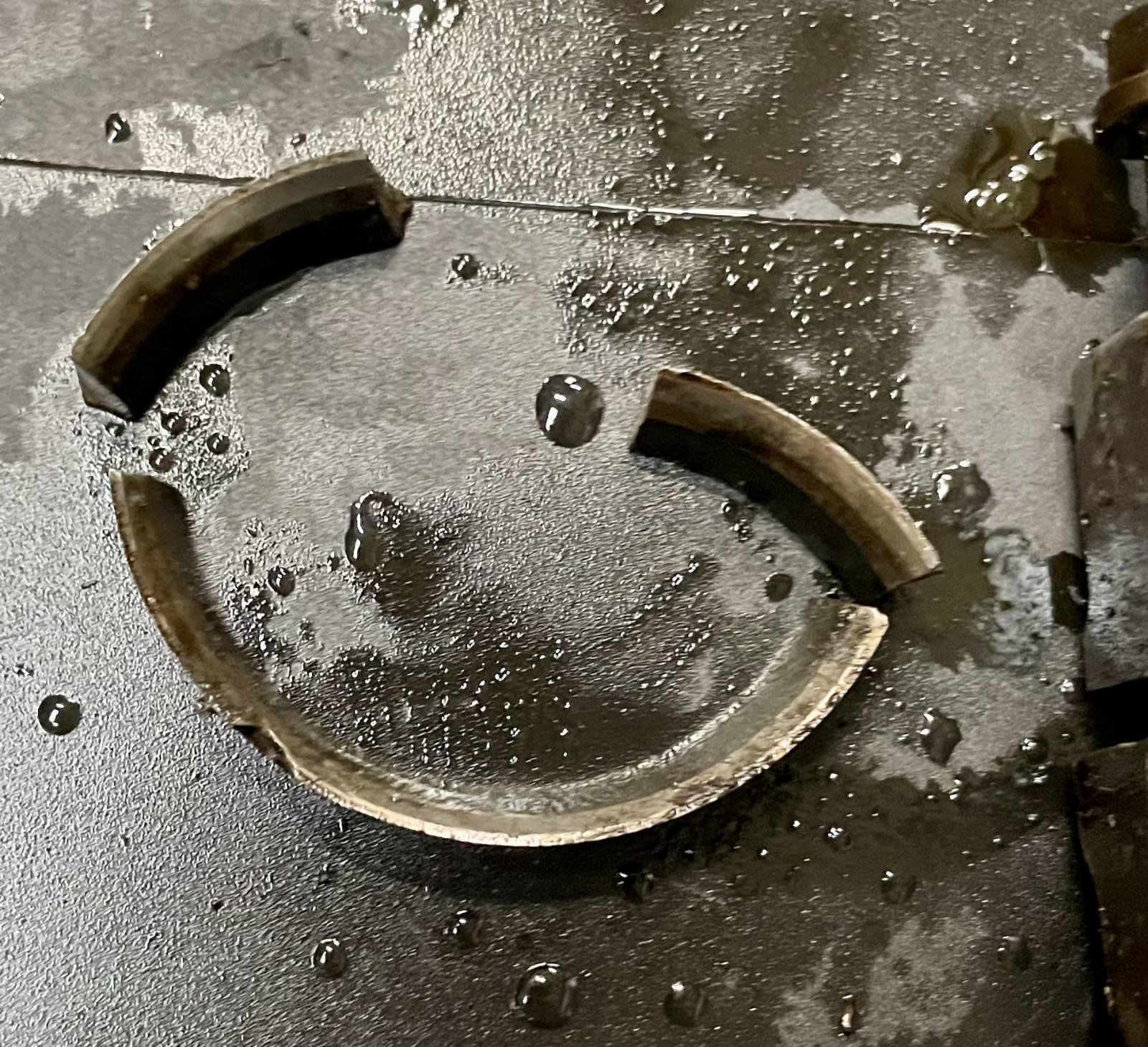

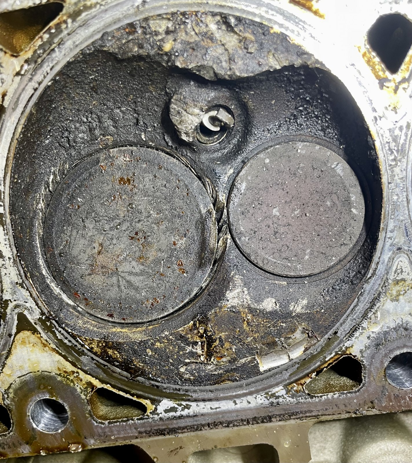

I picked up a 2009 Denali In similar condition scenario. Pulled oil plug and coolant came out with the oil. Couldn’t turn motor over with breaker bar on crankshaft pulley. Had to pull engine with transmission together. Pulled the heads and here is what I found, looks like the piston exploded. Taking block to machine shop to assess, but think it can be rebuilt. **Update-looks like a valve seat came loose and caused the piston to implode.***
That looks rough! I haven't drained the oil but the oil is at the "full" mark with no signs of water. I'm pretty curious what I have going on though...if I do have to pull the motor, I would probably rebuild at some point and swap it into something.

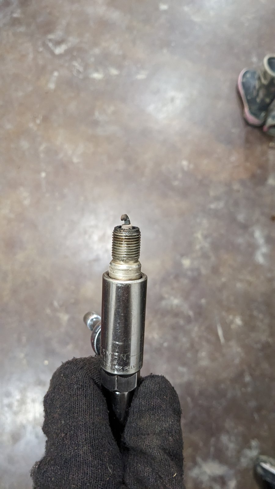

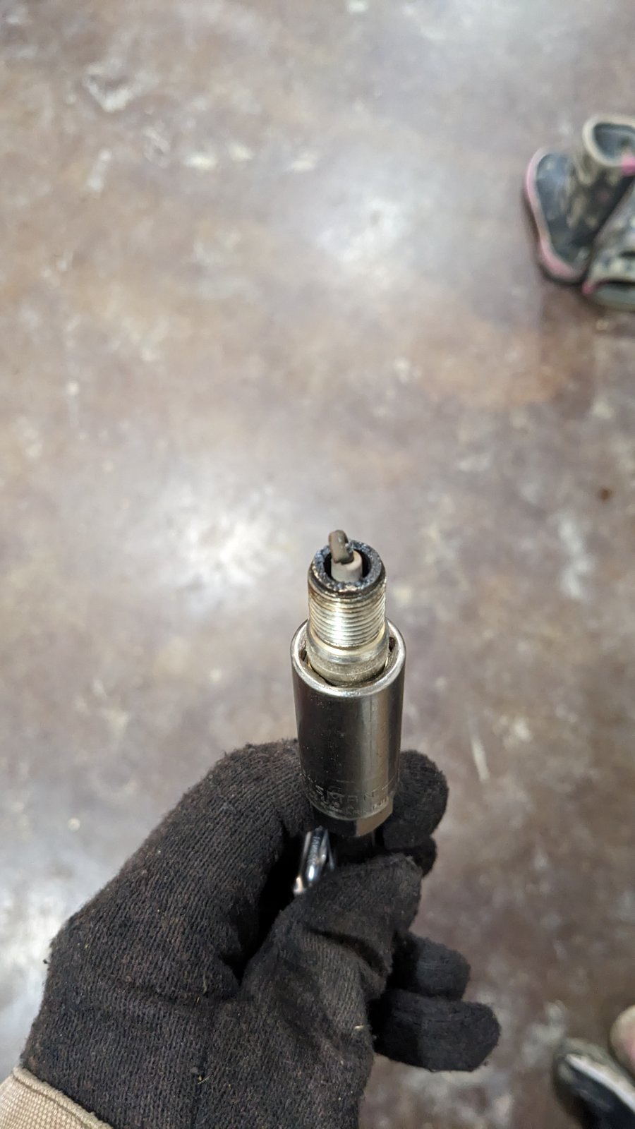

Well, pulled spark plugs last night, thinking it dropped a valve...

Another update for everyone interested. Pulled valve cover and nothing looked odd, loosened rockers on that cylinder and nothing seemed odd there. Threw my leakdown tester on that cylinder and I'm getting air out the intake only, so fingers crossed piston is intact and it's a head/valve issue yet...and the piston didn't get the piss beat out of it!
Next couple weeks I'll get the coolant drained and start tearing apart and pull the head!
