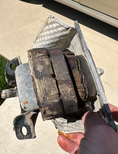

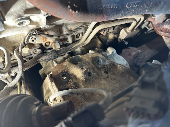

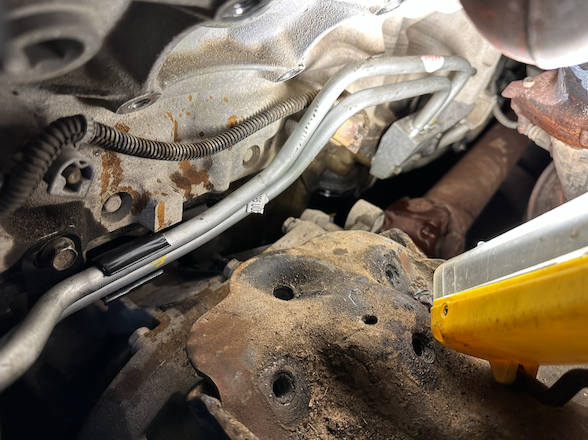

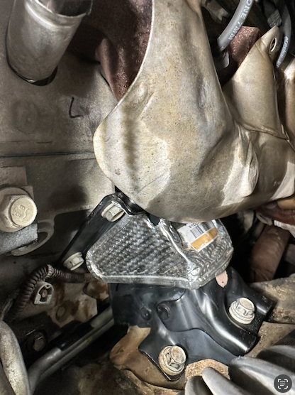

Sounds like you've confirmed a bad mount with your tests. Not a fun job, but not terrible either.
I pulled the drivers side front wheel and fender liner, and also had to separate the steering shaft and the exhaust manifold heat shield to get enough clearance to work. While I was in there I also replaced the oil cooler lines. You might do the same if yours is so equipped.
Bad mount that came out:
What it looks like with everything out of the way:
New oil cooler lines installed:
New Hummer mount installed:

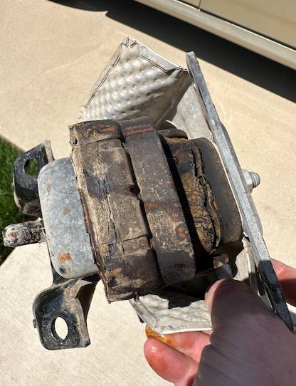

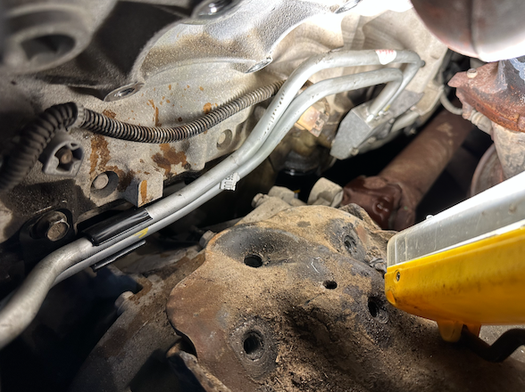

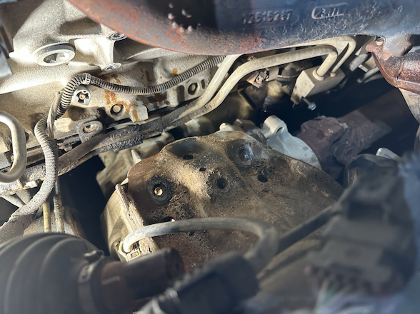

Dave,
Am I right in thinking the motor mount you show is not supposed to have the joint midway across, that being the failure point?
Presuming you have 4wd, did you have to remove the axle shaft?
Yes, I have a weeping crimped connector on my upper oil cooler line that is another thing on my list.

Quick question...going in that way from the top/side, were you able to get to the two 10mm bolts that hold the cooler line block to the side of the pan above the filter without dropping the front driveshaft?
I replaced the cooler line gasket about a year ago and did it from underneath but I unbolted the front U joint and let the driveshaft rest on the swaybar.
This summer when I replace my cooler lines I plan on doing it like you did by removing the motor mount and I'll also be removing the exhaust manifold to remove the broken rear bolt.
Yes, I was. In fact I had to get a helicoil into one of the cooler line bolt holes from underneath, previously. Never dropped the front driveshaft.
