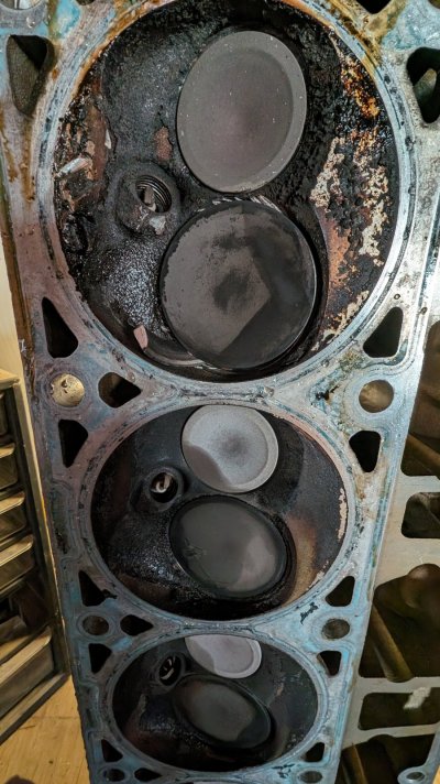

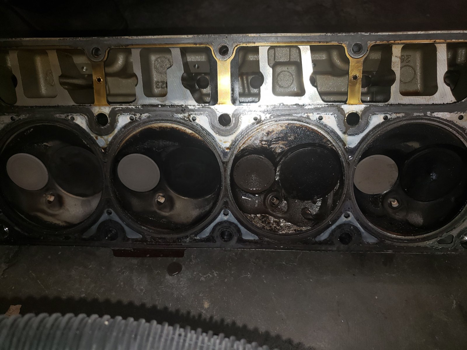

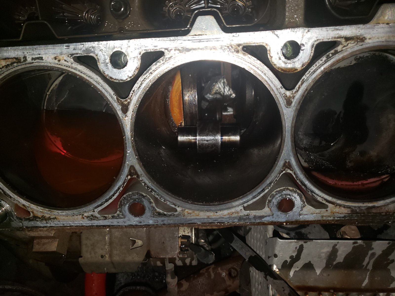

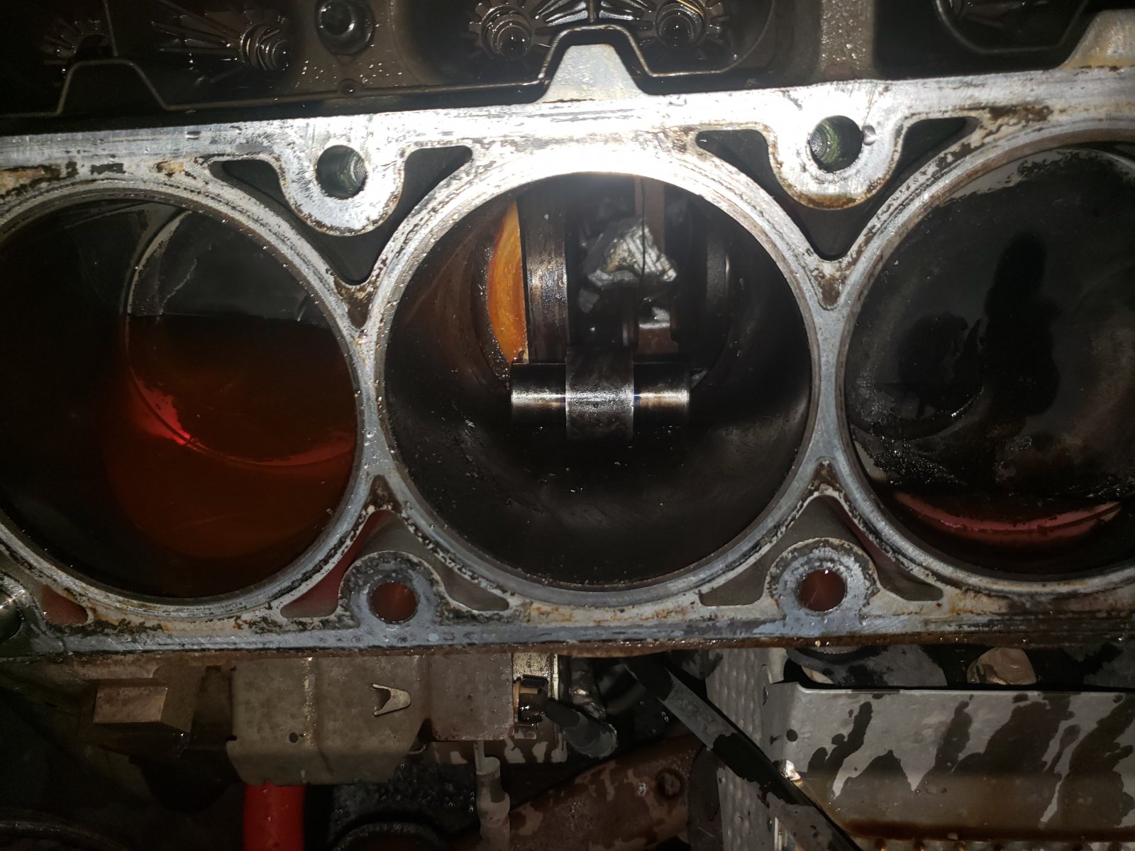

I picked up a 2009 Denali In similar condition scenario. Pulled oil plug and coolant came out with the oil. Couldn’t turn motor over with breaker bar on crankshaft pulley. Had to pull engine with transmission together. Pulled the heads and here is what I found, looks like the piston exploded. Taking block to machine shop to assess, but think it can be rebuilt. **Update-looks like a valve seat came loose and caused the piston to implode.***

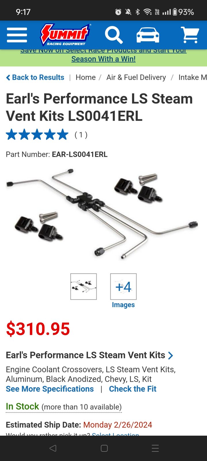

My 09 had the exact failure you have there, and it's even in the same piston location. I still can't explain why it happened, but I went with TSP performance heads and a 4 corner steam kit instead of going back to stock.

There are more cost effective versions here too that look good. But there are also more flimsy versions that use rubber tubing and look like leaks waiting to happen

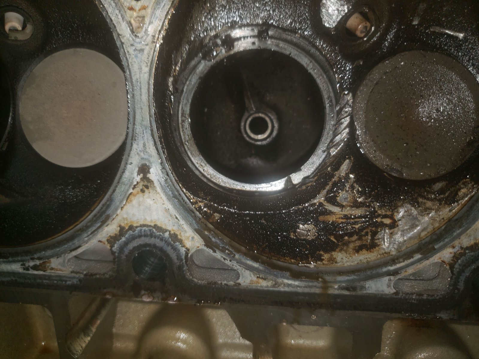

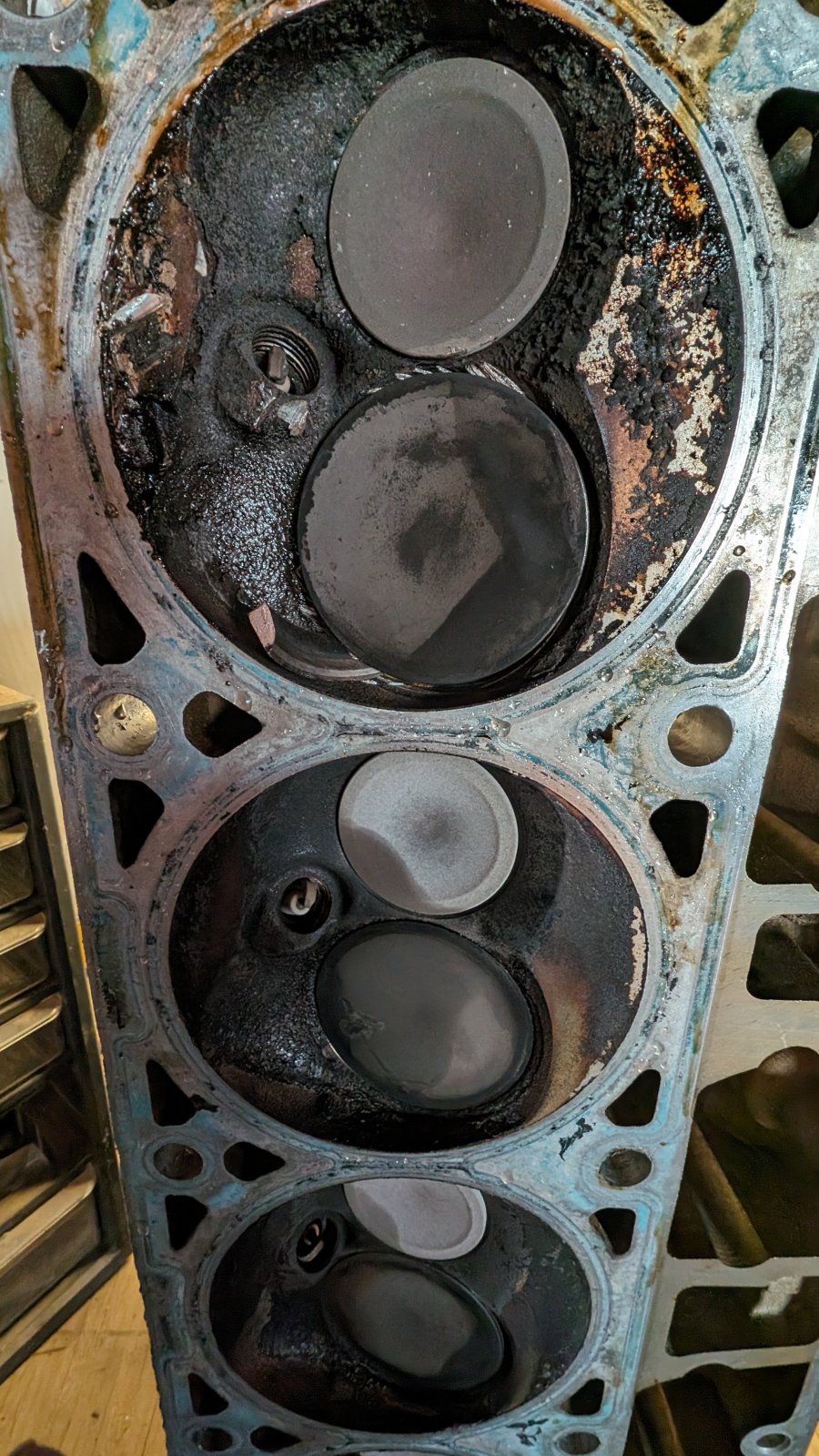

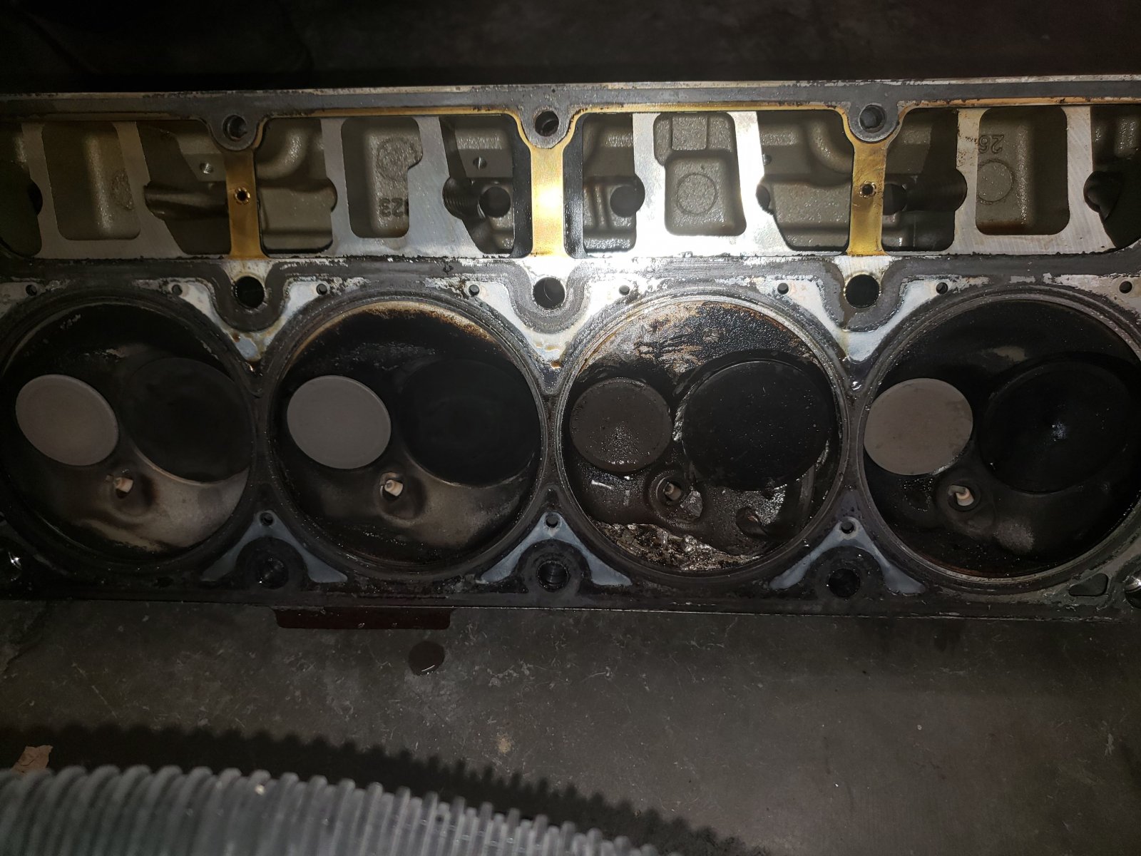

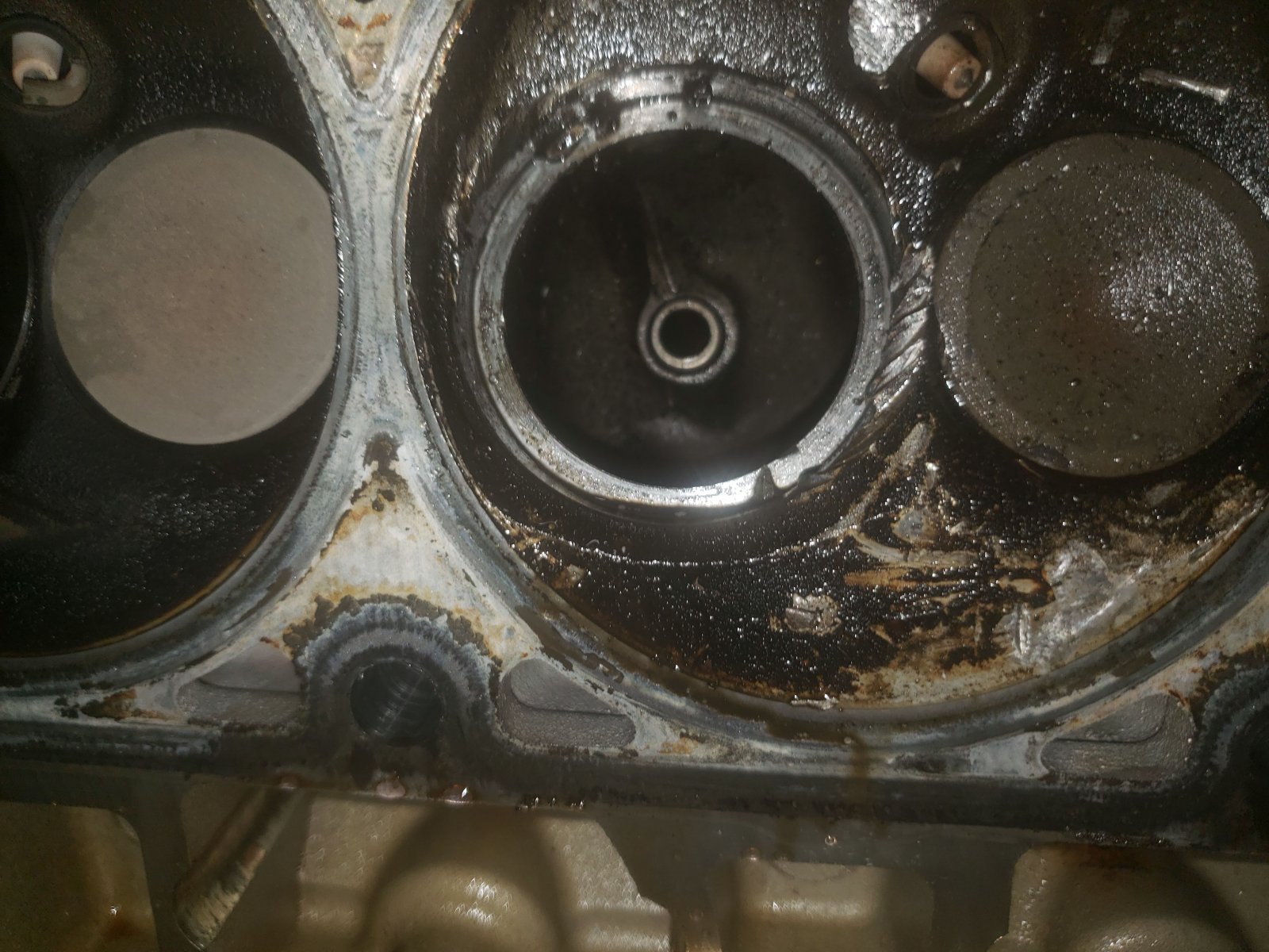

Got the head pulled today, about what I was expecting. Dropped a valve seat in cylinder 7. I was actually expecting more damage to the head, but the piston got nicked as well...
Other pistons on this side look fine and the cylinder wall isn't damaged. Not sure yet what I will do. May do a leak down test on the other side and see how that comes out. The PCV hose I noticed had quite a bit of oil in it, what does the inside of the "new style" vs "old style" valve cover look like? Not sure if that's where the oil is coming from or not, but it was my first guess with the oil in the hose and intake.
I had a brief thought of "Pull the pan and replace the piston"... but reality set in and that's obviously not the "Best" idea.

even the new style valve cover needs a catch can for the amount of oil in the pvc. so I wouldn't worry about that. I'm amazed how much I get every 5k miles or so.
honestly I kinda lead towards the sloppy mechanics way of doing things lol. good youtube if you haven't seen it. if pull the pan and pop a unused piston and rod in is an option, I wouldn't hesitate. mostly the valve train is going to fail on these things before a sketchy bottom end will anyways.

I am somewhat considering this...maybe...I'm one for fixing something if it's fixable...to a point. I doesn't look like it hit hard, so I don't believe the bearing or rod will be damaged.
I will assess some more and hopefully make a decision this weekend.

Quick update! Got the pan pulled last night and pulled piston out. Cylinder wall has no damage so ordered up the correct OEM replacement piston, got a head lined up (will be gone through and surfaced) along with the gaskets and hardware I'll need ordered. I did order a new rod bearing since it's cheap, not sure yet if I will replace the old one or not. It looked good, but if I'm in there and knowing that there was contact between piston and head via a seat...might be good insurance.
