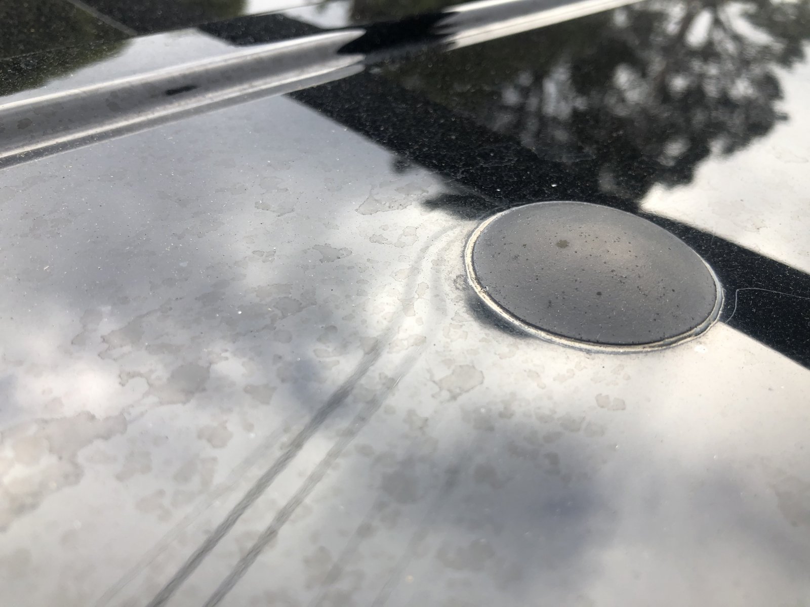

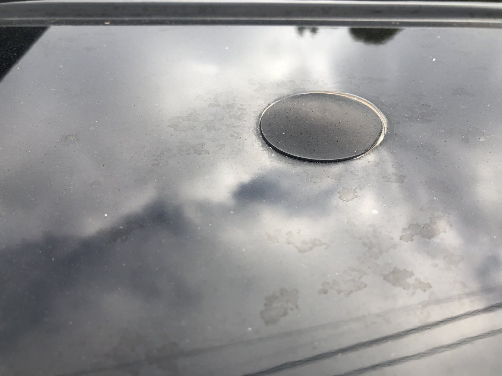

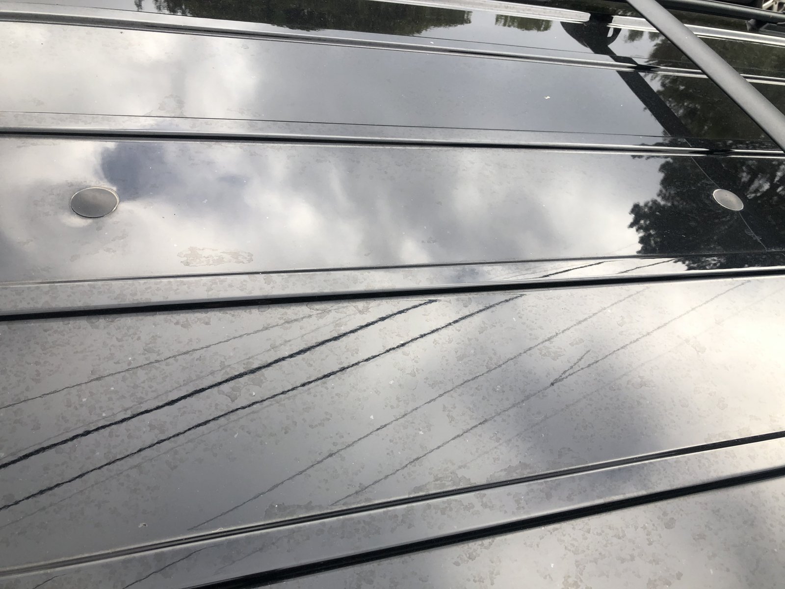

Thanks, Matt. No sunroof but there are two plugged holes I hope they are well sealed!!

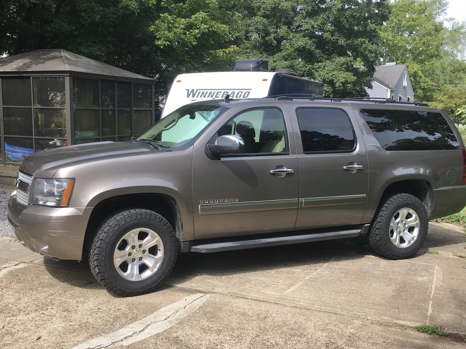

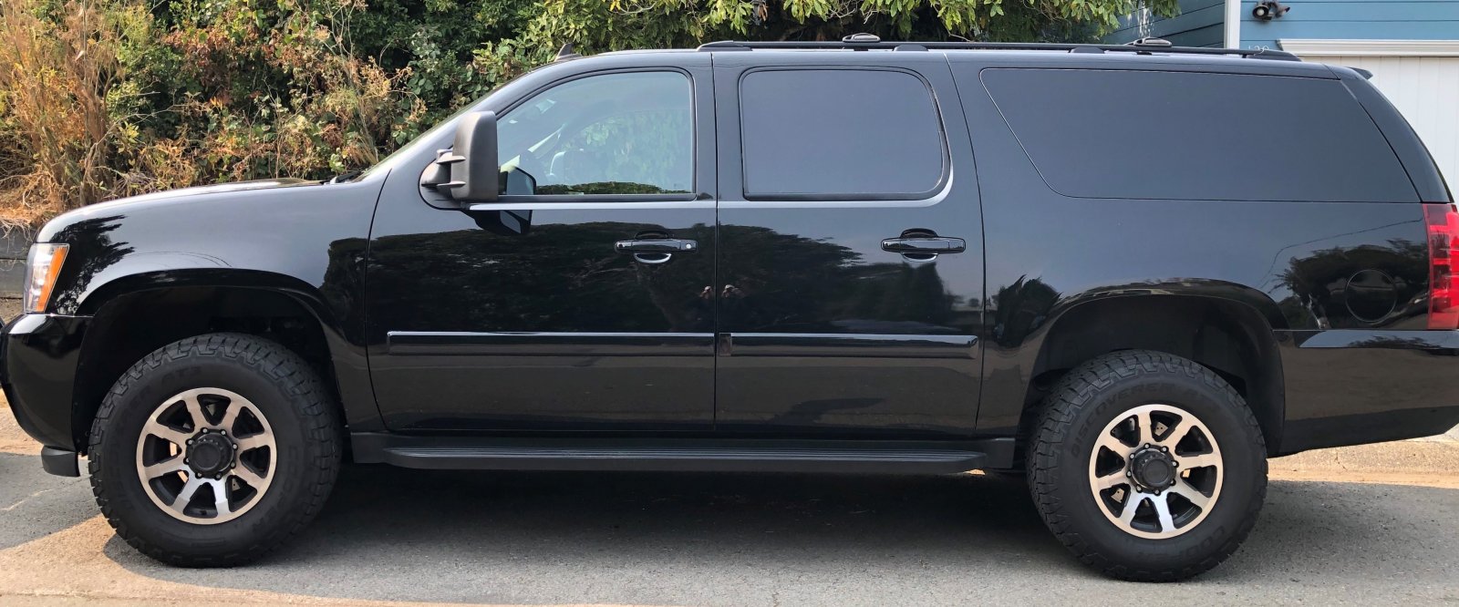

Guess I should add about the Wheels and Tires:
Wheels - MB Legacy 17" alloy wheels
Tires - Cooper Discoverer AT3 (LT275/70R17)
The front tire fit is quite tight. When I first received the truck the tires would rub slightly with sharp turns on uneven surfaces. After installing the shocks, and leveling and adjusting the front end up 1" (torsion bar adj I think) the clearance is okay.

Nice ride! What’s going on with the 2 plugs? Some previously installed antennas or something? Looks like I’d get the black caulk out for that just to be safe.

You can gain a lot of tire clearance on these rigs with the "norcal" fender mod, and trimming the front bumper supports, then reshaping the wheel well liner keeping it all OEM looking

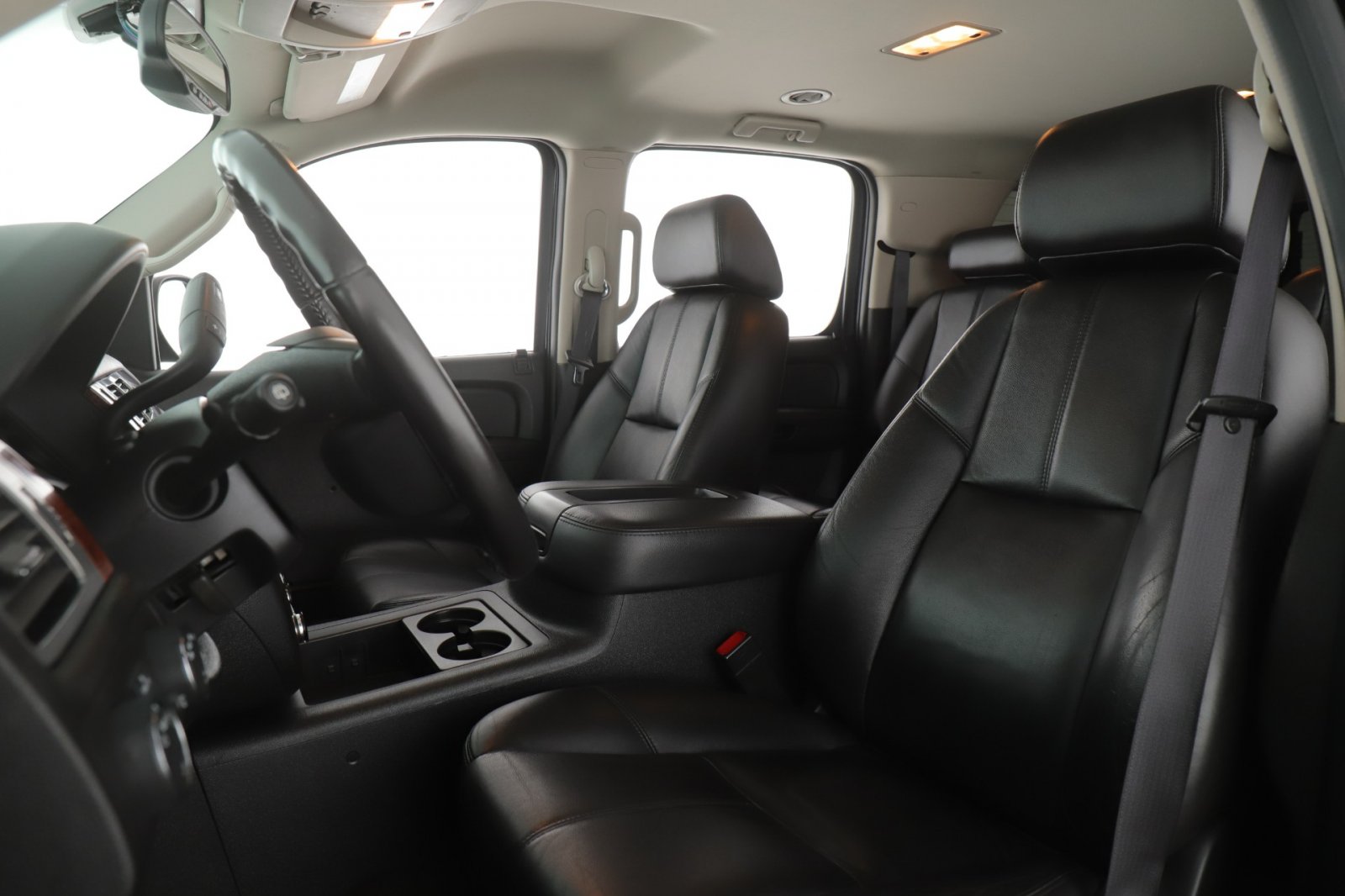

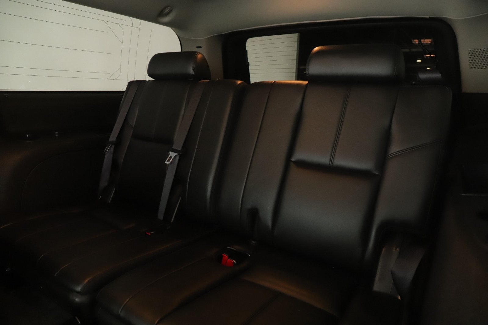

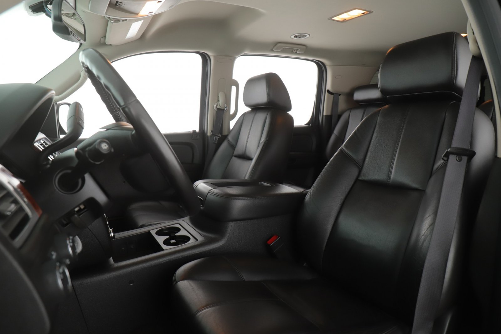

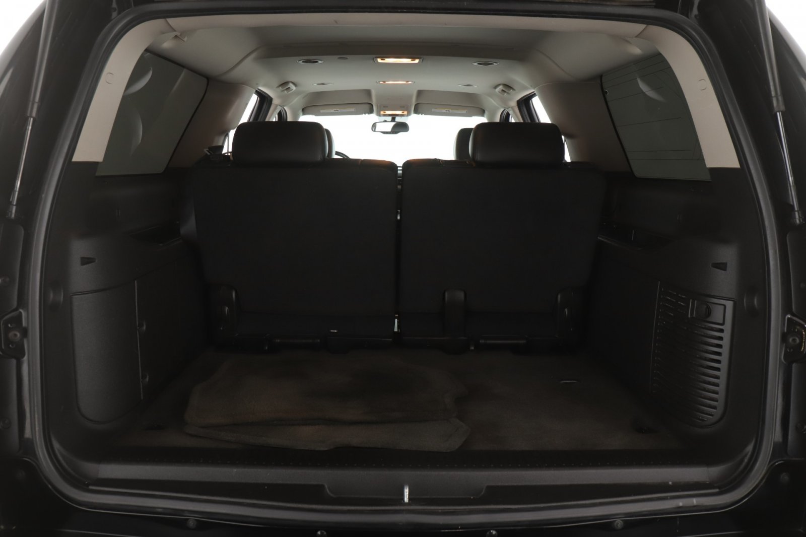

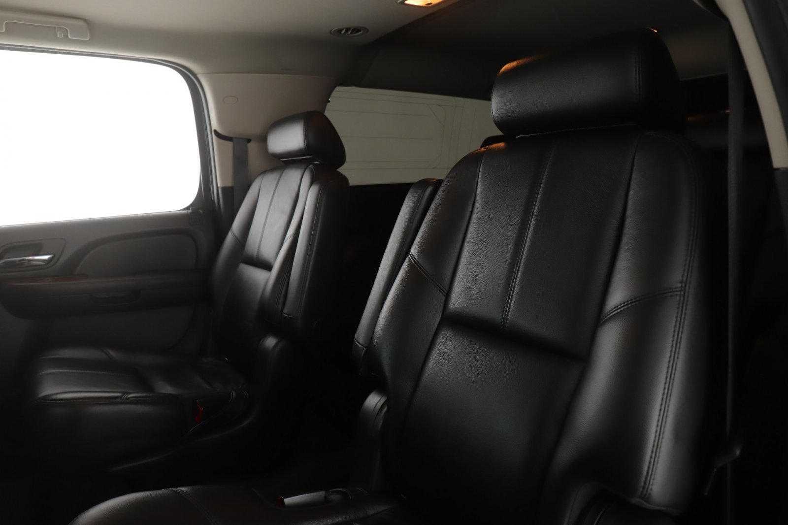

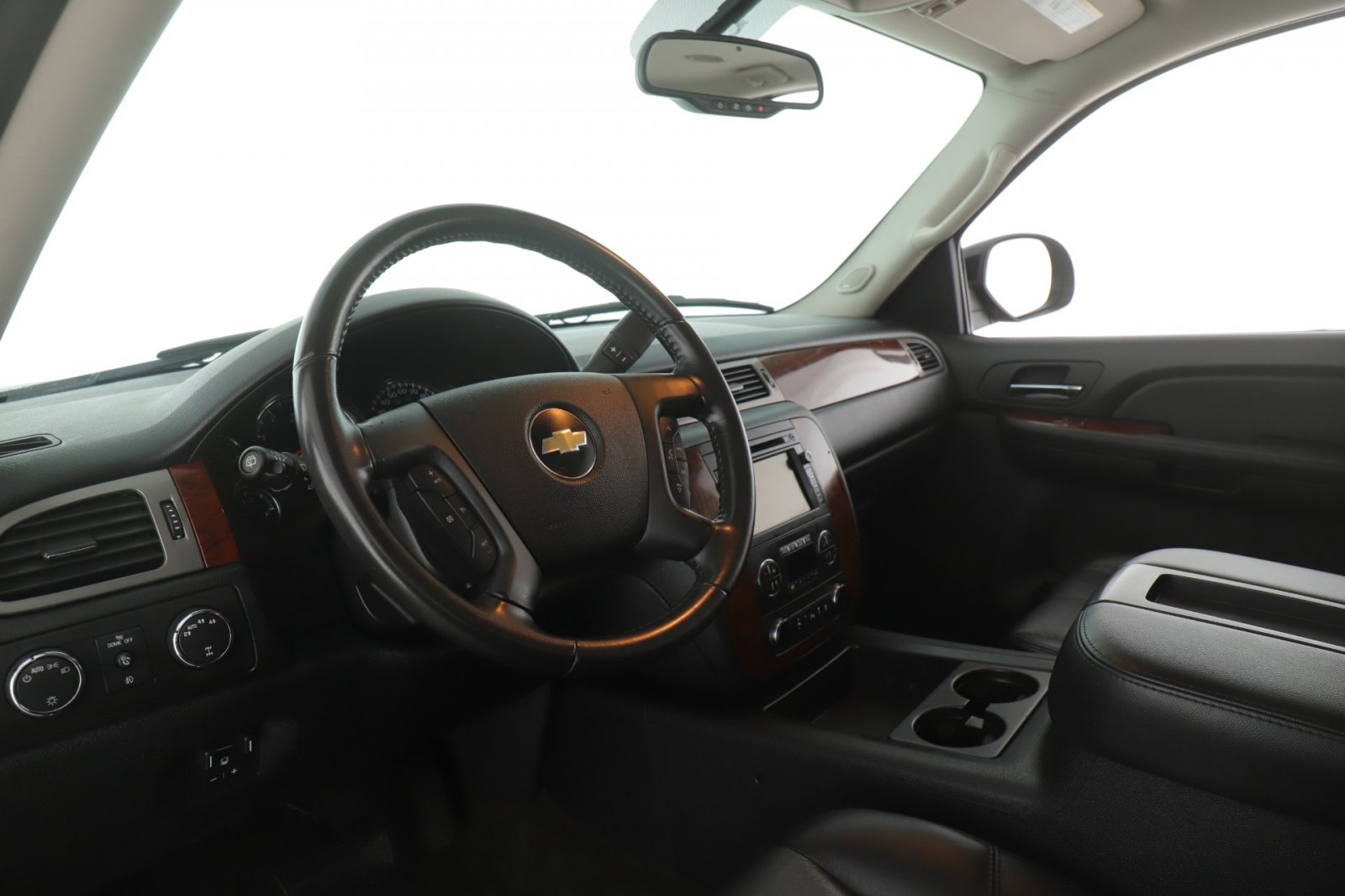

sure np here are some stock photos from the listing. anything in particular you are looking for?
View attachment 259617 View attachment 259618 View attachment 259619 View attachment 259620 View attachment 259621
Looks great, very clean interior! Don't forget that you have two fuel tanks and two fuel pumps that act as one. Put a Tech-2 on your list of things to get for it so you can work on it. Consider adding the GM Accessory Tilt and Shock sensors if you can still get them. Someday you might think of converting your motor to the L96 by adding the larger injectors and programming so the motor will then be FlexFuel capable, allowing you run various grades of ethanol for free horsepower or to save money on fuel if the price is right in your area.
