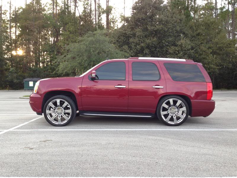

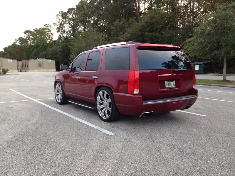

Exterior

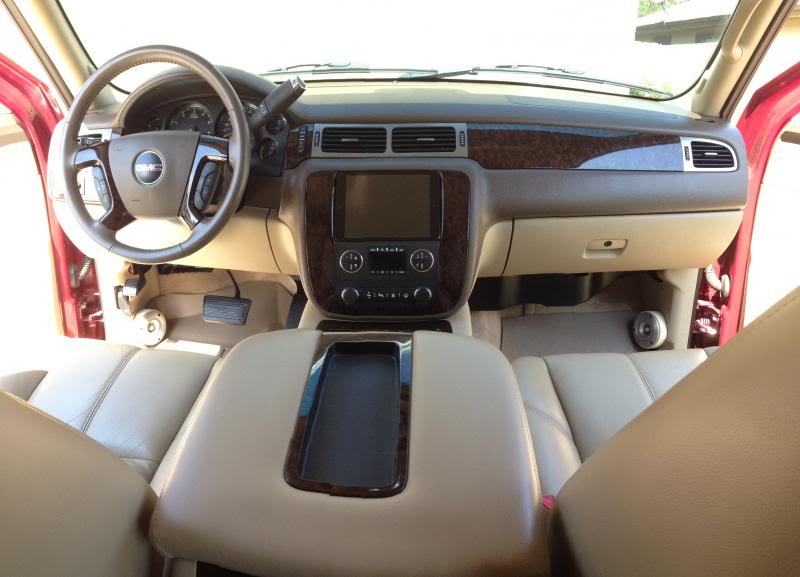

Interior

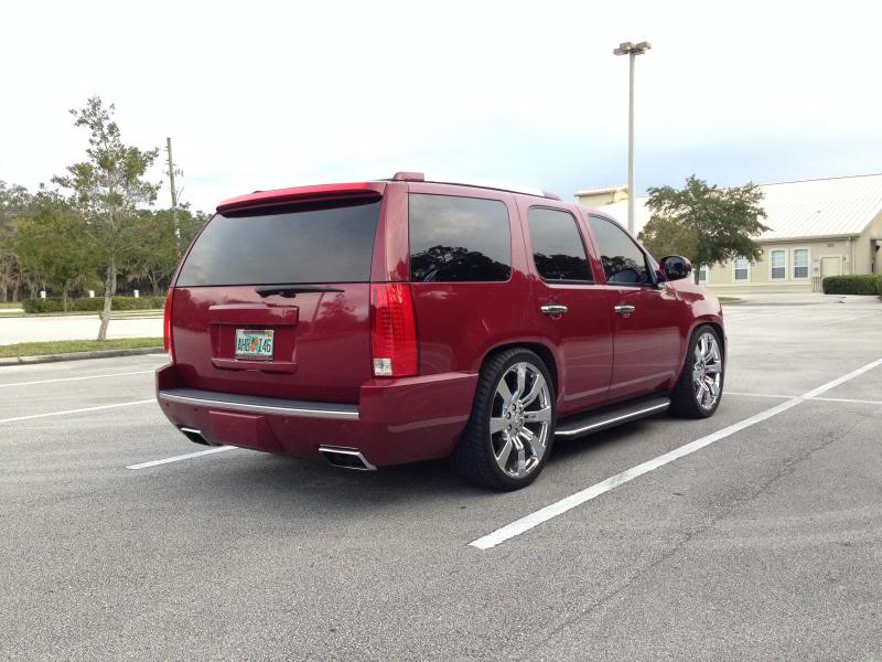

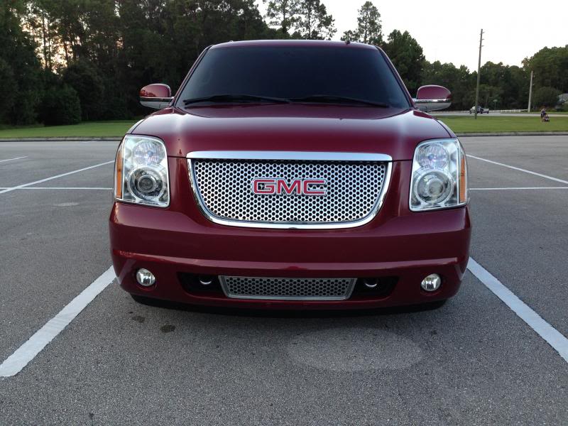

2007 GMC Yukon 5.3 2WD ~ Sport Red Metallic (Maroon) w/ Cashmere Interior
Exterior Mods:
-24” ck-375 reproductions with 295/35/24 tires
-De-Badged
-De-Molded
-Denali Chrome Door Handles
-Denali Chrome Tow Hooks
-Denali Upper and Lower Grill
-Denali Roof Rack
-Denali Running Boards
-Escalade 3rd Brake light
-Escalade Premium Rear Bumper (Built-in Dual Exhaust)
-Escalade Side Mirrors (2012 style mirrors)
-Escalade (G5) Taillights
-Headlight Projector Retrofit (2012 Lexus RX-350 Bi-Xenon Projectors with 4300k bulbs)
-Nokya 2500k 35w Fog Light Bulbs
-Replaced License Plate Lights With "6k Cool White" LEDs
-Replaced Puddle Lights With "6k Cool White" LEDs
-Replaced Reverse Lights With "6k Cool White" LEDs

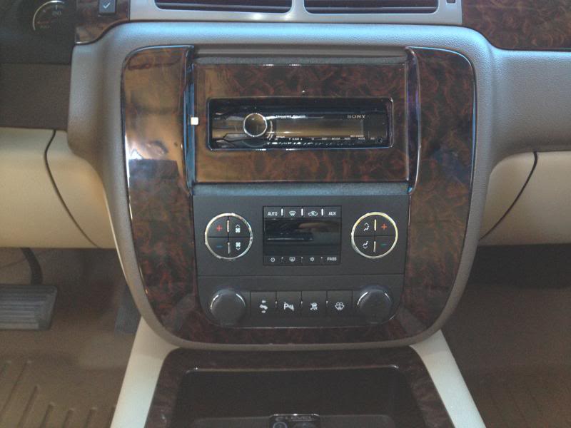

Interior Mods:
-4% Tint On The 2 Front Doors
-27% Tint Down The Entire Front Windshield
-4% Tint Over The Factory 20% Around The Rear
-Replaced all “Yukon” Wood Grain for Denali Wood Grain
-Replaced ALL Inside Lights With "6k Cool White" LEDs
-Denali Leather wrapped shifter (2010)
-Denali Wood Grain Steering Wheel
-Hydro-dipped Console and Cup Holders (Matching Denali Wood)
-Hydro-dipped Rear Console Radio Surround (Matching Denali Wood)

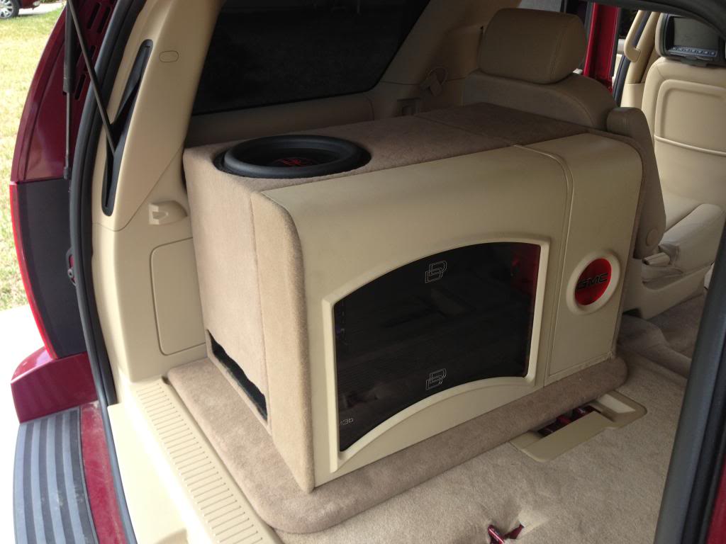

Audio/Video Mods:
-Headrest/Screens
-iPad mini custom indash
-Sony MEX-GS600BT Head Unit Receiver
-Concept CLD-700 7-inch Headrest Monitor w/ Built In DVD Player (for 2nd row passenger side)
-Concept CLS-700 7-inch Headrest Monitor (for 2nd row driver side)
-Concept CLS-700 7-inch Headrest Monitor (for 3rd row pass side)
-Concept CLS-700 7-inch Headrest Monitor (for 3rd row driver side)
Install accessories
-Metra 95-3305 Double DIN Installation Dash Kit
-Metra Axxes GMOS-LAN-012 Wiring Harness
-Metra Axxess ASWC Universal Steering Wheel Control Interface
-BatCap Model 2000
-OEM backup camera Retrofitted
-Rear A/V inputs Retrofitted
-Retrofitted the Silverado/Sierra USB plug into the Dash

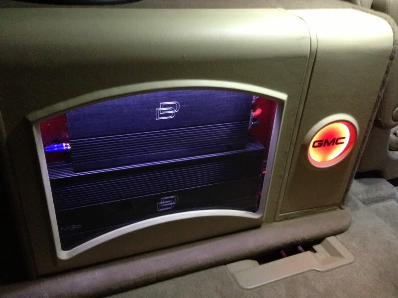

Mids & Highs (Front)
-Beyma Pro65Nd mids
-Beyma PH35 highs
-Audio Control 6xs 6 channel electronic crossover
-Digital Designs C5C full range amplifier
Subwoofer
-Digital Designs 9512 supercharged 12" woofer
-Digital Designs M3b mono block amplifier
Misc
-0 gauge from front battery to Batcap.
-0 gauge from Batcap to M3b
-4 gauge from Batcap to C5C
-Custom box
-Custom kick panels for the highs. We even cut the WeatherTech floor mats to fit perfectly with the kick panels.
-Custom modified headlight switch to mold in the M3b's gain control knob
-Custom amp rack. The amp rack is painted the same color of my truck behind the amps and it lights up with "cool white" LEDs. Also The GMC logo covering the Batcap and crossover lights up red. The LEDs are hooked up to come on when the interior lights come on.

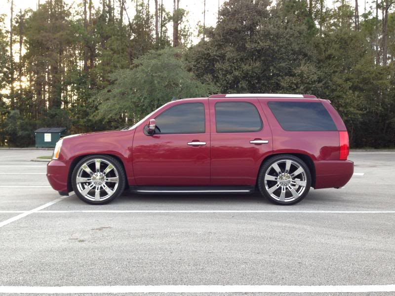

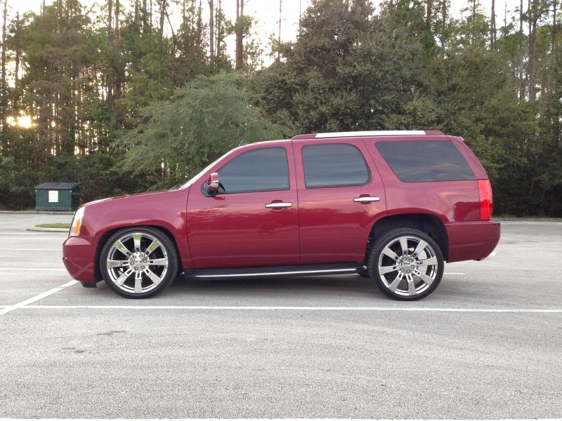

Suspension Mods:
-Kelderman Air Suspension
-----All down - Front 32" Rear 32.5"
-----Ride height - Front & Rear 33.25"
-----All up - Front 37.5" Rear 38"
-Belltech Camber Kit (Front)
-Belltech Street Performance Rear Shocks
-DJM Rear Shock Extenders
-DJM Rear Swaybar Shorter Endlinks
-DJM Rear Trailing Arm Relocation Brackets
