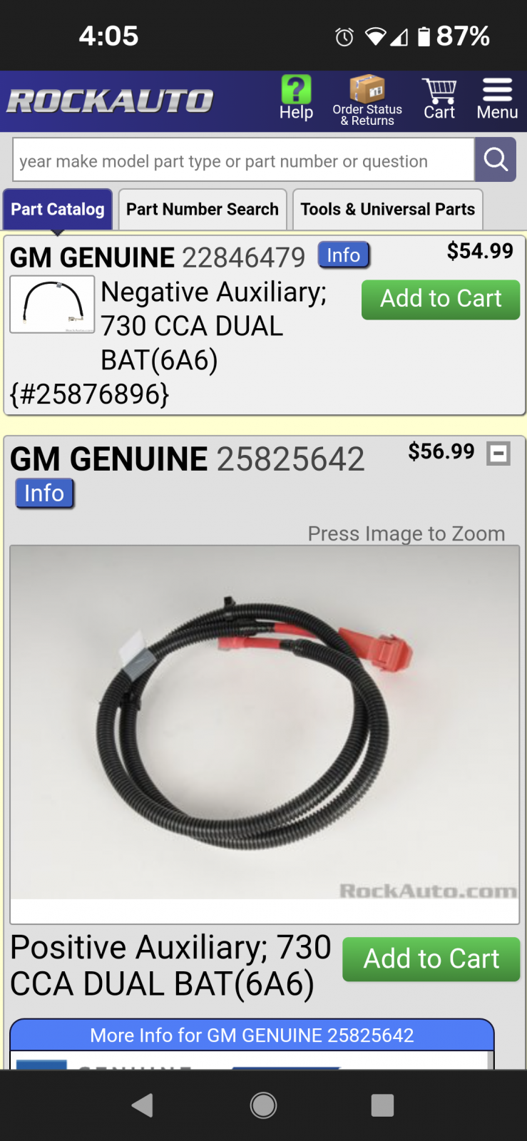

Does GM not offer a wiring harness for the TP2 or 8BO options that a plug and play?
Or is it DYI only?
Shannon
mikeyss
Nov 11, 2011
1,758
3,393
Longmont, Colorado.
Or is it DYI only?
Shannon
Gm offers both, I believe rockauto sells them. I got my dual battery factory setup parts from them, using the factory wiring setup where the battery positives both go to the starter, and the driver's side battery factory negative wire that goes to the alt bracket
I’ve looked for the GM part# with no luck.
Shannon
mikeyss
Nov 11, 2011
1,758
3,393
Longmont, Colorado.
Here you go :)

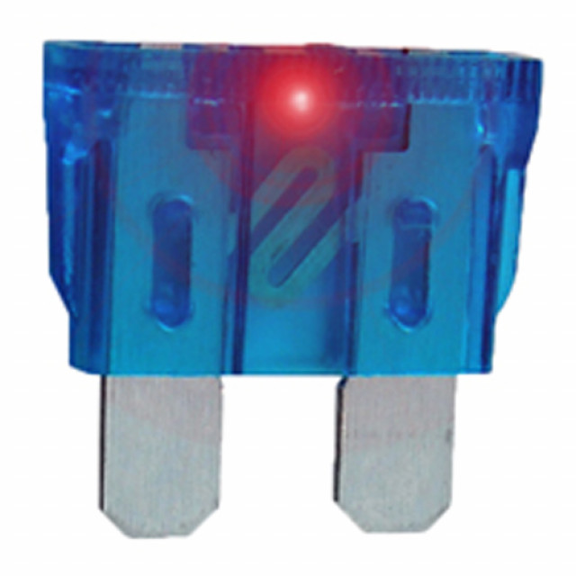

I agree that overkill is actually proper engineering. Resetting a breaker or GFI is an instant payback the first time it trips.
I’ve always had pros handle the upgrades and repairs on our vehicles. That’s paid us back since the 90’s on German vehicles we’ve kept since then. Running Euro only options that were properly integrated into US spec vehicles means zero issues.
The only other recommendation I’d add if upgrading to duals is swapping all the fuses to the aftermarket type that light up when they trip. At night or severe weather finding the little buggar that needs replacement is a breeze.
GlowGeek 100pcs Assorted Auto Car Truck Standard Blade Fuse Assortment 2A 3A 5A 7.5 A 10A 15A 20A 25A 30A 35A Car Boat Truck SUV Automotive Replacement Fuses
https://www.amazon.com/dp/B06XY2V53...abc_NCDHZ59T6M0R731FDHE5?_encoding=UTF8&psc=1
