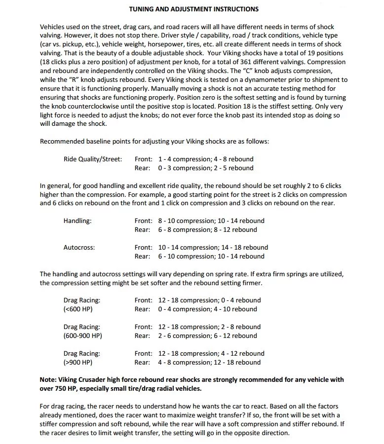

All the shocks have 18way adjustable compression and rebound setting and I had them set to the 600hp or less drag racing setting which I will have to look at the chart to see what that is. I don’t think it hit the bumps because it has several inches of up travel but anything is possible.

In the 16.5 3k launch vid, watch the 19 second mark repeatedly. I saw very little weight transfer. Traction broke from the shock of the clutch dump before anything could get moving. You're gonna have to get the shocks set better and find that sweet spot between dumping and slipping. Then, after you roast the clutch and glaze the flywheel, you'll have to re-learn all over again with the new performance clutch.
I thought the same thing even in the moment I never felt that squat back feeling. Guess I need a bunch of street practice and shock trial and error. I do have 2 spare clutches in the shelf one of which is fairly aggressive but I really don’t think the clutch is in any danger they are massive
