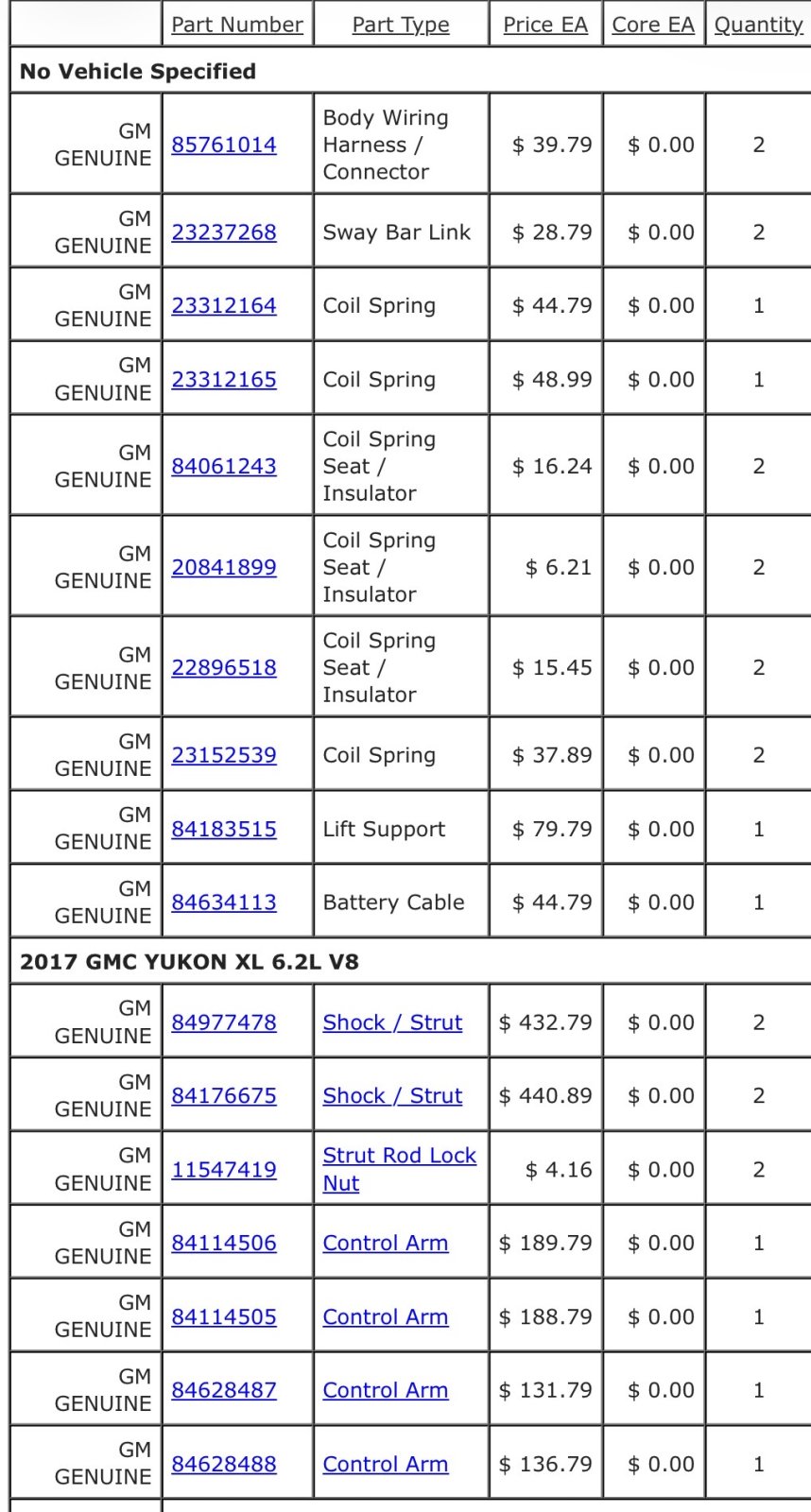

Hi all, I just replaced my suspension with all OEM magneride parts. Previous owner put passive aftermarkets in the front. I replaced all control arms, front and rear struts + springs, sway bar bushings and links.
Now I’m hearing major clunking in the front end over bumps, it rides poorly, and it sits much higher in the front. It used to slant downwards from the rear, as in the rear was slightly higher than the front (I was always told this is normal and I’ve seen many other Yukons like this). But now the truck is completely level.
Any ideas what went wrong here? I spent over 4k in total to get a smooth ride, and this is just awful. Bumpy and clunky. I could definitely use some advice.
I’ve attached the parts list for good measure.

It’s a nearly fully loaded Denali (only option it doesn’t have is ACC). Z95 mag ride package. I took a look at this link but I’m just as confused, the parts seem to line up from what I see. I have no idea what the issue could be…
This spring if I'm see correctly isnt for vehicle that has magnaride.
The springs will determine height of vehicle in front.
You should be able to type in your VIN on links page and should show which parts your vehicle was original built with.
