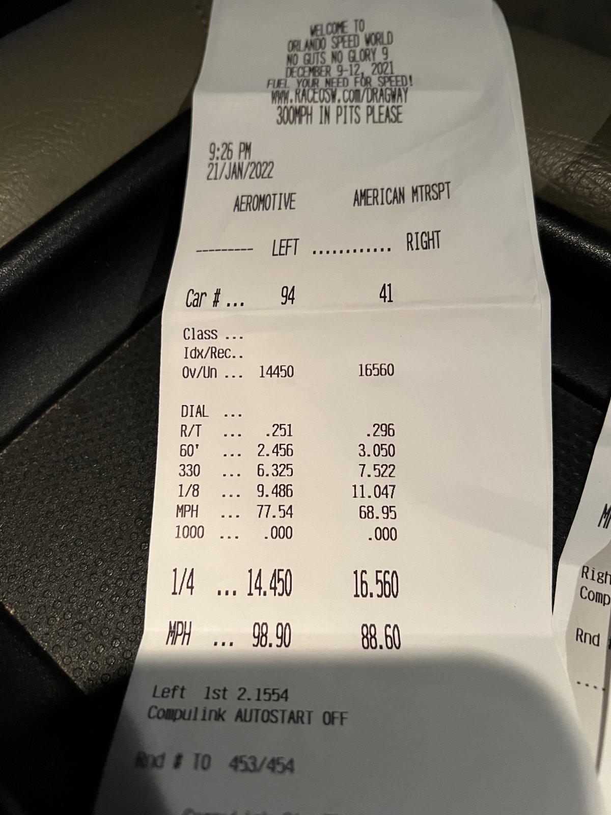

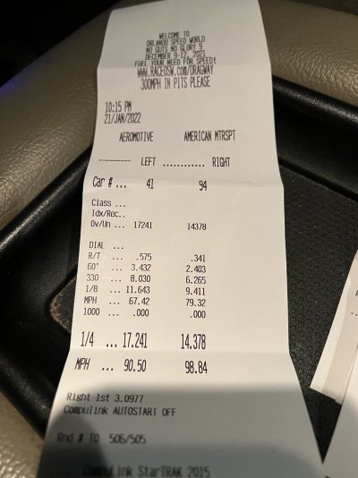

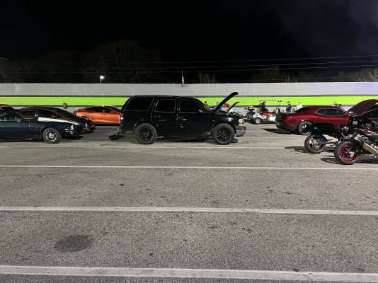

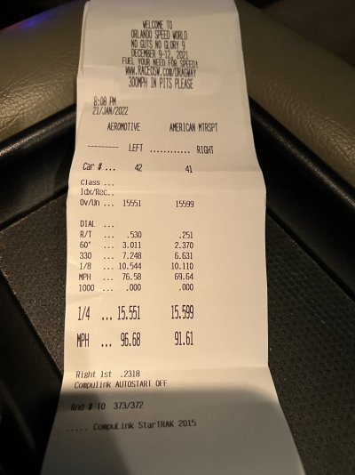

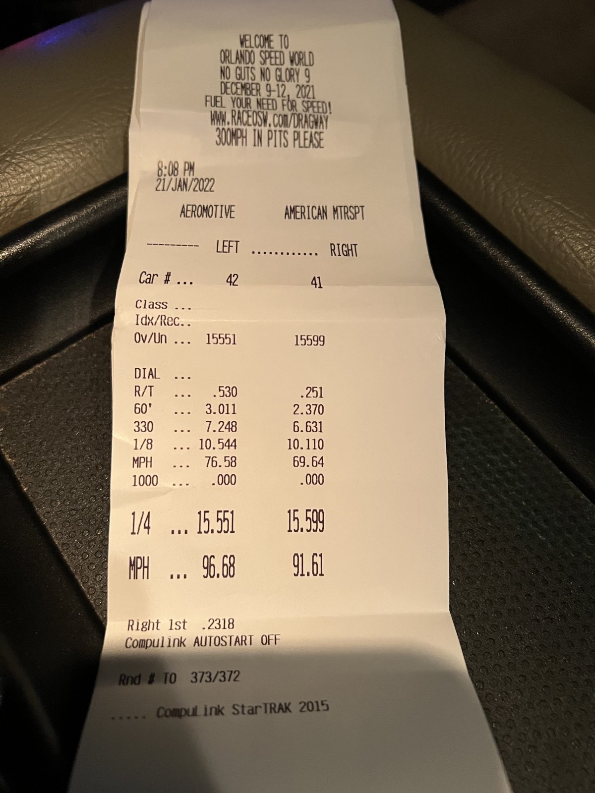

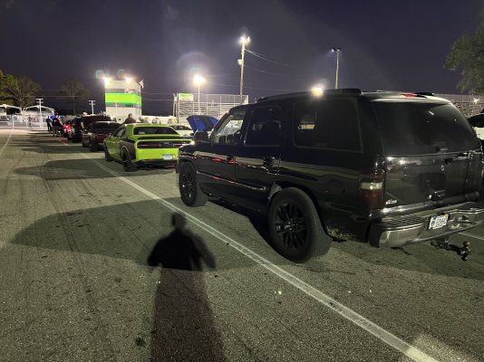

This mofo slow yo! Best time was a 15.5 @91mph :sad72:
So I made four runs.
1-left @1,700 in first with no burnout. Spun a tad then bogged a tad ram 15.8
2- left @2k in first with a burn out, seemed to dead hook but bog a tad. 15.551 @91
3- Adjusted shocks, dropped TP from 42# to 28#. Left @3k in first with burnout, spun through first shirt shifted to second which bogged. 16.5 88mph
4- Dropped TP to 22# left in second @3k with a burnout. Bogged so hard it nearly shut the engine off. Ran 17.2 at 90
So I need to figure my launch out because clearly I suck at that. Nothing broke on either truck and my buddies 408 Denali ran a 14.2 in 4x4 with a soft launch it definitely has mid 13s in it with a real tire.
Btw I’m #41 Denali buddy is #42

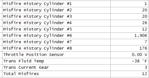

I went back and looked at a few things from each log (I wish I could post them on this forum) and for some reason during my idling before my second run #6 had 1906 misfires! they seemed to pile on while I shuffled forward in the staging lane but once I did the burnout they stopped. Either way, it's concerning so plugs and wires are ordered as well as intake gaskets because I didn't do them when I had the intake on and off 15 times a few months ago and I wanted to. I still have that weird first start funkiness that I've had for years at this point and maybe the intake gaskets are causing a vacuum leak.
