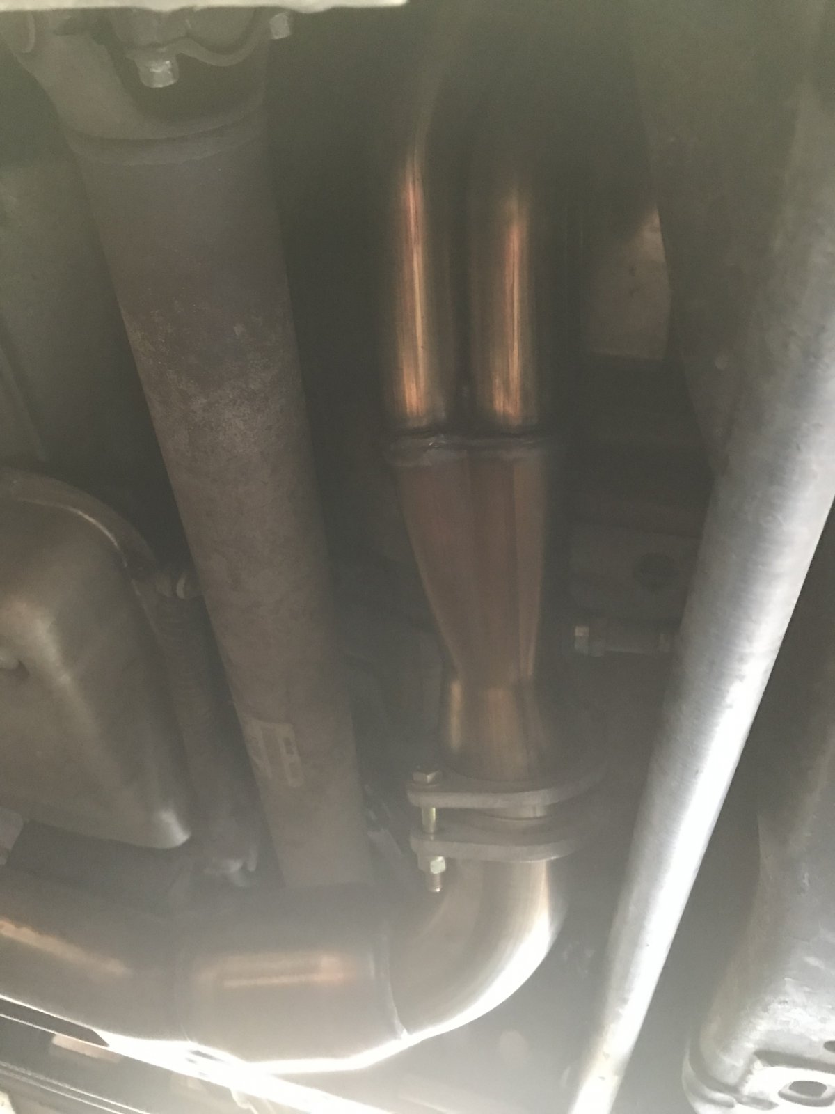

Also, I highly recommend using a Lubelocker gasket. They are the best, reusable, 100% worth a few bucks. If your pan has a small “step” in it, that’s how you know if it’s the deep version. The non-deep version is completely flat.
sorry, it’s hard to see from the picture, but best one I could find. I thought I had a better one.. but you can see the step in the pan there on the left.
