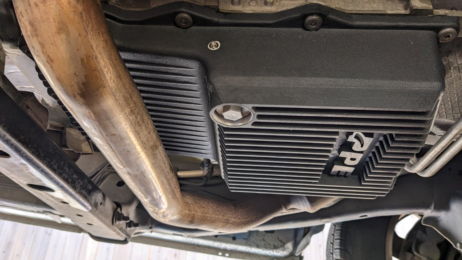

I did this, installed a new aftermarket PPE pan with a drain so I can perform drain and fills without dropping the exhaust. Removed the drivers side O2 sensor and dropped the exhaust down a few inches from the manifold. There is a flex coupler that allows the Y pipe to be dropped. I do not think I could have slipped the newer PPE pan back in if I jacked up the rear of the trans as the PPE pan is deeper.
I have this info in a thread about upgrading the valve body with the NextGen parts. Search my user name.

How do you like the PPE pan? Been thinking of adding that also. It has been 20,000 miles since the new trans was installed on my 2021 in Feb. 2025, and thinking about fluid and filter change. If I do that I will also install better pan.

Even if you do not do your own work, suggest you get an aftermarket pan with a drain plug installed if you have fluid and filter changed, then you can perform an easy drain and fill without the filter every 15k miles. Anything to lengthen the transmission lifespan would be wise.
Sorry, just saw your question about the trans pan, I like it very much, great quality, holds a bit over 2 extra quarts of fluid and will give protection in case you run over something, the OEM pan is way too thin and will not hold up to any impact. Would use this pan again in a heartbeat.
