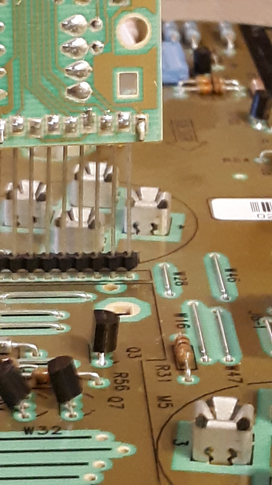

This has happened before from time to time, but now it seems to have left the building. In prior occurrences, I was able to tap on the faceplate and it would come back on, but no amount of tapping or cussing seems to be working now.
I am guessing the first probability is the screen is shot. Second, maybe a loose wiring connector. Before I tear into it, I thought I'd get some ideas and help here.

There’s a variety reasons this can happen. My 04 has been a hassle recently. I opened up, looked at the solder joints, looked fine. Replaced the actual harness, worked for a while, then died. Ended up just sending it to circuit board medics to rebuild. Don’t waste your time trying to diagnose the problem, just get it rebuild. Cost me like $180.

OK, I tore it apart today and, sure enough, the solder joint was bad. A little elbow grease and solder, and it's back in business.
I should have noted that the culprit is the far right connector in the pic above. Obvious when you know where to look!
