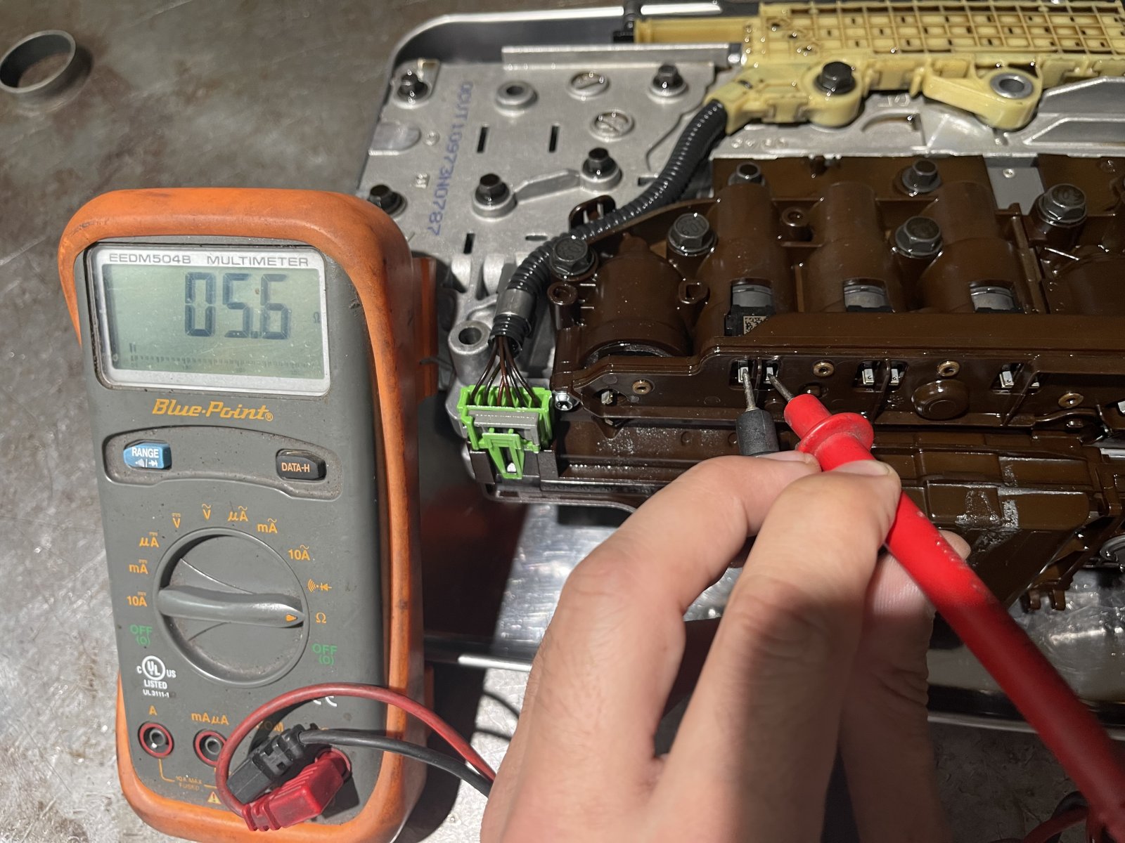

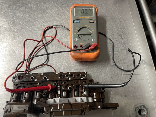

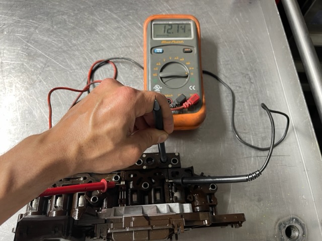

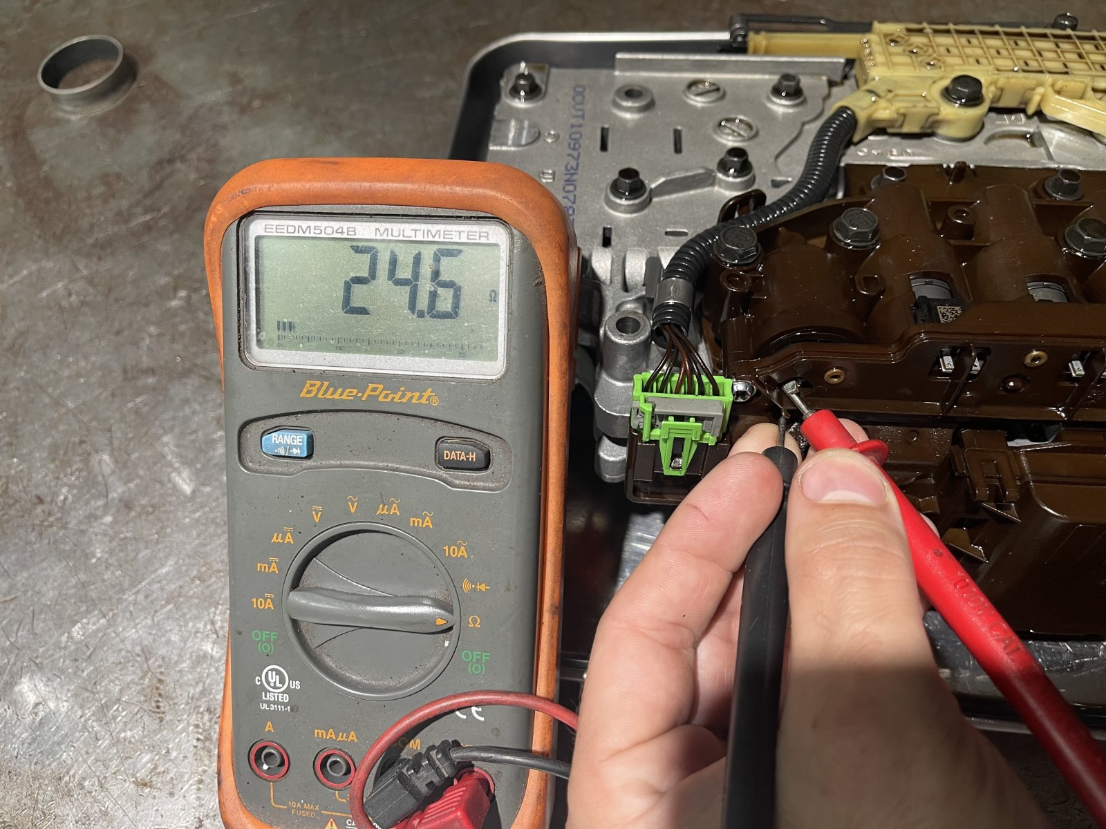

@jdwood1111 ,
Here are my responses to your questions (yours in bold, my responses are in reg font below them)
Can I do this with the Tech2? Is it worth using the Tech 2 to check the solenoids that I found in the unit?
> Yep, the TECH2 or any bi-directional scan tool that has adapt functionality will do the fast adapt
> You can fully bench test the solenoids for mechanical function using a Kent Moore test plate and TECH 2 (full comprehensive test) and use a multimeter to evaluate electrical health though if you had a solenoid or pressure switch issue, chances are you'd throw a code by now (but not always).
Review this article for the TEHCM testing procedures.
> Using a multimeter to test resistance for shift and pressure control solenoids (shift solenoids: 20-40 ohms; line pressure/clutch pressure control solenoids: 3-8 ohms).
shift solenoid
Pressure switch resistance (closed circuit): .7-1.9 ohms ( this is pressure switch #1 which sends a signal to the TCM reporting the status of the 3-5-R clutch reg valve in the valve body)
Pressure switch resistance (open circuit, pressure applied to switch) 11.5-12.9 kohms
Use pencil eraser to put pressure on switch to open circuit
Pressure switch resistance should drop back to .7-1.9 ohms or so (may vary a bit but should not be significantly different)
If any of those pressure switches are not reading like the above when you do this test, then the TEHCM is bad and should be replaced!
