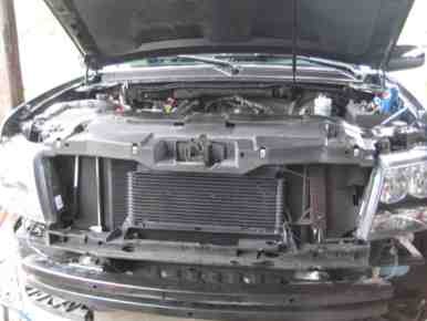

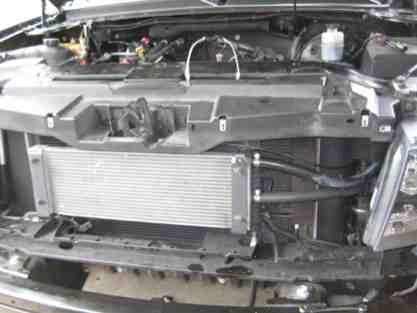

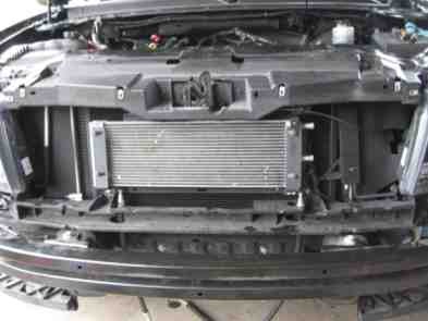

These are all the pics I have for now. Couple of the tranny cooler and inter cooler install. Will post more pics and dyno numbers in the next week or two. Hoping to get around 400-450 HP at the rear wheels. Maybe a cam, spring, lifters and rods if this won't be enough to get me there. Oh, and a new tranny soon too. Not sure how long the 4L60E will hold under this set up.

Pics..

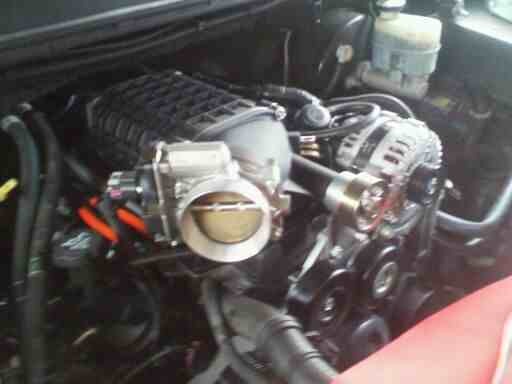

Another pic with blower on. Sorry for poor quality. Camera phone.

You will probably be pretty close to 10psi. I would not run a 2.8" pulley though, it would be too much for your engine.
