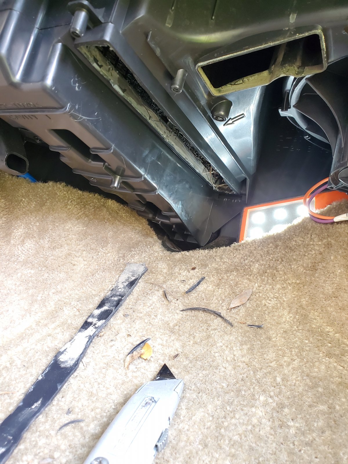

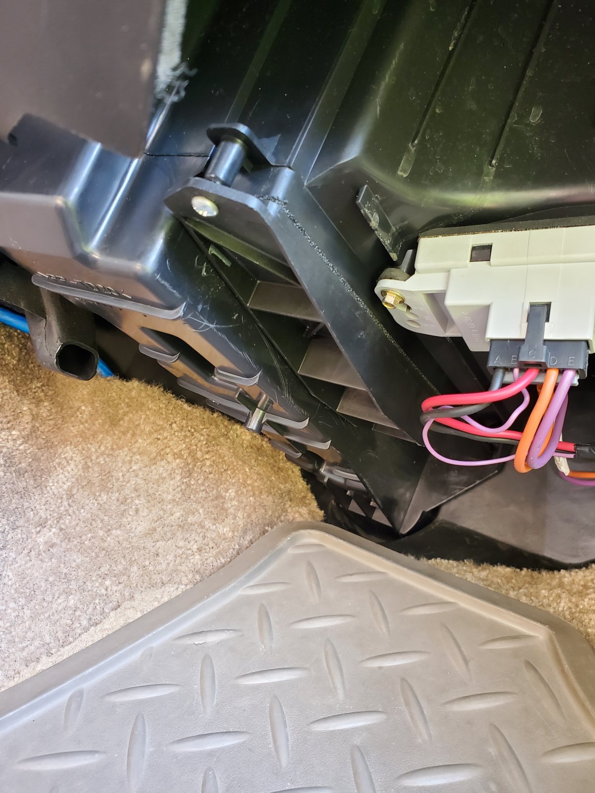

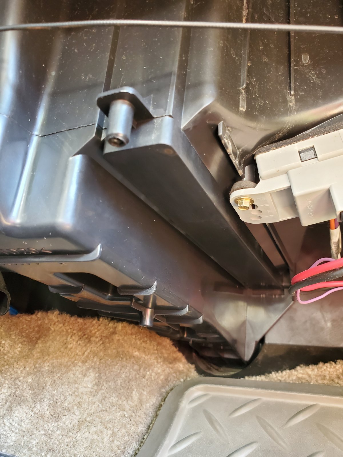

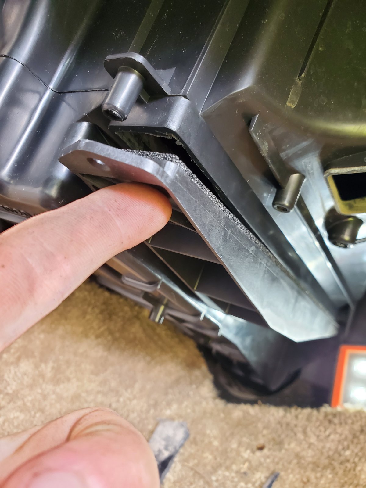

Anyways, here are part numbers and pics of how cheap and easy it is to go in and clean up the evaporator and install this kit.
I came across on these forums didn't fit, but the one below I just put in and fits perfect. (9"x10.5" I believe)
Hot utility knife and some sandpaper afterwards to clean up the ****** cuts.
Used a long soft nylon brush and vacuum and compressed air to clean up debris built up.
Then I used a $7 can of foaming evaporator cleaner from local auto parts store, jammed it up both the front and rear evaporator drains, and also sprayed it in the newly cut hole for the inlet filter.
Topped it off with a $10 can of r134a I believe my low side pressure was around 55psi when it was like 90F outside.
She blows ICE cold. Hope this helps someone.

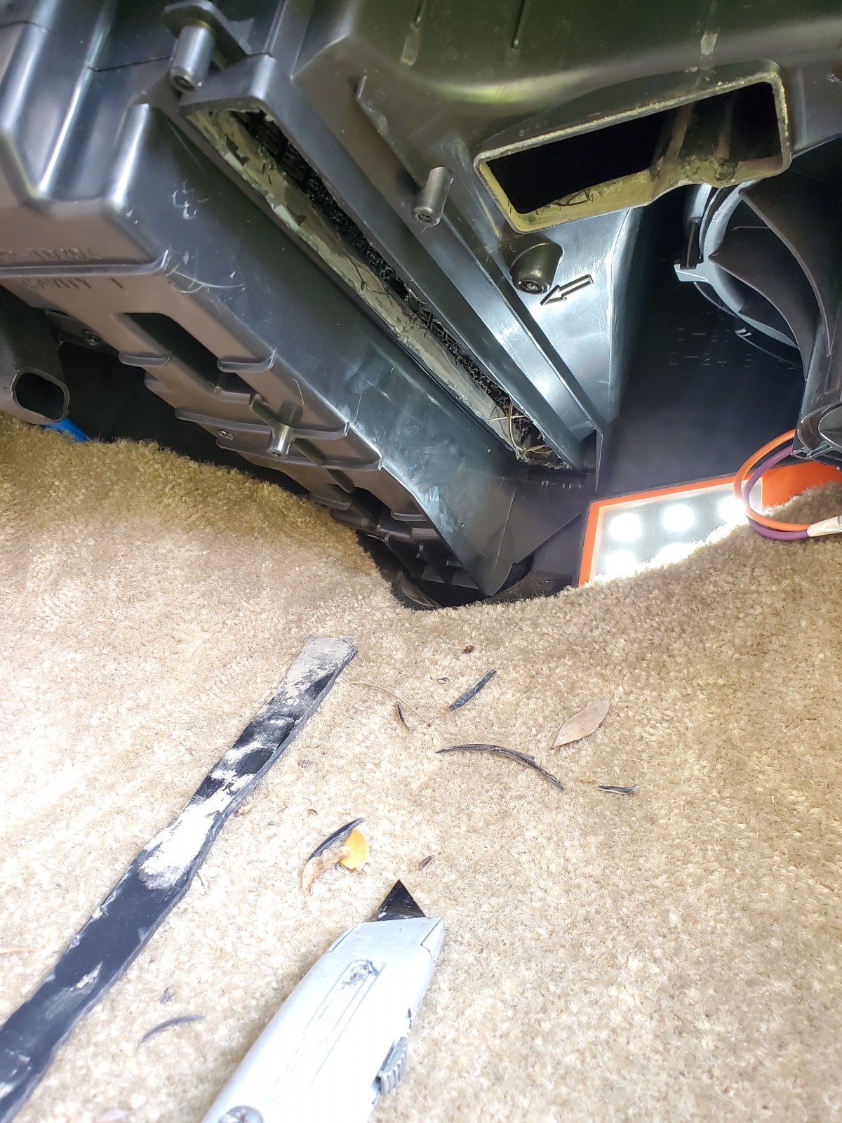

Dorman 259-100 (https://smile.amazon.com/dp/B00NF1R0FY?psc=1&ref=ppx_yo2ov_dt_b_product_details)
CF10360 Filter (https://smile.amazon.com/dp/B001CEG90S?ref=ppx_yo2ov_dt_b_product_details&th=1)
