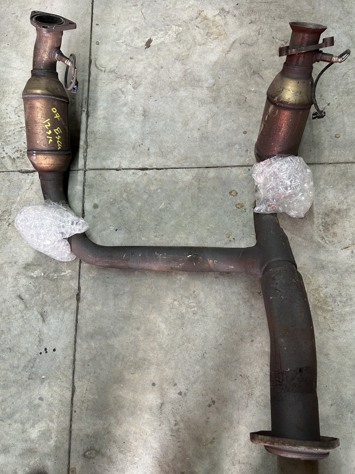

So I finally found an OE y-pipe from an 07/08 Cadillac.
I just want to quadruple check that this will actually fit my 07 Tahoe?
I think the only difference I see besides the diameter of the tubing is the driver's side kicks out, must be to clear the trans.
Any and all info is much appreciated
As always thanks guys
EDIT: I just ordered it after reading through this thread it seems to be the correct one and I am able to return it without issue. So, I'll update this when I get receive it.

It finally showed up.
Wow- with converters. $$$
