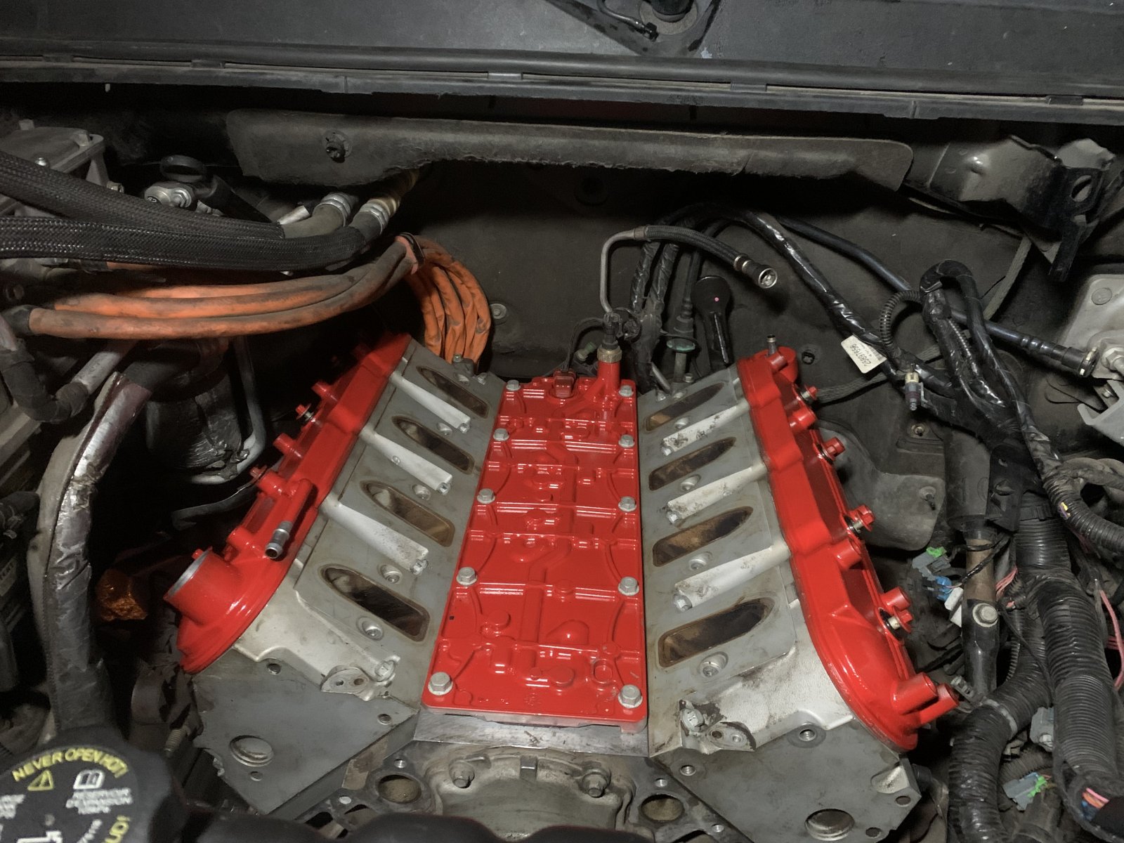

View attachment 395441View attachment 395442
Hey all, I'm looking for some help and thoughts on an issue I have been battling with my 08 Tahoe Hybrid. I recently had an issue with a collapsed AFM lifter so replaced all of the valves. Due to the cathedral heads I needed to remove the valve covers, Heads, Intake, Exhaust Manifolds, and the valley cover. In the process of doing the valve replacements I replaced the valley cover plate, the valves, the spark plugs and the gaskets. I also replaced the water pump as I noticed that there was a leak from the weep hole on the pump. Prior to removing any of these parts I disconnected the 12V accessory battery and then removed the disconnect from the hybrid battery. I had to pull the wiring harness from the top of the engine which runs from the left side to the right and connects to the Hybrid control box on the right side as well as the coils, fuel injectors, and a handful of other devices. There was 3 ground wires that were disconnected in the process which I have verified are all secure back in the original locations.

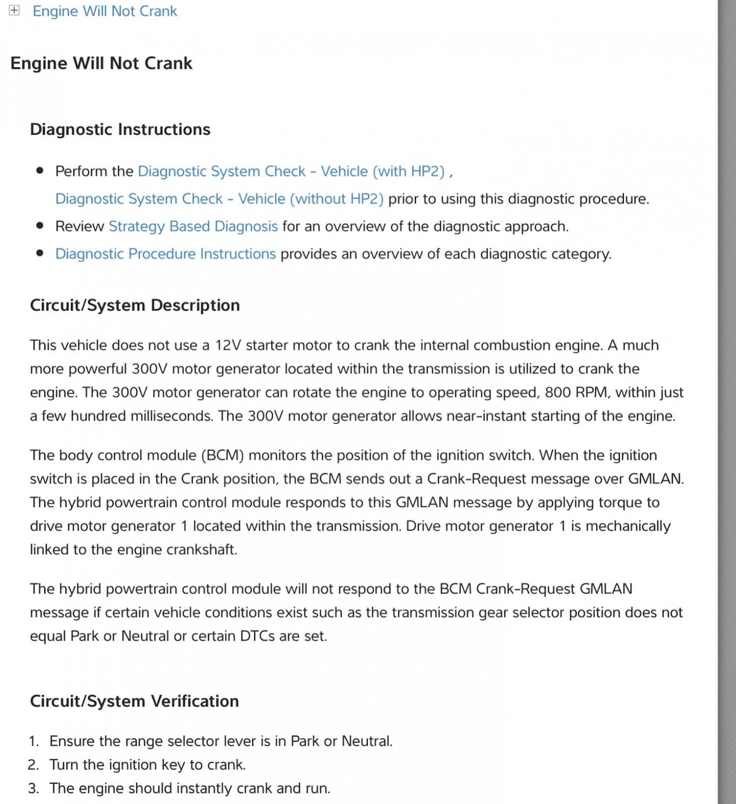

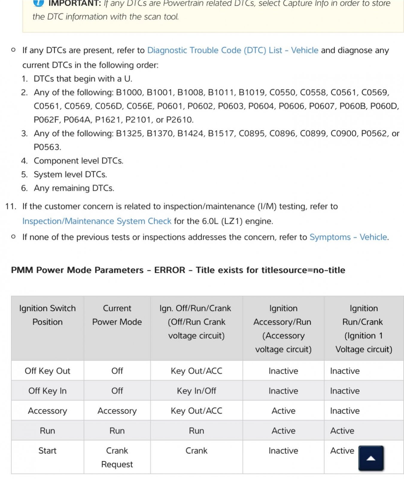

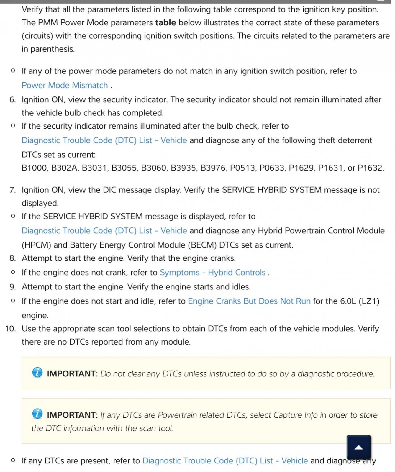

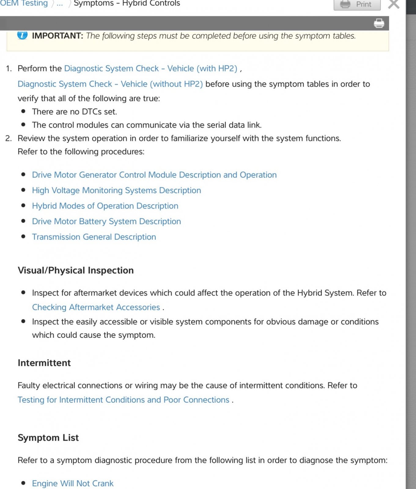

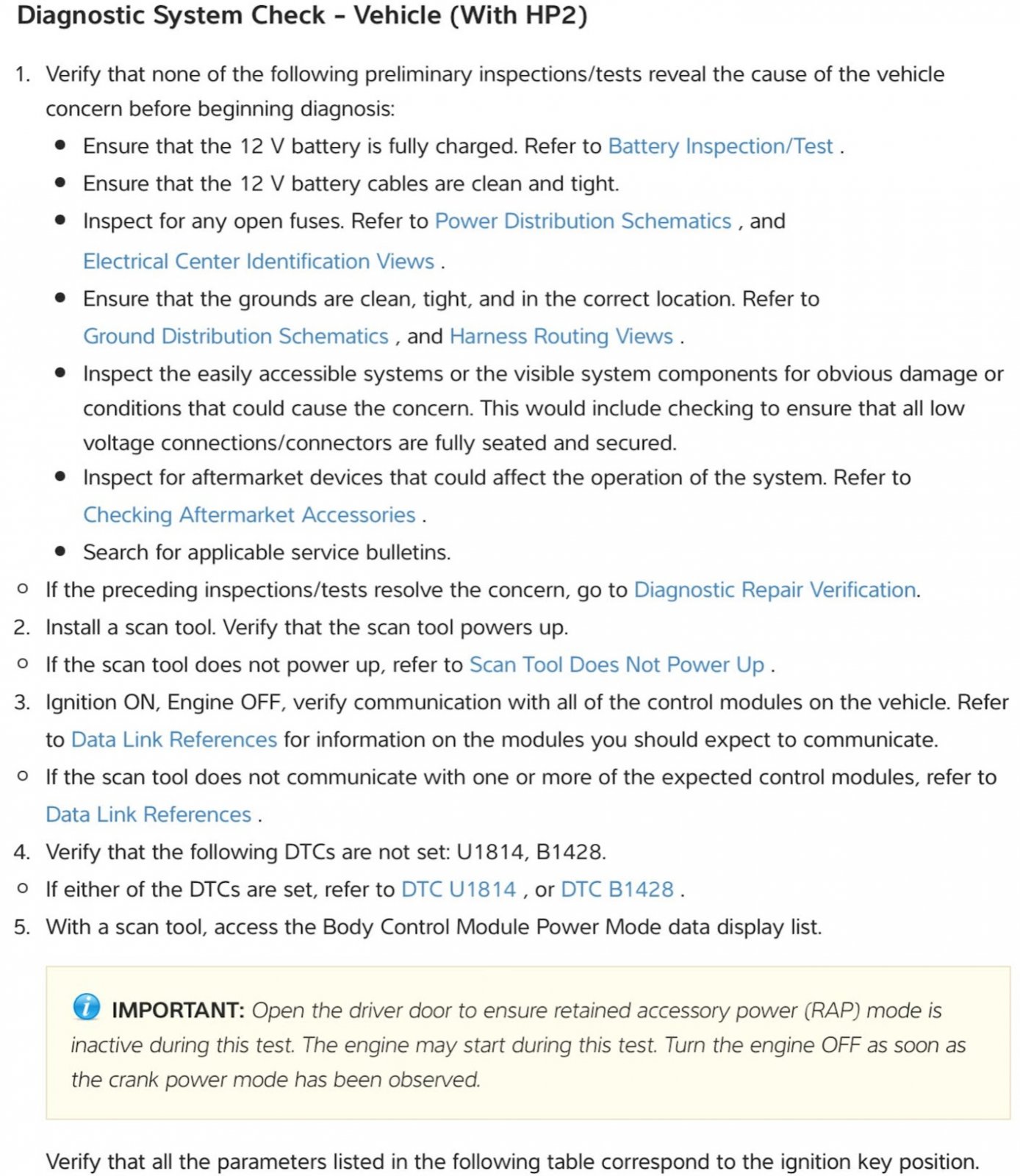

here's all I can find about no crank. no clue what order it's going to upload it from my phone but it should flow down to no crank, and then jump over to still no crank when there's a split link for cranks and doesn't start or no crank at all.

so that reminds me, I don't know how the caddy is, but does it have a light on the dash above each gear? if the light isn't on, that means there's no response from the tcm inside the tranny gear wise. it's a cable to the tranny but the tranny tells everything what's going on and lights up the gear indicator light. if that doesn't light the car won't start.
