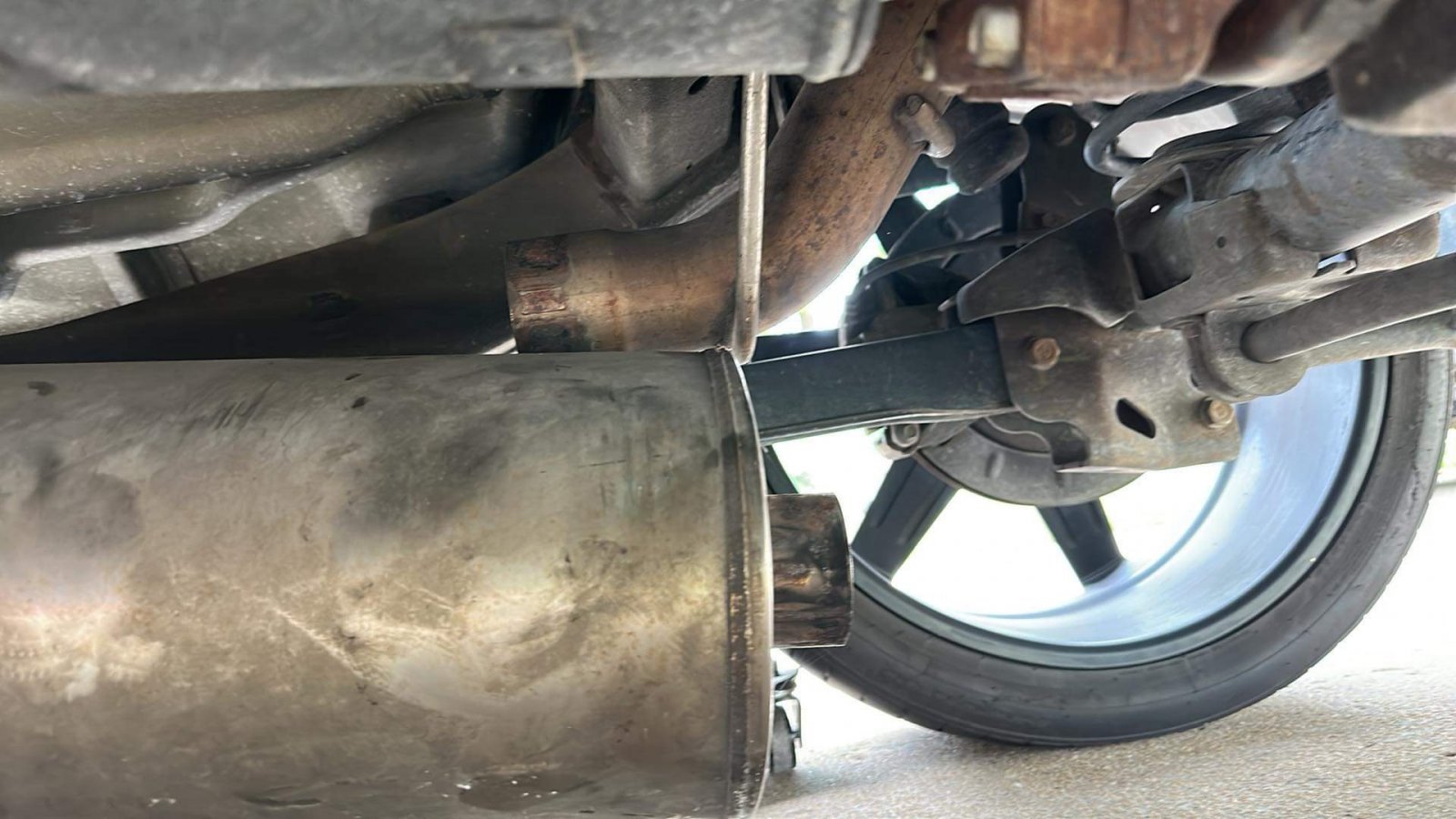

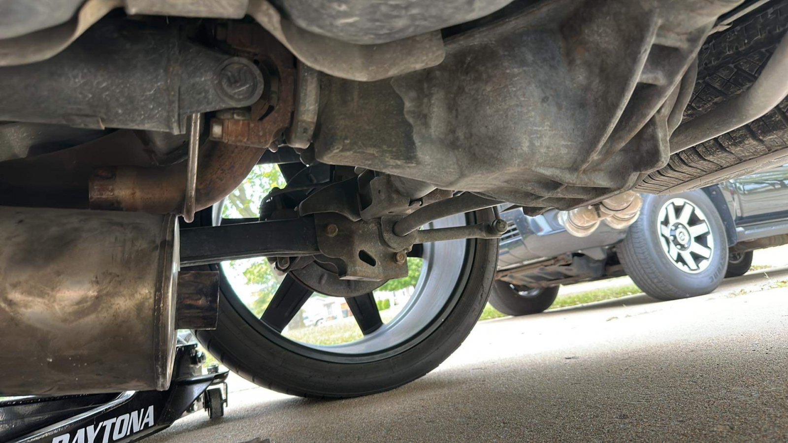

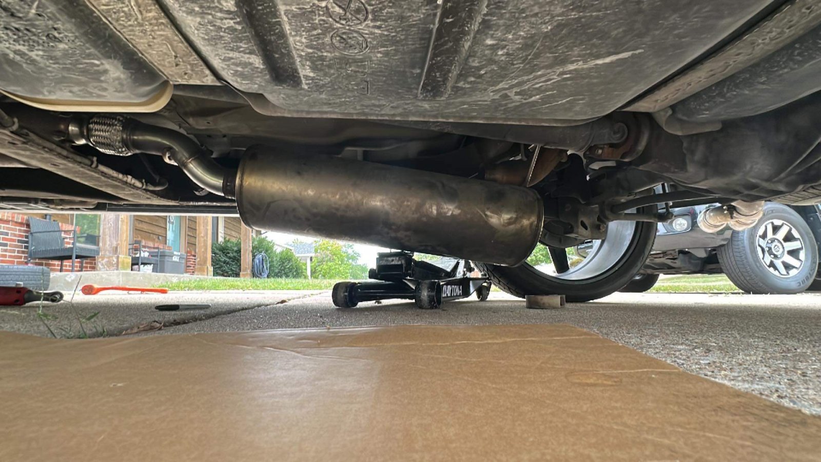

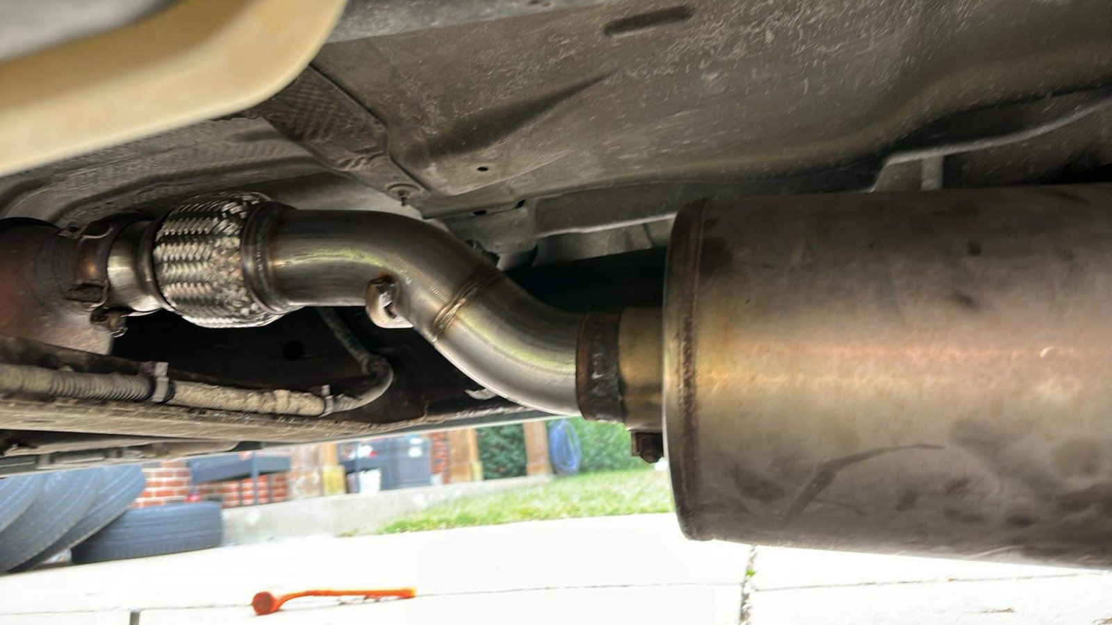

Wouldn't a muffler shop's labor to section out a piece and/or change the connection style be much cheaper?
Unfortunately it isn’t quite that easy. The muffler is SO long that the fore and aft pipes would have to be reworked entirely. Check out the pics

Unfortunately it isn’t quite that easy. The muffler is SO long that the fire and aft pipes would have to be reworked entirely. Check out the pics
All I can focus on is that orange hammer and who you want to beat with it LOL.
KidWgn
KidWgn
Certified Kid Hauler
Jan 11, 2023
427
601
St. Louis, MO
The ole Harbor Freight "I FKN TOLD YOU TO MOVE" whacker. As illustrated by the bent handle, it's done a lot of work :chair::rotflmao:
It was a serious roller coaster ride with this exhaust. I was actually looking for a Corsa airbox on FB Marketplace, and this popped up in KCMO, about 3.5 hours from me. I promised the wife BBQ if she made a road trip with me, and away we went. Guy was super nice, told me about how he put it on his wife's 08 and she hated how loud it was. I drove home STOKED.
When I removed my exhaust, I decided I didn't feel like ******* with dropping the whole rear end to get that pipe through, so i sawzall'd it just over the rear axle to easily slip it out in 2 pieces. It was only then that I realized that the fore-most flange was different. After asking around, I found out that in 09, GM added the 3rd cat to our trucks, so the flange changed to a ball-and-socket style. No biggie! I hit up Corsa, explained what I bought, and what was different, and that I was installing on a 2012 Tahoe. They said no problem, and sold me the "head pipe" (as they call it) for $179 +$19 shipping. Sweet! That still puts me into the exhaust for only $700 instead of $1600!
The day the new "head pipe" came in, I went to install it and realized I'd still be a tad long, so I trimmed an inch off the aft end of the "head pipe". Threw it in the hangers, got to the aft side of the muffler and went :wtf2:
So, now it's back up for sale, and I have half the stock exhaust back on the truck :Stupid Me:
