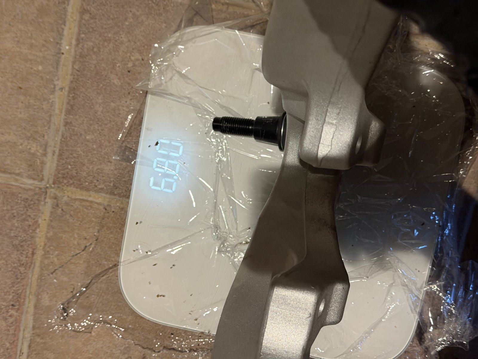

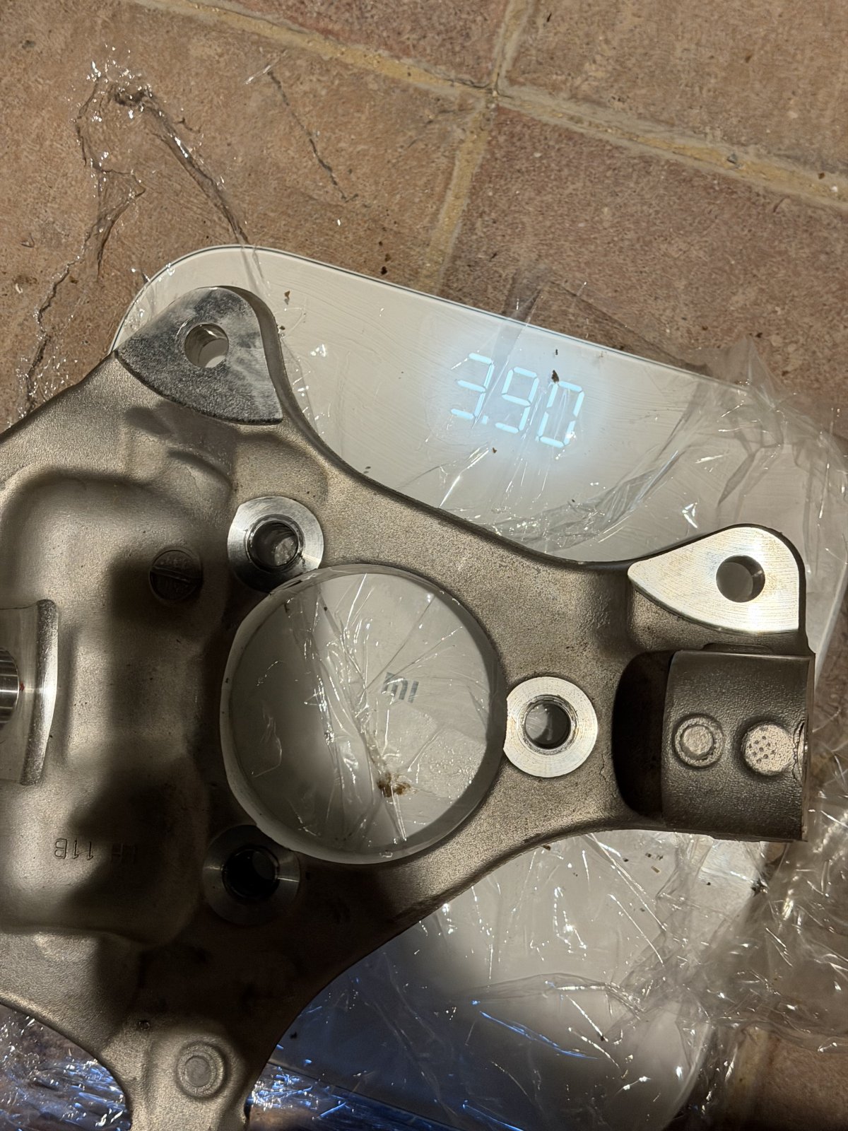

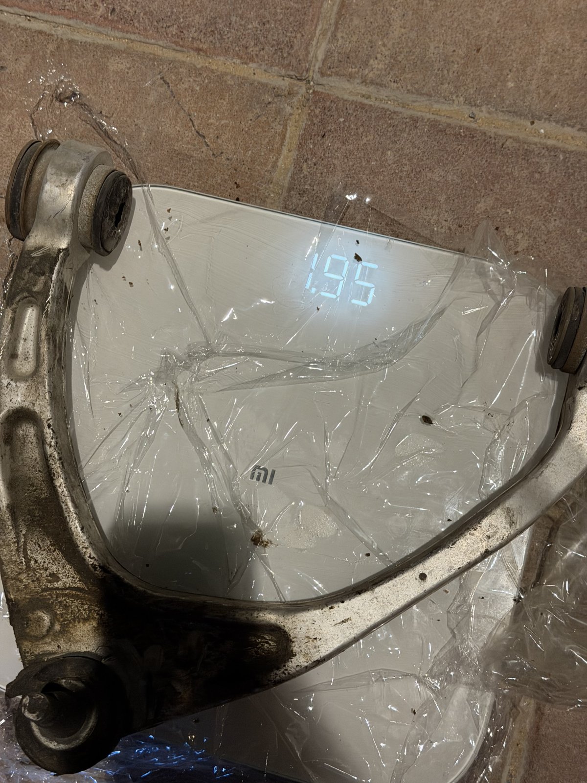

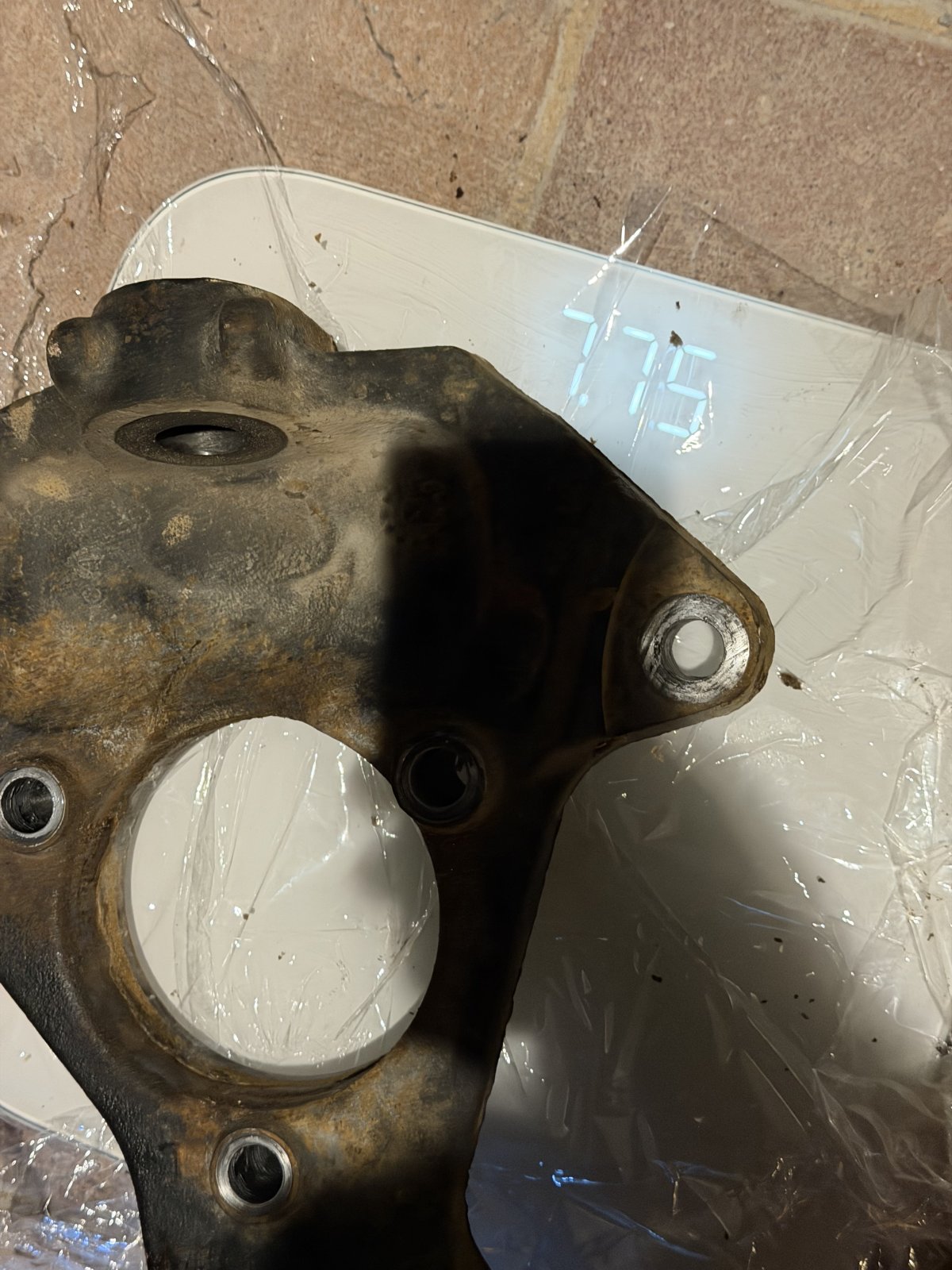

For reference, the car is 2013 Silverado single cab 4x4
Steel Upper control arm 3.1 kg
Steel knuckle 7.75 kg
Cast steel lower control arm 11.2 kg
Compared to aluminum suspension parts
Aluminum upper control arm 1.95 kg
Aluminum knuckle 3.9 kg
Aluminum lower control arm 6.8 kg
For your information I also compared the lowering lower control arm from IHC suspension for 2013 silverado
7.95 kg

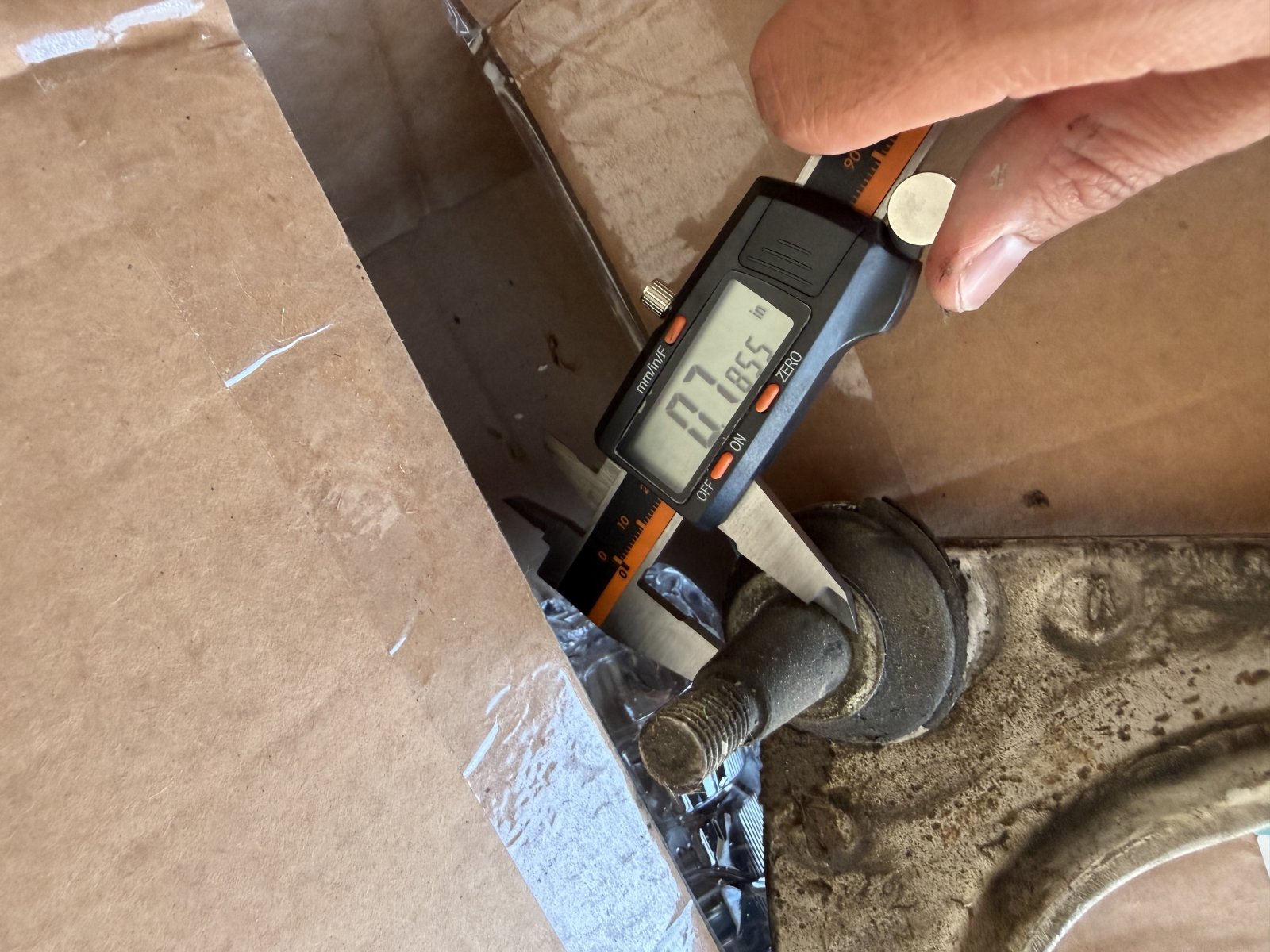

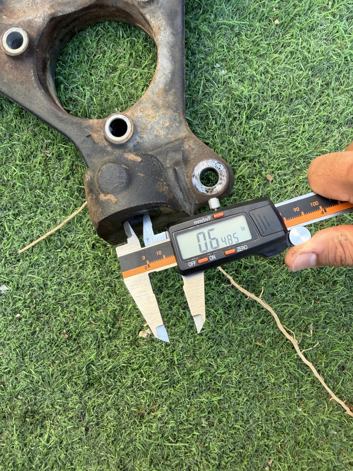

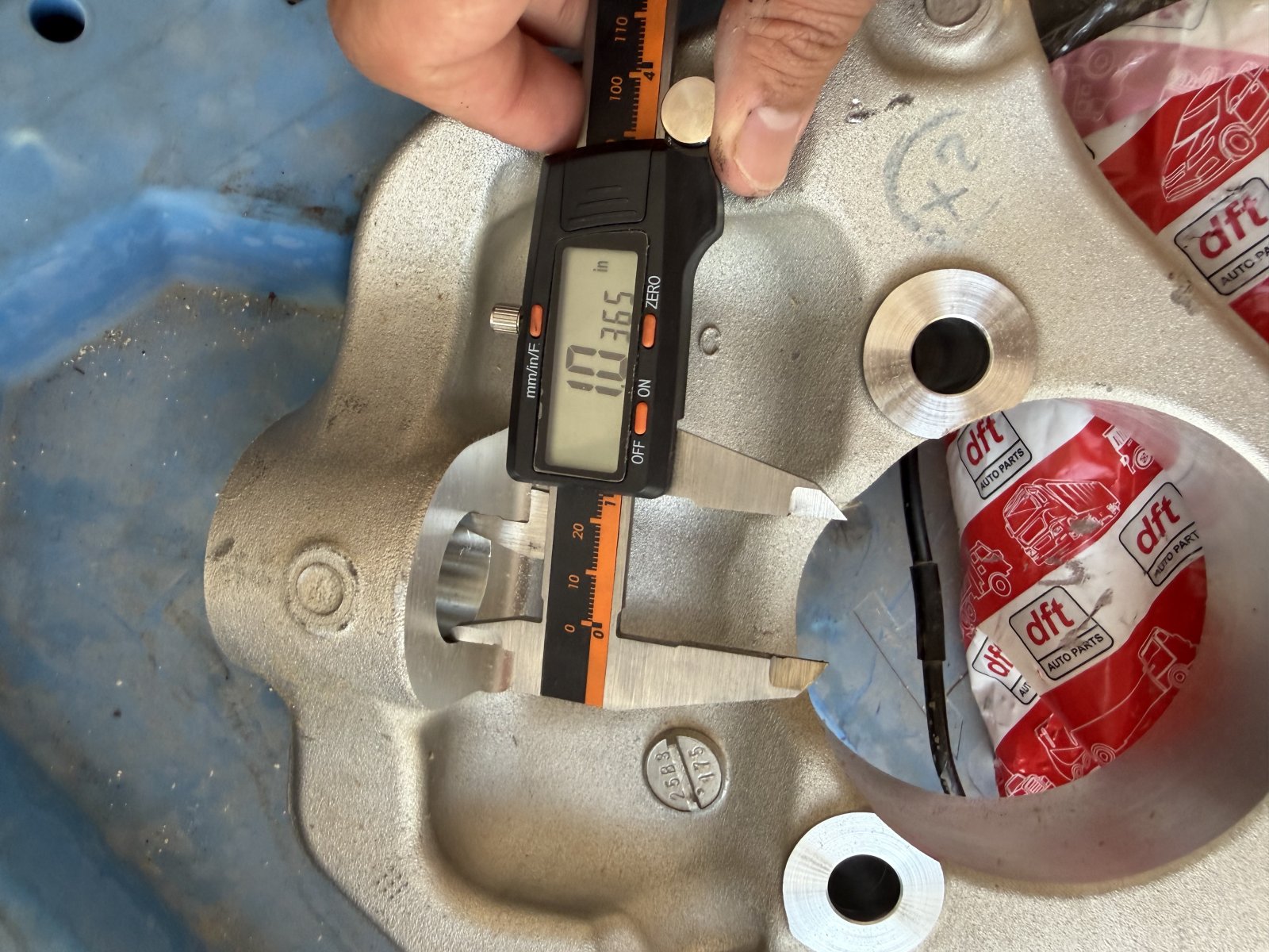

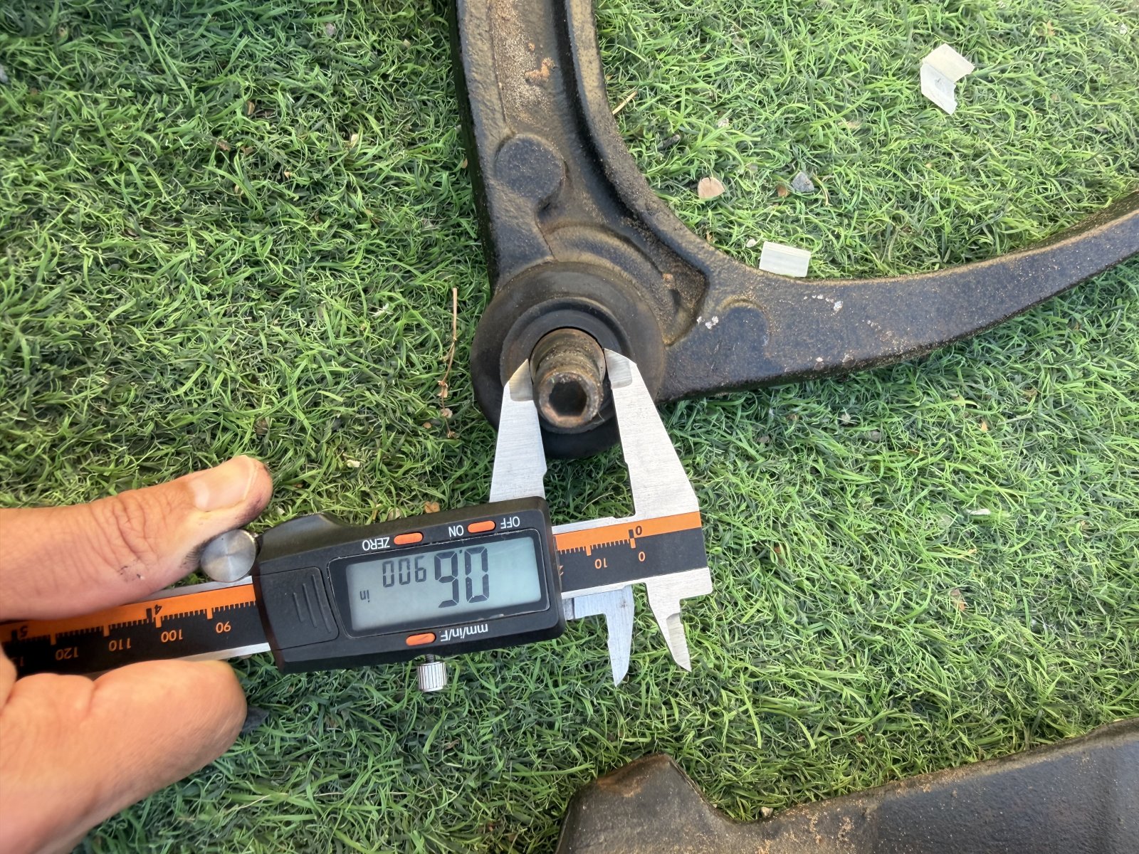

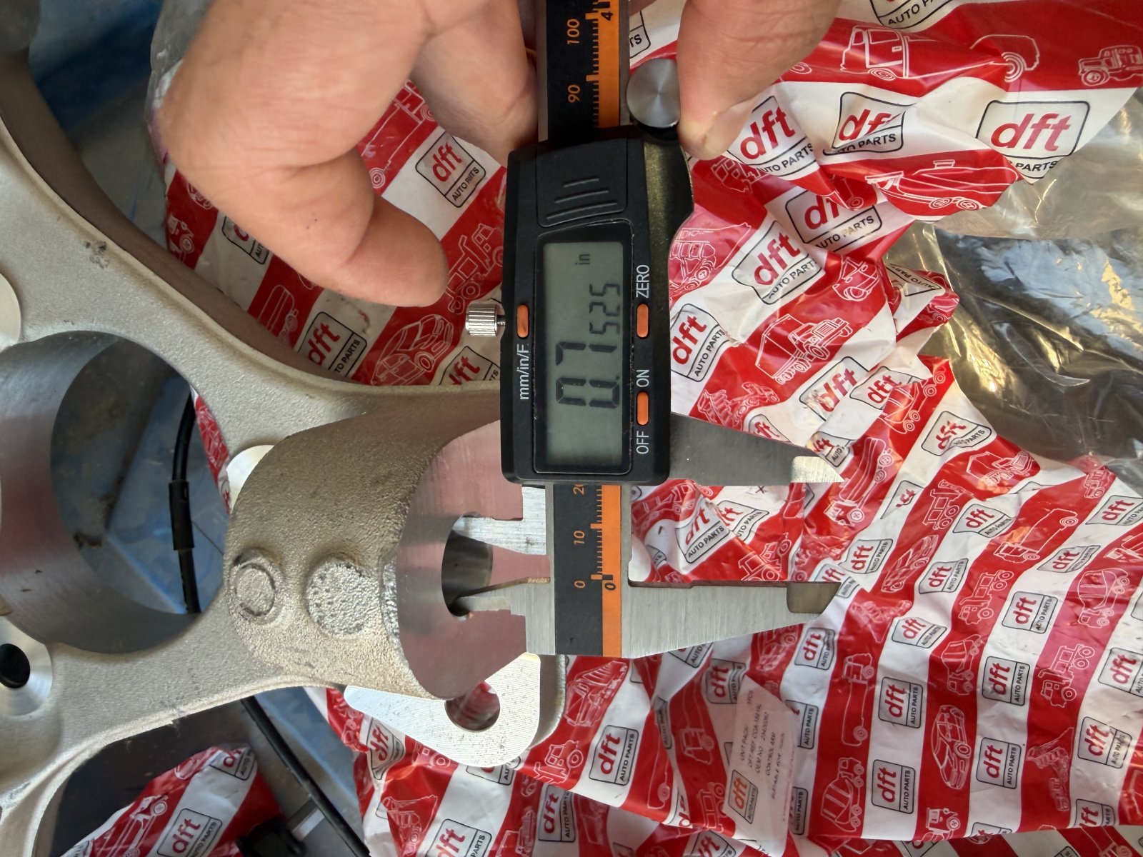

I checked the ball joints taper width as well as the holes in the knuckles to compare the aluminum and steel
Aluminum knuckle | upper control arm ball joint hole 0.75 in
Aluminum upper control arm ball joint width 0.79 in
Aluminum knuckle | lower control arm ball joint hole 1.04 in
Aluminum lower control arm ball joint width 1.06 in
Steel knuckle | upper control arm ball joint hole 0.65 in
Steel upper control arm ball joint width 0.69 in
Steel knuckle | lower control arm ball joint hole 0.87 in
Steel lower control arm ball joint width 0.90 in
Here i compared the tie rod holes on the knuckles
Aluminum 0.71 in
Steel 0.66 in
Tie rod for 2016 silverado electric rack and pinion 0.72 in

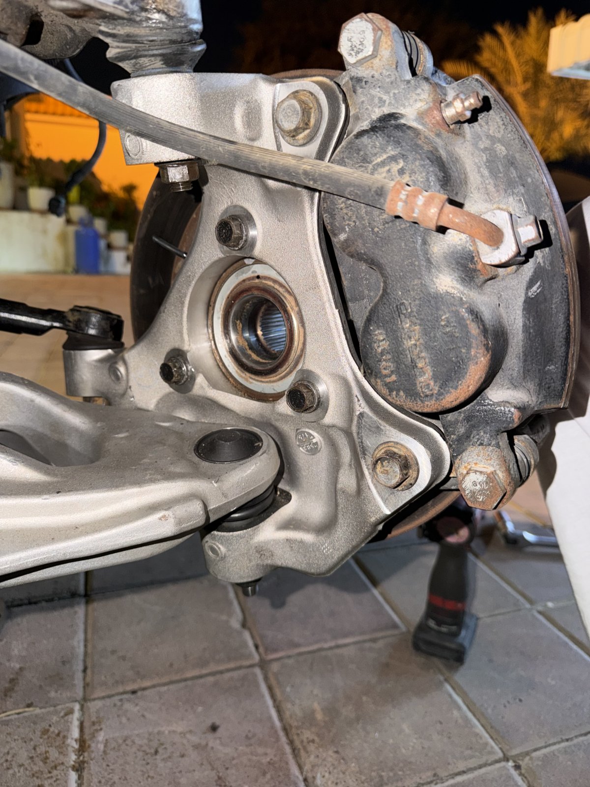

Use the provided data as needed. After checking the difference, I installed the aluminum suspension parts and they fit prefectly with no play
Everything bolts the same place, including the wheel hub bearing and brake calipers

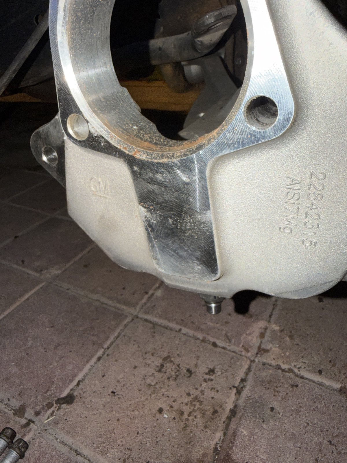

The problem i faced was with the brake dust cover, it was interfering with the aluminum hub causing the cover to bend and rub on the brake disk at the bottom
This is where it was interfering

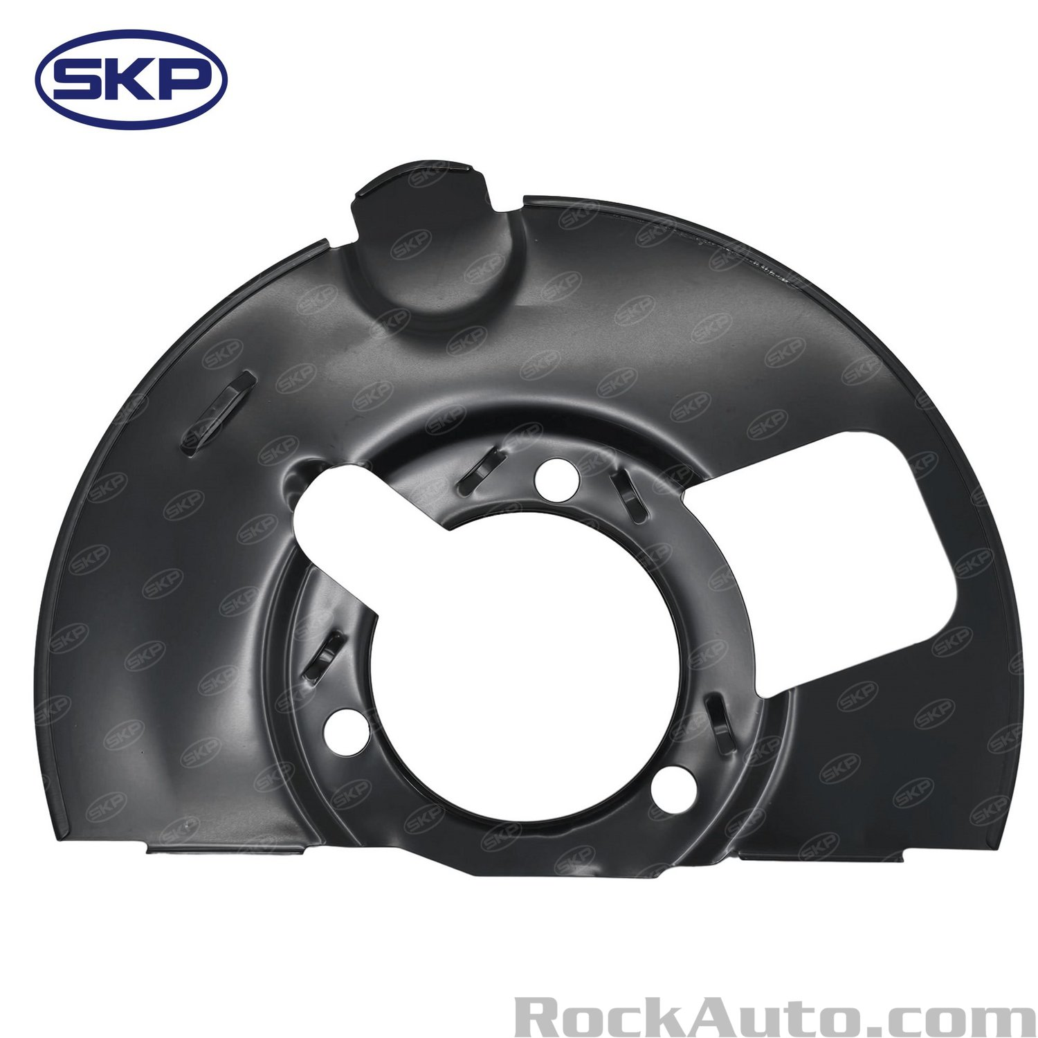

Thanks for the update, a quick check of RockAuto shows a cutout in the backing plate for the 2015 generation spindles:
The rotors also cross reference for the 07-20 so I would think this would clear that interference up.
