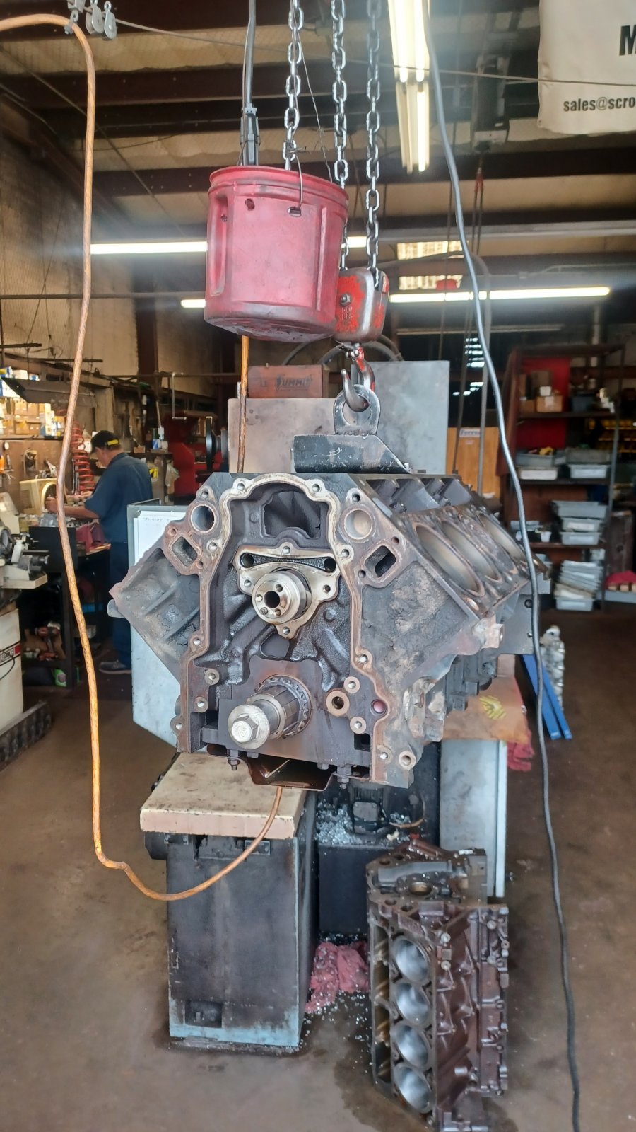

Dropped off the shortblock at machine shop this morning.

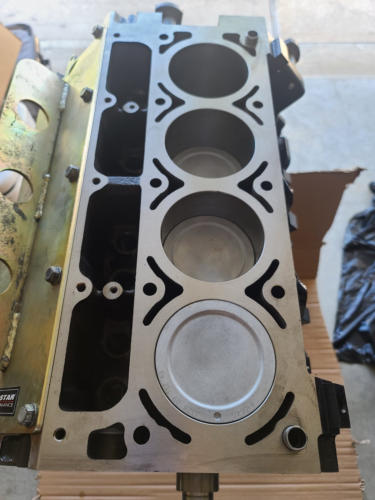

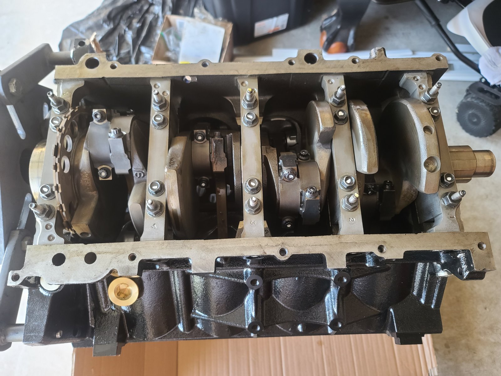

Figured I would used this thread. Got the block on the stand. Really pleased with the machine shop and their work. I used www.scrogginsmachine.com in Houston if anyone cares.

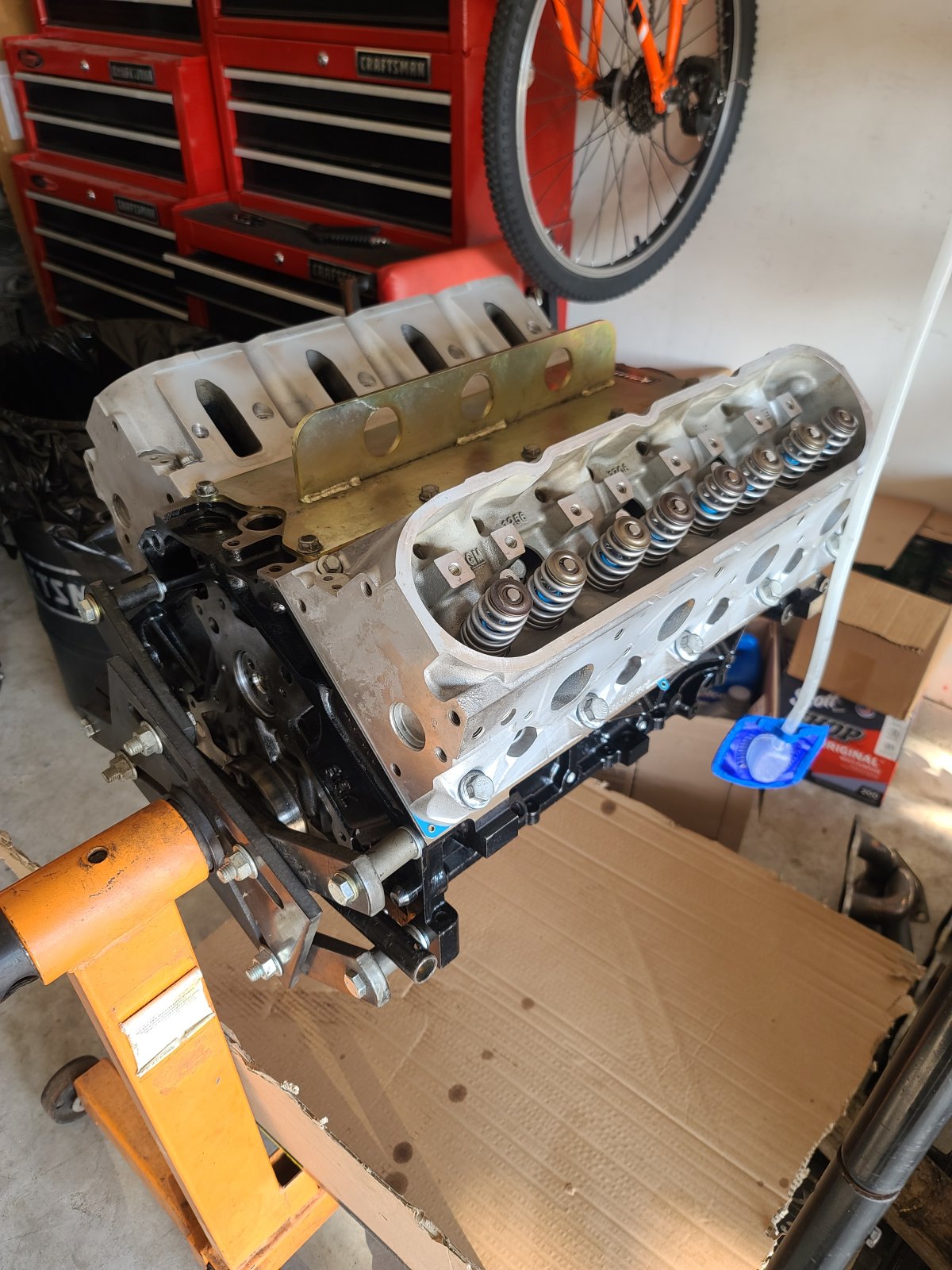

Just finished the torque sequence on the heads. Needs oil pump, timing set, oil pan and rear timing cover. May not get to drop it in tomorrow. Wife is traveling out of town and need time with her! Giggidy Giggidy goo!!

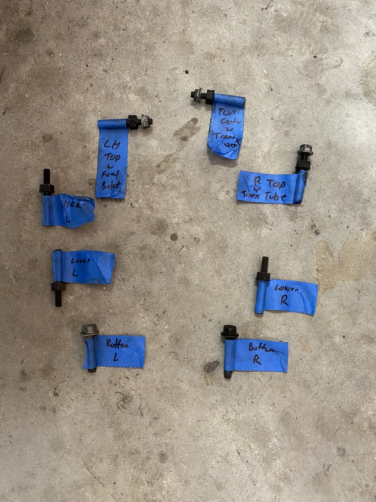

DOES anyone have a quick pick for reference of the studs that hold the bellhousing to the engine. I know my buddy disconnected all of that back there so I'm going in blind for the reassembly. Probably not difficult but a reference would be handy.
There are several grounds and wires hanging back there. Unless I'm over thinking it and they are just ground wires. I know the oil pressure and cam sensor connectors for sure .

This is from my '08/GenIV. But it's what I have:
IIRC, there aren't any grounds on any of these. The only ground back there that I can think of is the braided one from the firewall to the back of the left/driver side head. Yes, the labels are chicken scratch. I can decipher them if you need and if they're even relevant to your LM7.

Much appreciated!! This definitely helps but I was more interested in the wires hanging back there. Thing is my buddy worked on that back part and removed the bellhousing and I don't like the feeling of going in blind. Really I haven't taken a close look either so I may just be over thinking it.
