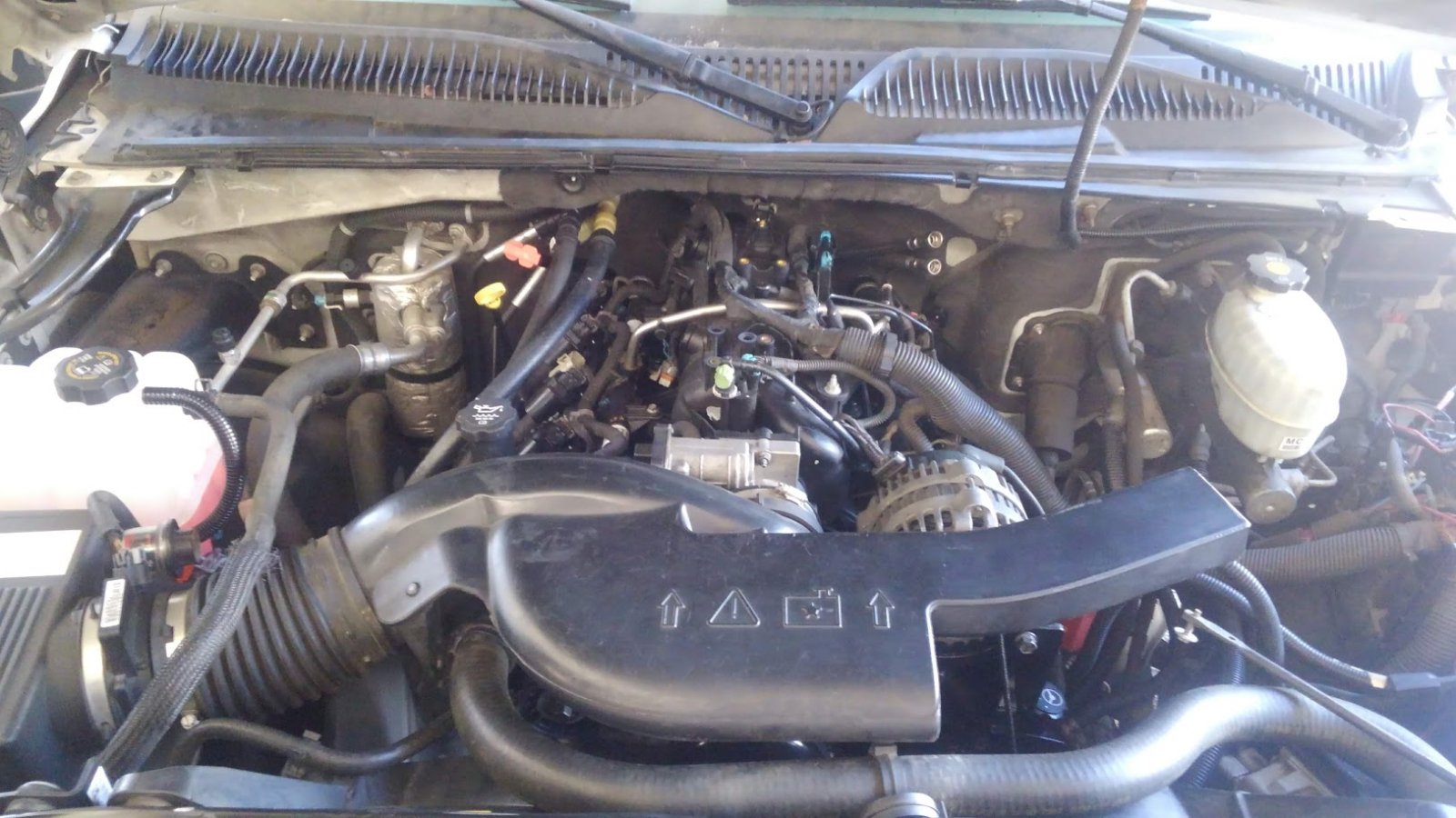

Picture for attention, nothing too exciting visually, just a typical engine compartment, but look at the cyl head casting # and that's where the excitement is. Fast fwd 3 months and it's all back together and in the Tahoe now.
I have everything put back together, no extra leftover parts or hardware that I can't remember where they go so that is good. Put a battery in and turn the key and it does turn over without starting, since the fuel pump relay is pulled and the coil packs disconnected(verifying oil pressure prior to starting it). But.....
Houston there might be a problem. The key fob works to lock and unlock the doors, the stereo works, the interior lights work, but the gauge cluster is only lighting up the Check Engine Light, nothing else. I have no odometer display, no gauge movement(no gauge motor sound audible when it goes key on). The only thing illuminated on the cluster is the Check Engine Light. This engine swap process from start to finish has taken me most of a year. Battery was out of the rig and computer disconnected since the teardown.
I seem to remember reading about a possible loss of memory on the factory anti-theft, but I can't find that info or thread that I previously read now. Is that what I am experiencing here? Thanks in advance for any pointers.engine.JPG
I seem to remember reading about a possible loss of memory on the factory anti-theft, but I can't find that info or thread that I previously read now. Is that what I am experiencing here? Thanks in advance for any pointers.View attachment 381722
Most likely a cluster problem, they’re a known issue for this platform. Any wrecking yards nearby that you can buy one from? They’re not too expensive unless you opt for a rebuilt one but for testing purposes it might be worth the money to buy one from a wrecked truck. Or if you know anybody else that has a NBS GM truck you can borrow theirs for a test.
