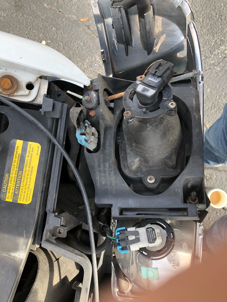

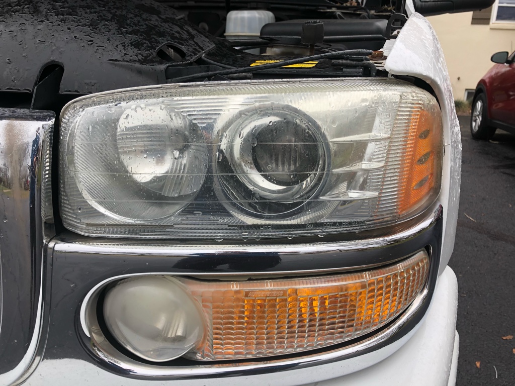

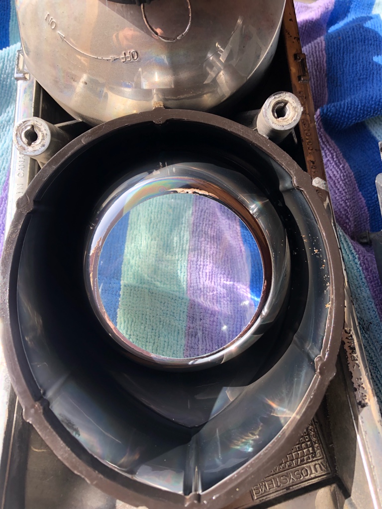

My low beams are very dim. Today was the day to take them apart, clean them, and install new bulbs.
A couple pictures of the assembly’s
I’m worried about the flaking mirror material looking down inside the light
Is this what’s causing my problems.
26,678
52,943
If the chrome is flaking off the inside of your projectors, your lights won’t work well at all.

I wouldn’t suggest painting the reflector part of any headlight, projector or regular reflector. In projectors especially the quality of the reflector bowl is directly related to the quality of the output. You want something as close to a mirror as possible with the least flaws. There’s no paint that will do that.

Noted.
