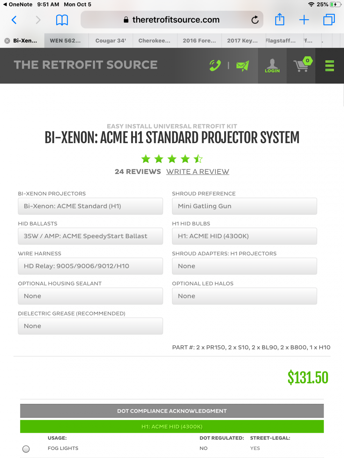

Is this what I need from retro fit?
52,949
This is a low beam only, pretty sure
The acme supers H1 is a low and high beam.
Also you can put whatever his system you want, doesn’t have to be acme.
But yes this will fit
I didn’t realize Acme sold a low-beam only H1. It seems that wouldn’t be desirable by anybody. Might as well have a shutter.
I stand corrected , says right there it’s a bi-xenon. I haven’t shopped them in awhile. I know at some point the standard was just a low beam pattern. So never mind these do have a high/low function built in. make sure as soon as you get them plug in the high beam solenoid and test the shutter functions at least 50x before installing

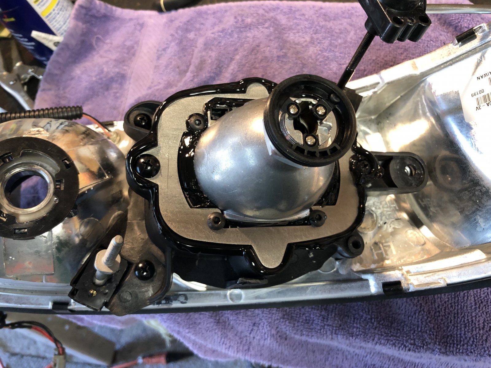

The Morimoto Mini H1’s have amazing output, you’ll be super happy. The adapter plates make it a super easy job, normally you have to bake open a headlight assembly in order to do a true retrofit like this. This way everything just screws in from the back. And you can buy the pigtails already assembled from TRS so you don’t need to do any soldering. I did this exact same thing to some new Anzo U-Bar projectors for my 02 Denali, came out super nice. I did a write-up over at GMFS.com that got very little attention which I don’t understand but then those guys are all pretty much di*ks.

Also the fact that the brackets line the projector up exactly horizontally, where normally without the brackets you have to put the headlight on the truck then align the light rotation output and hope when you take it off to secure that position it doesn’t mess up the alignment.

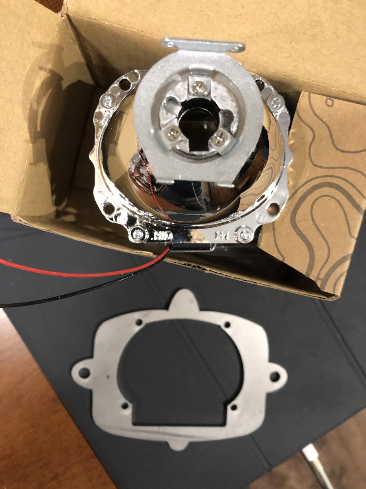

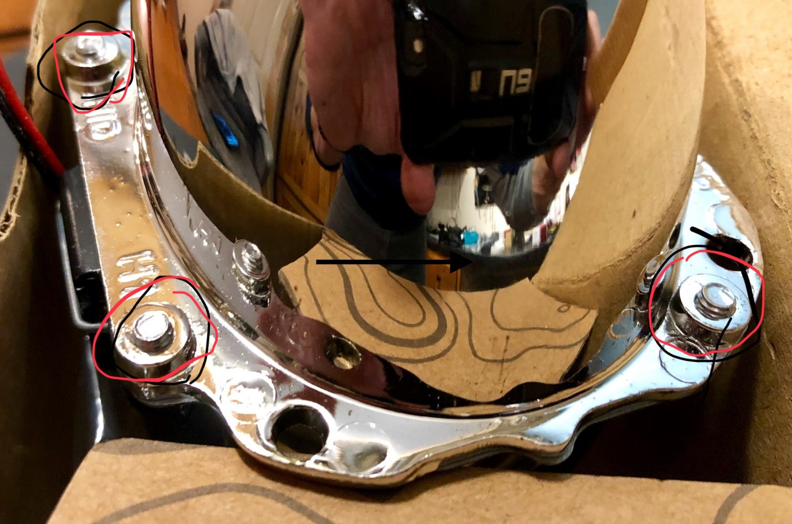

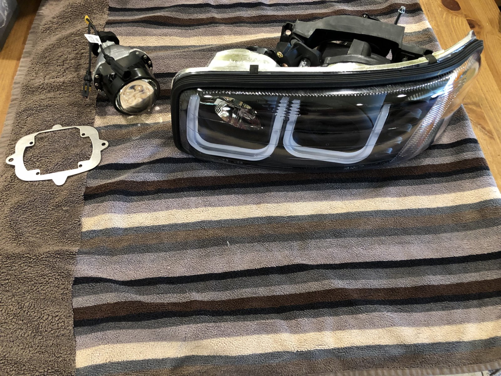

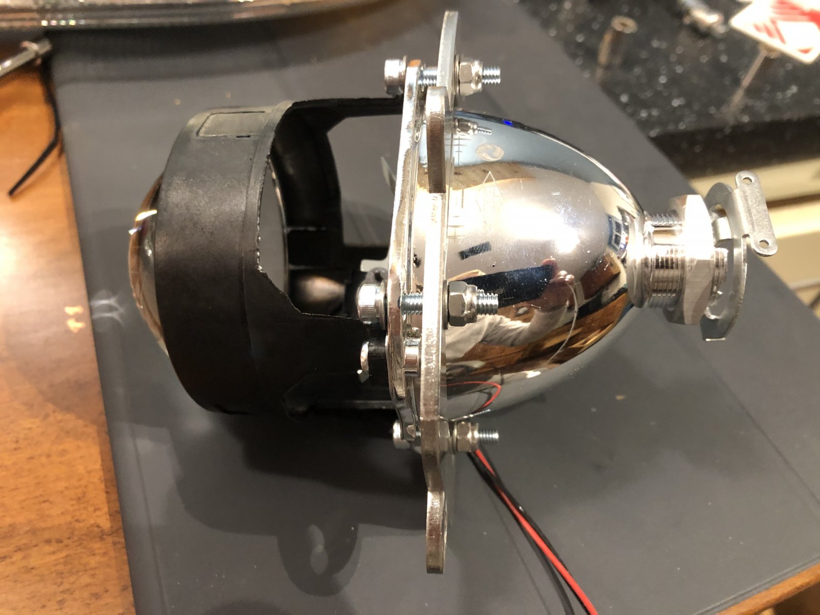

Well today I started the project. Figured I’d first try to install the TRS acme lights in my 04 Denali. Got things apart and got to the point of installing the acme hids. Seems that my cb&d brackets may have an issue with the acme lights. The lights will not lay flat on the brackets due to the screws that’s hold the lenses in place
Any suggestions? I was under the impression that the acme had the same footprint as the mh1s? 5EB97509-1AE9-458F-9DCD-B0E723F2DFAF.jpeg
52,949

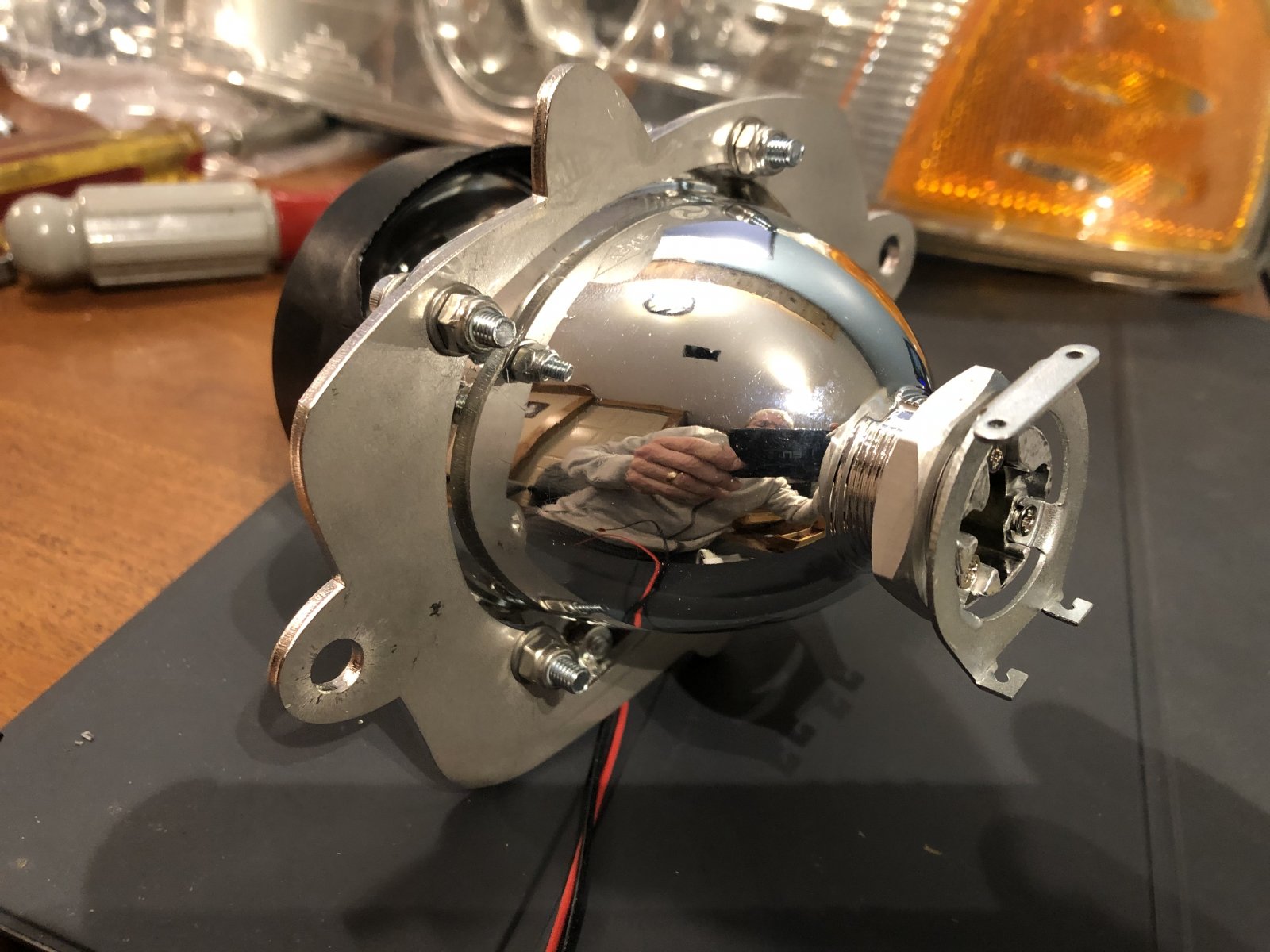

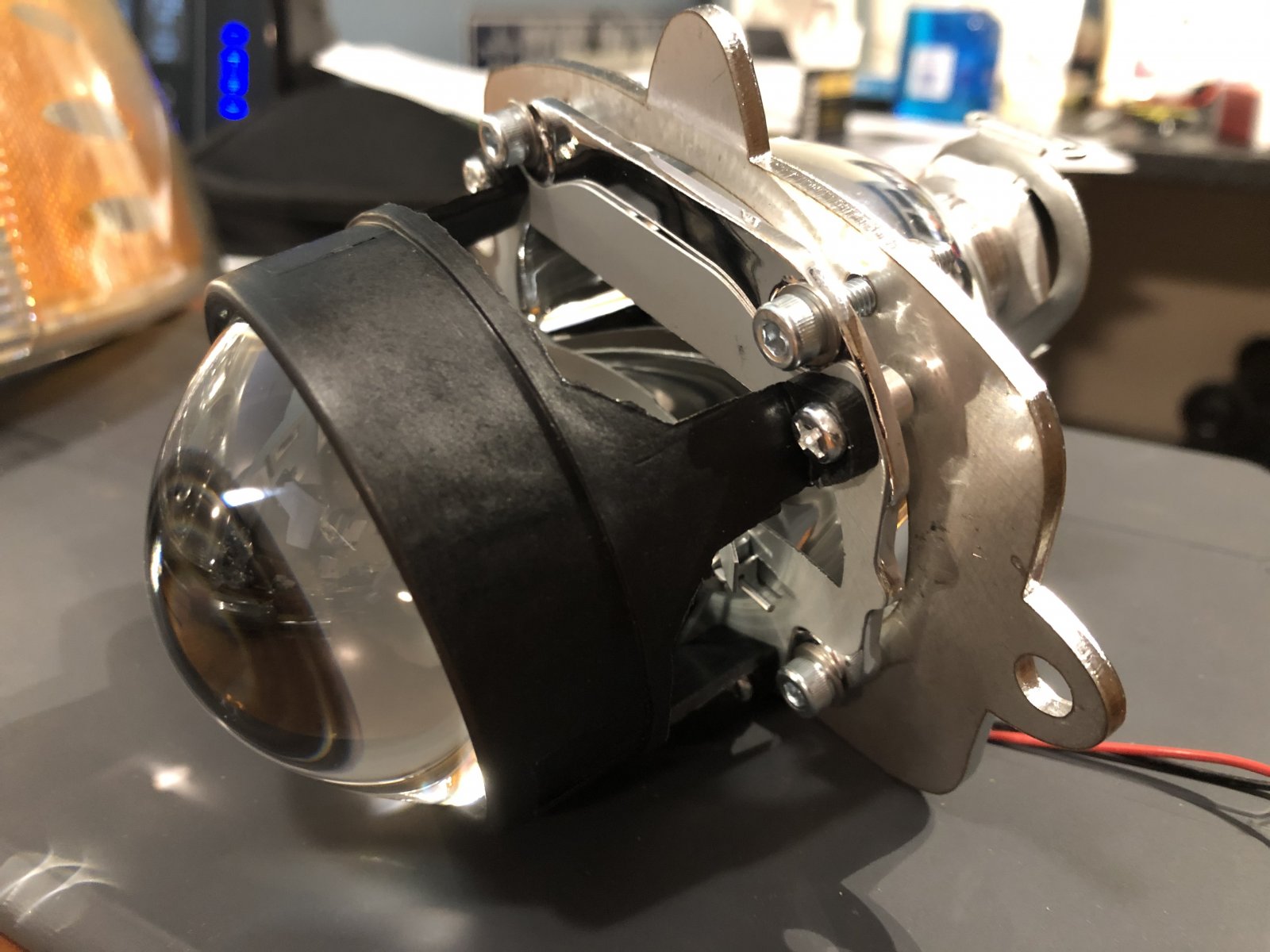

I don't think those are going to work. I know the brackets I bought are advertised as being designed for the Moromoto's. They look slightly different than those but regardless, it doesn't look like those are going to work for the Acme's. Here's the brackets I bought, and the mini H1's. You can see the difference in the projectors between mine and yours and in the first pic you can see they're cut out specifically for the Moromoto's.

I don't think those are going to work. I know the brackets I bought are advertised as being designed for the Moromoto's. They look slightly different than those but regardless, it doesn't look like those are going to work for the Acme's. Here's the brackets I bought, and the mini H1's. You can see the difference in the projectors between mine and yours and in the first pic you can see they're cut out specifically for the Moromoto's.View attachment 261552 View attachment 261553
I’m going to make them work. Mounting holes are perfect so I’m going to dremmel the mounts until things fit flat then just a bit of silicone should fix the small hole that will be remaining.
