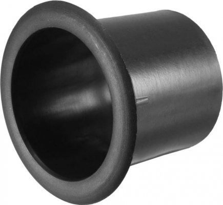

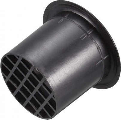

one of these days I am going to figure out how to make some air vents like these work, just need some "free" time
maybe feed the air in from around the tow hooks or something

I used sub ports when I built mine. not in the yukon but other car. they look nice in a flat surface, come in different sizes. I couldn't run 3in all the way like race car stuff, 2.5in fit nicely and they have a grid to block leaves and trash for street/highway driving.
worked pretty good. still over heated the pads in track but took a few laps longer. I need to bit the bullet and go with straight race pads and just swap them at the track. high temp street pads couldn't handle it.
