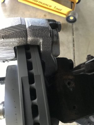

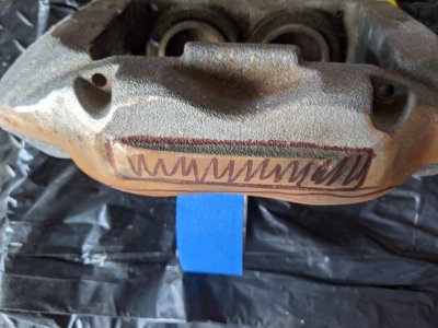

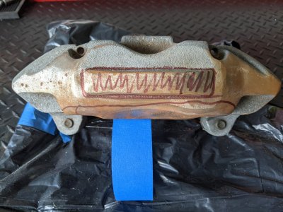

Here is the '19 silverado caliper I bought last year for R&D. Hit it with a 40 grit flapper wheel to clearance it to fit

So if I drop ship a set to you, you can shave, smooth and powder coat them for me?
That would be awesome. What would be your price on that?
I could do that yes. Let me get the price on powder and supplies and we can go from there

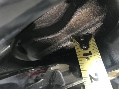

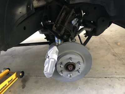

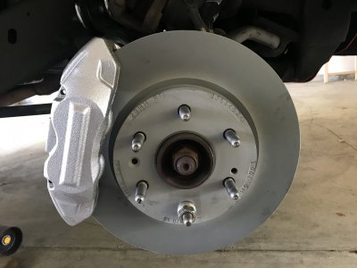

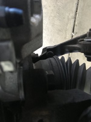

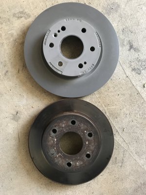

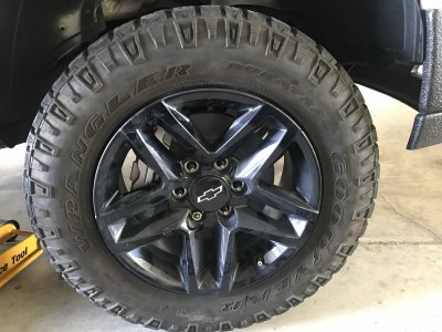

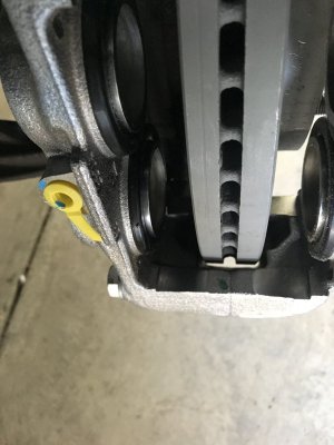

Since nobody here has popped these on yet I decided to test fit the calipers on my 03 Tahoe.
I suspected my Z71 wheels wouldn't fit and needed a test wheel with a high probability of success.

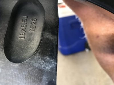

So I finally convinced this guy who sells wheels on craigslist to let me borrow one of his 19+ Silverado wheels...18x8.5 26 offset.
Sellers on Craigslist are so untrusting....did he think I was going to steal one wheel from him? I had to give him $40...Sheesh

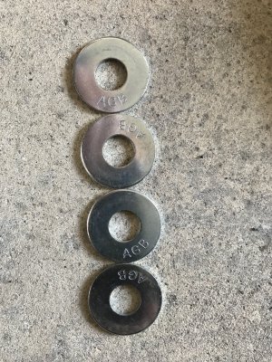

So, Rotor and caliper went on easy peasy.....used (2) 1/2 washers from home depot code AGB for spacers on top bolt and bottom.
25 cents each, no stainless or hardened available. I recommend hardened. With the two washers it lined up the caliper perfectly over the rotor.
Here are the pictures.
03 Z71 did not clear the caliper and didn't have a spacer to check. It did clear the barrel so a small spacer will work.
19 Silverado wheel worked with 1/2 inch clearance....see pics. I suspect any wheel that came on 19+ silverado will work or any aftermarket wheel that fits a
19+ Silverado without needing a spacer will work.
My 19 Suburban RST 22 inch wheel cleared easy. But I'm not putting 22s on my Tahoe.
Here are the PICs

Yes, any wheel from a T1 which is: 19+ Silverado or Sierra or 21+ Tahoe, Suburban, Yukon, or Escalade will clear these brakes (even the 17” steelies) as they all come with these brakes. Some of the K2 20” wheels will work but I don’t think any of the 22” wheels will work because they’re all pretty concave. I doubt any 800 or 900 wheels will clear.
