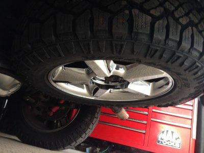

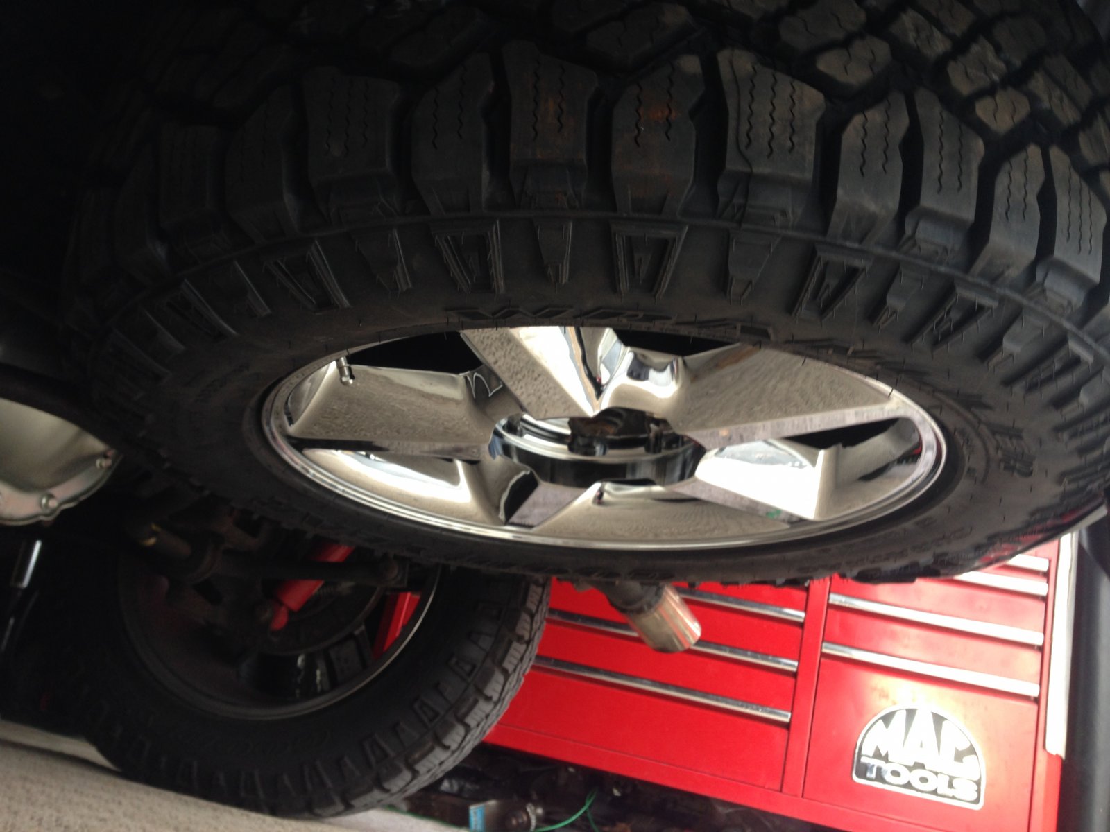

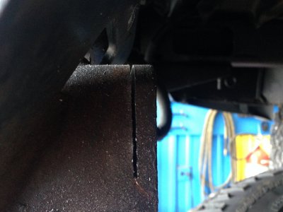

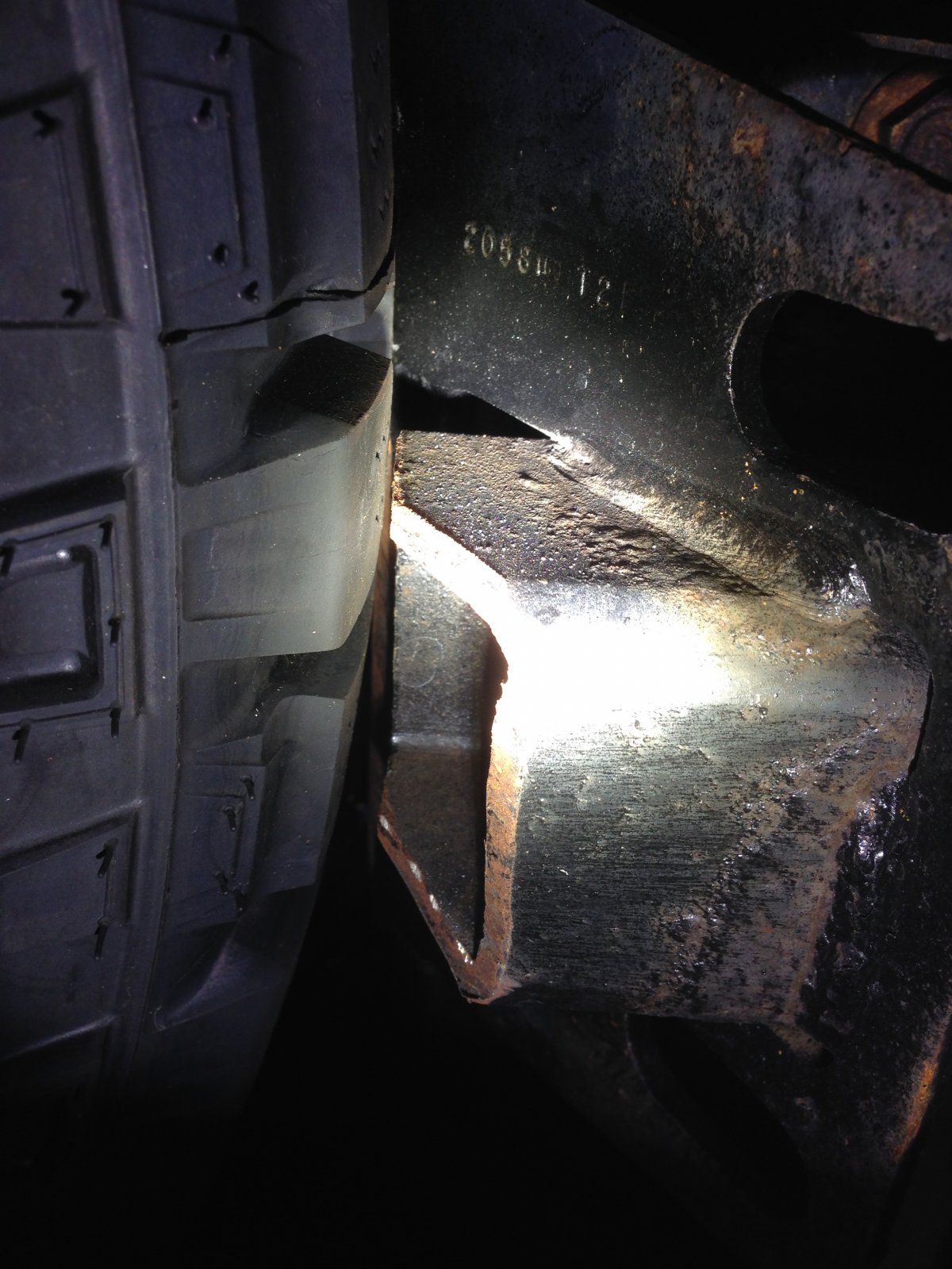

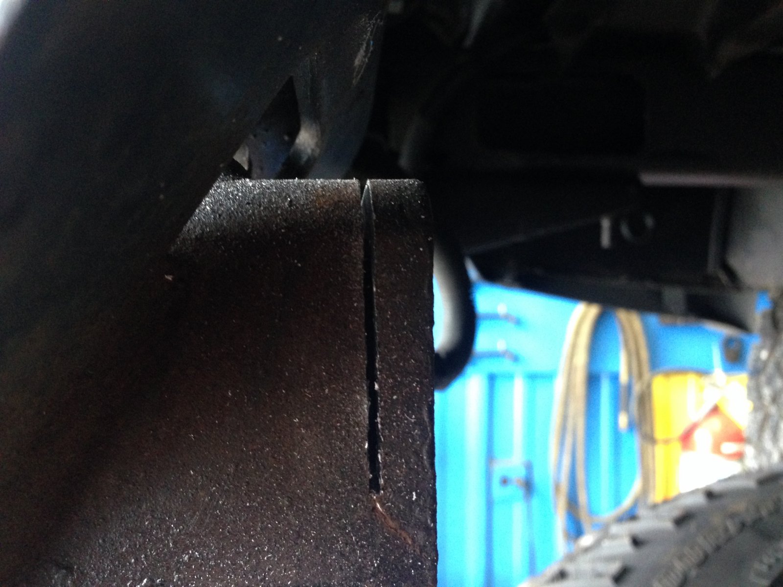

I no a 33 inch goodyear duratrac will fit but you have to cut the rear of the hitch receiver just a tad.Its tight but does fit.I made 2 cuts one shown and then an angled one for easy up with the hoist so it falls in.
