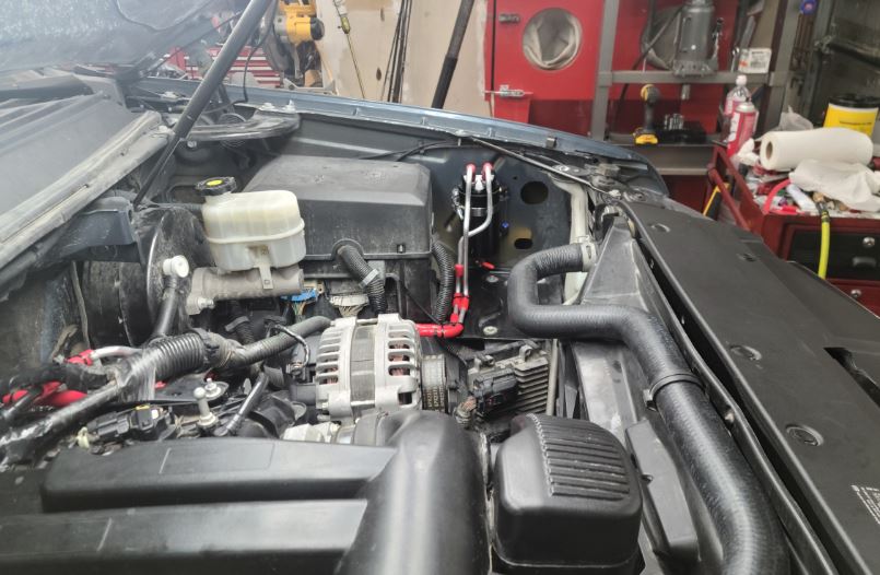

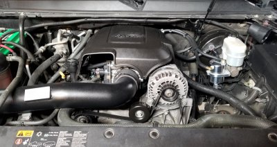

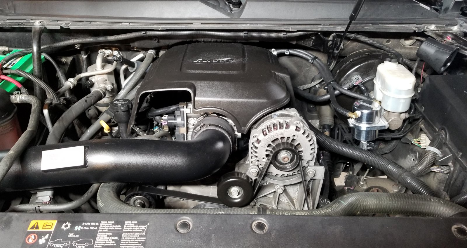

You can see mine in my sig pic. I backed out one of the alternator bolts, slipped it through the hole in the catch can bracket, then reinstalled it. The can isn't in the way of working on anything else, is easy to reach from the side and has plenty of room underneath the hold a cup to catch the drainage.

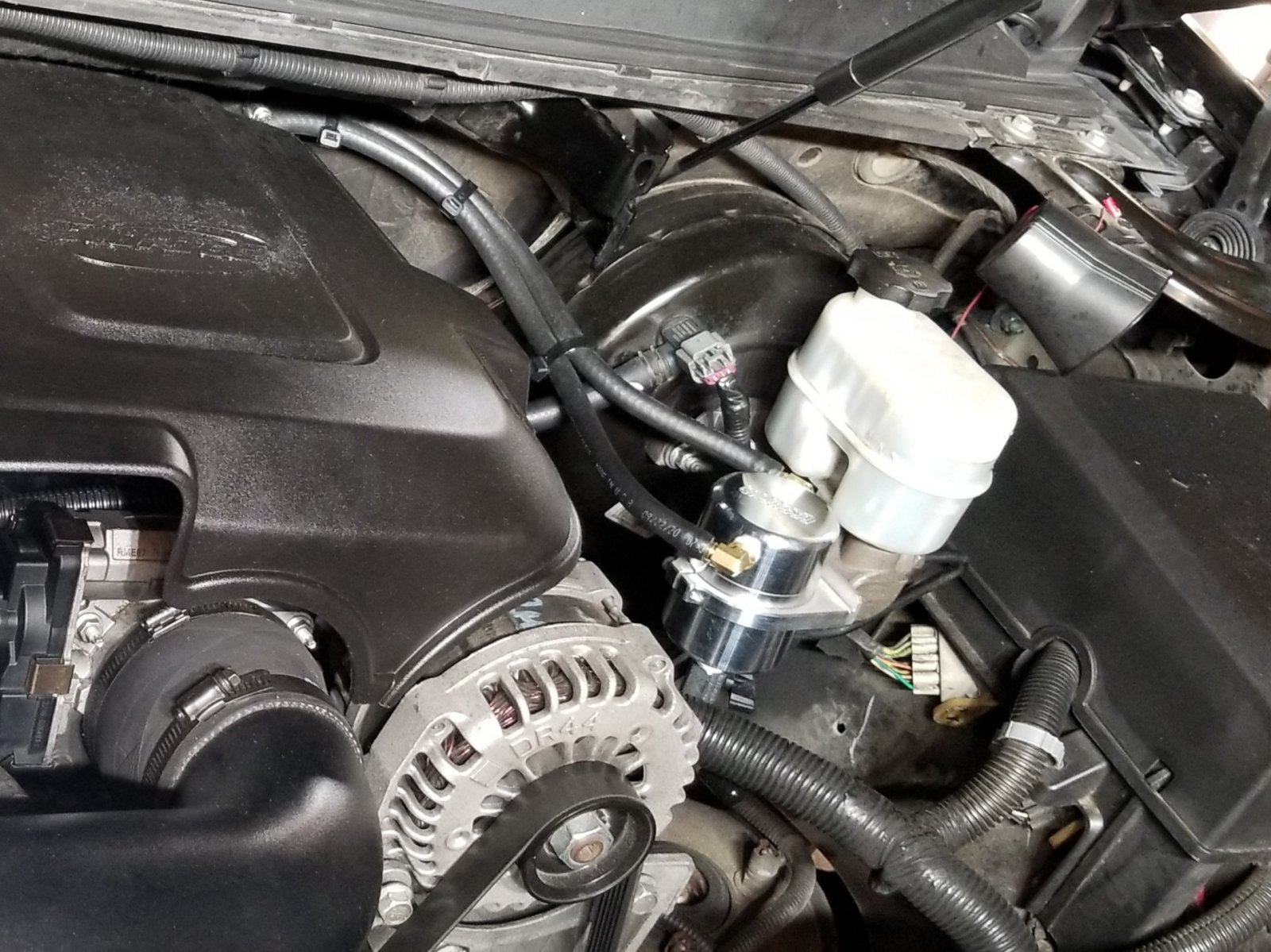

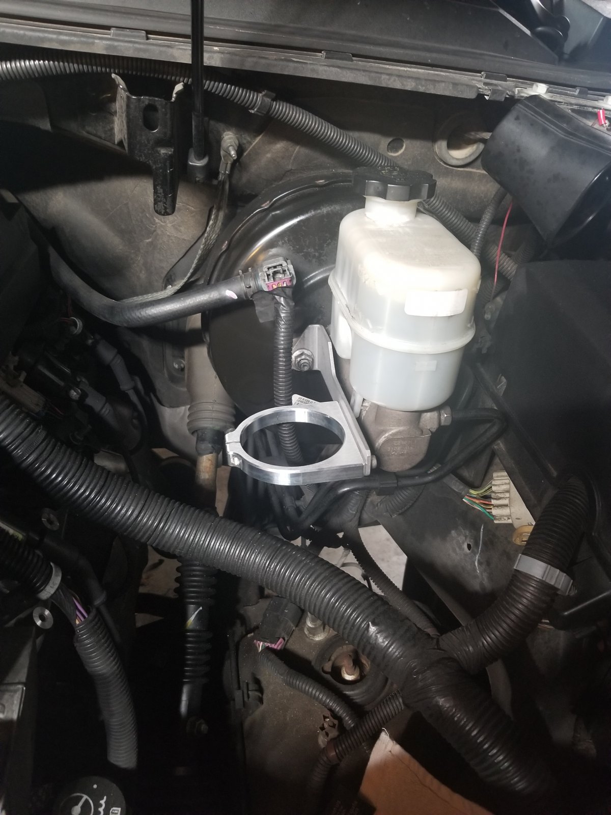

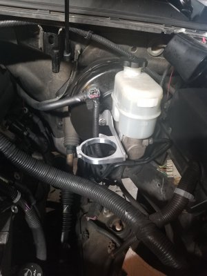

The one I put on my brother's truck was one from Amazon and it didn't have a bracket, either. I made a simple one out of a piece of 1.25"x.125" flat bar to mount in the same way as the one on my Tahoe.

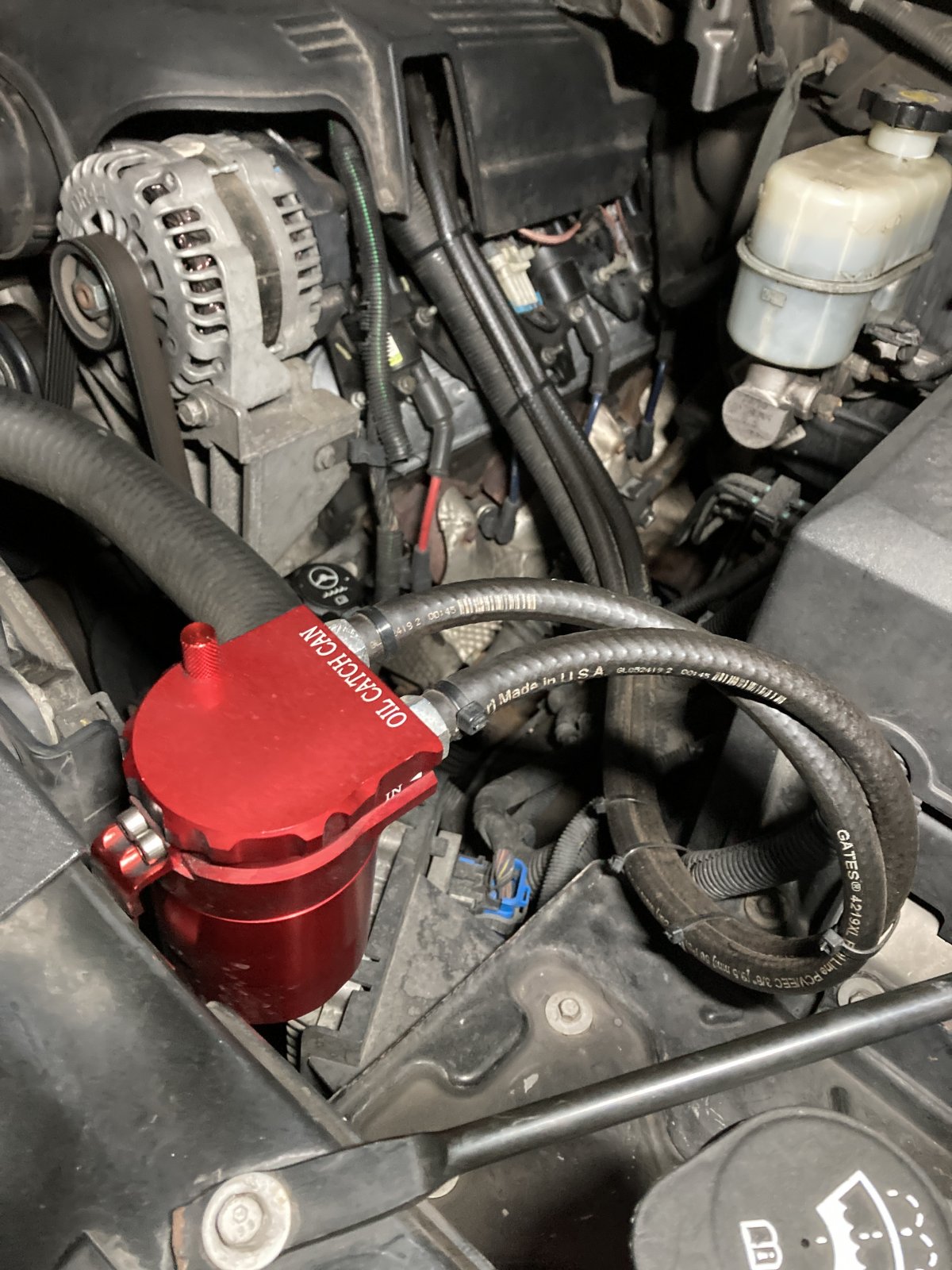

Generally speaking, I think best practices would say avoid using heater hose, in applications that involve hydrocarbons.
Another thing to consider is this application is under a relative vacuum, so a thick walled fuel supply style of hose may help in assuring the line doesn’t collapse under vacuum, especially as it ages. The runs to and from the catch can will probably end up being pretty long.
The OEM line that runs between the PCV and the intake manifold is plastic hardline for most of its length, with only the ends being rubber hose to make the junctions (very short runs).
If it were me, I would use a nice sturdy 3/8 fuel supply hose and update the fittings on the catch can to support that hose.
Having said all that, as long as you keep an eye on the hose and make sure it isn’t collapsing on you under vacuum, the rest might qualify as dancing on the head of a pin stuff.
Best of luck, whatever direction you choose.

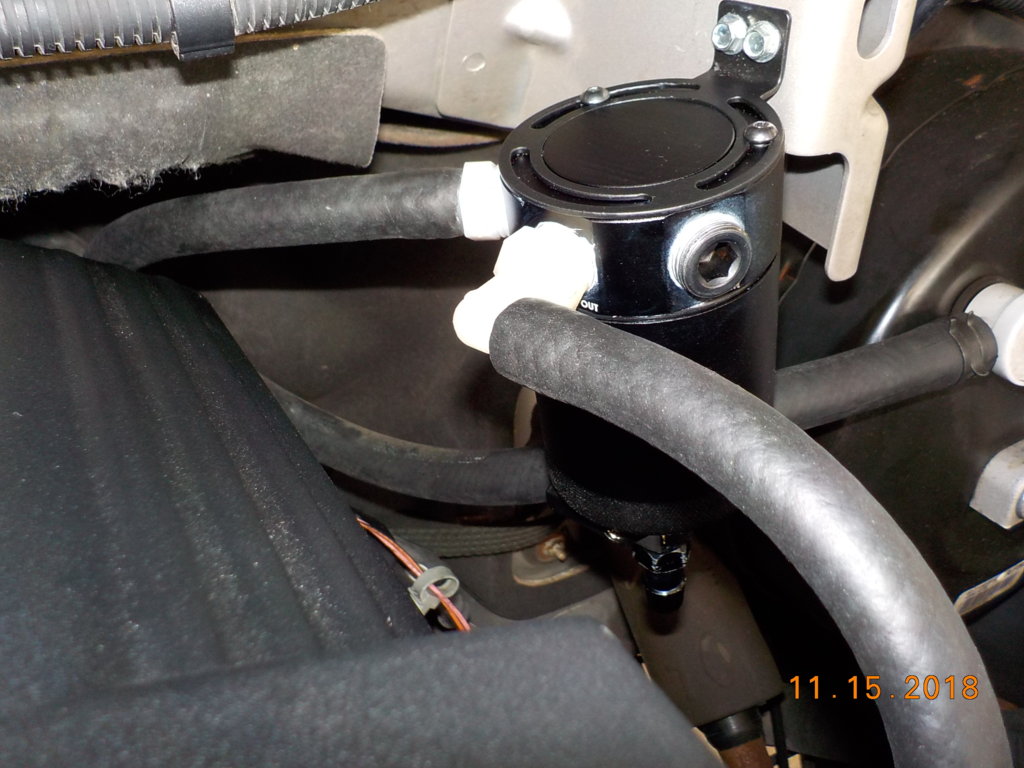

My catch can came with 3/8 and 1/2 barb fittings. I used the 3/8 ones.

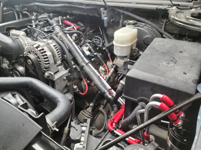

the main thing to focus on is the primary side for a catch can.
the side that goes from the driver side valve cover, and then right into the top of the intake.
I just snipped the plastic line and attached the extension for my catch can.
The other side is not a priority.
This is how i choose to do mine.
Mostly i had aluminum line left over from my vette project, and not enough silicone hose.
Too lazy to go to the store, this is how i ran it!
the red ends are the flex joints.
the long red line at the bottom of the fuse box is the flex joint for the can side.
The bits of red hose in the middle serve as an isolator, purely there to keep the hard lines from rubbing together, and against other hard objects.
the silicone hose was also left over from my vette project.
It's color scheme is red and silver... :cool:
