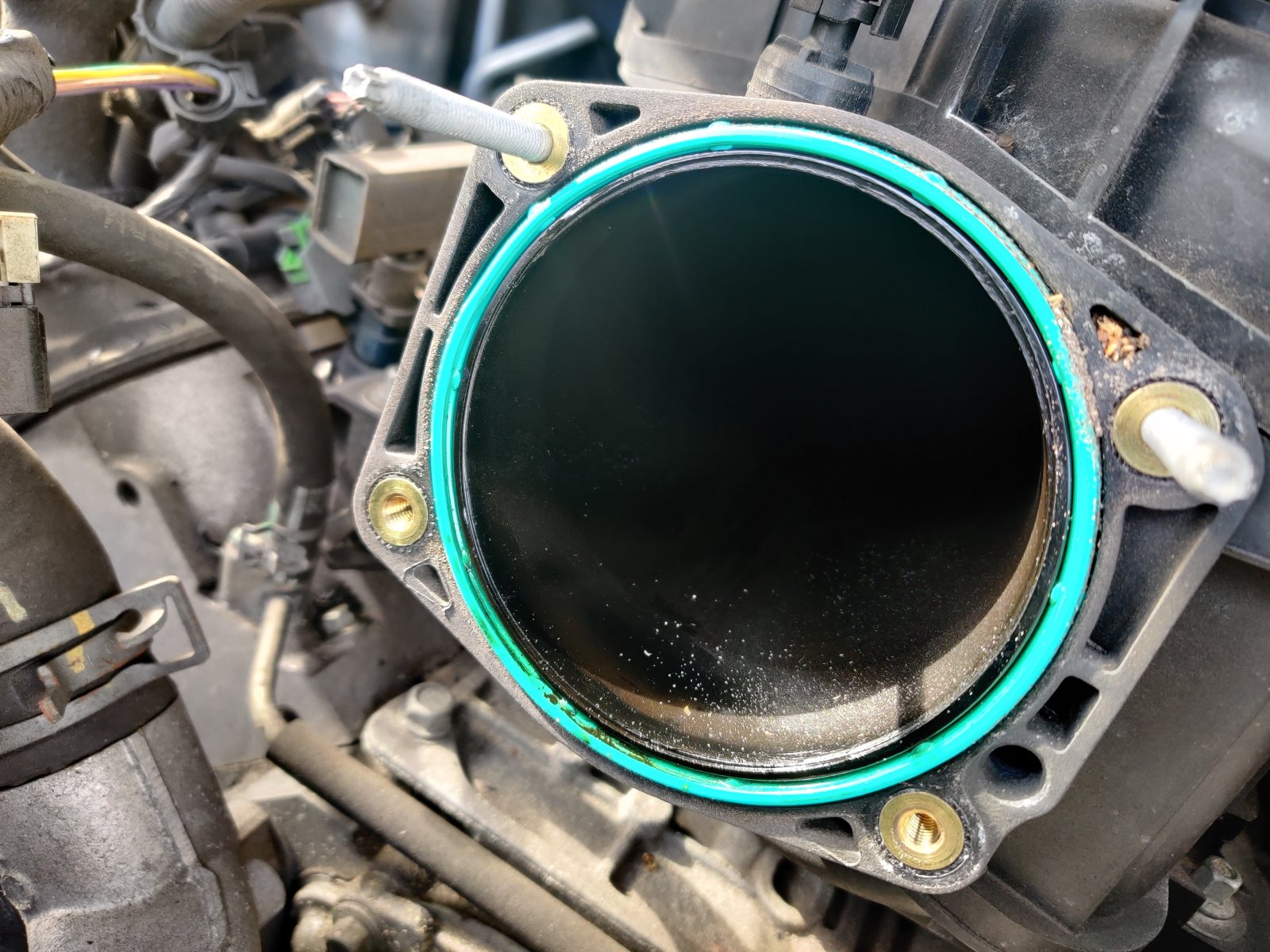

seems like every year I'm having to clean out my throttle body because of build-up so I wanna know what's a decent catch can to get? I see some around $20 that have the same design as more expensive ones. not sure which design is good or not. also would like to know exactly where to hook it up to. when I was younger I had a old Honda that had separate pcv for the head and block so I'm not sure if I would need a 2 port or a 3 port for our engines

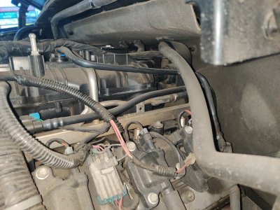

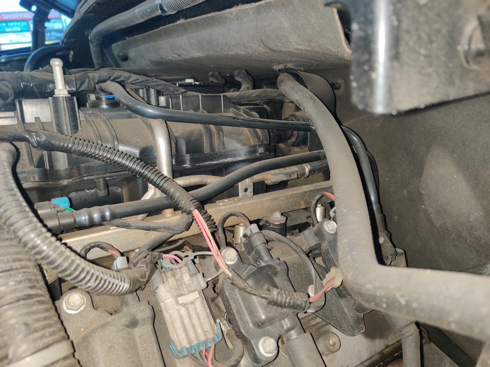

I see that is attached to the intake so isn't it under vacuum? and also I'm pretty sure that's the cause for the oil on
my throttle body
H
HACK BLOCK
Aug 18, 2017
541
179
NYC
oh and I broke that breather hose that goes into the intake tube. idk if I can use a T fitting and join it with the pcv going into the catch can then have it exit to the fitting after the throttle body

so how would you explain the oil then?
