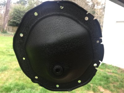

The diff cover was off and I had some crinkle paint so why not. I also did the whole truck with Meguiar's #2 Fine-Cut Cleaner today. Next step tomorrow. That will be the Tri-Nova either paint sealer or liquid wax.

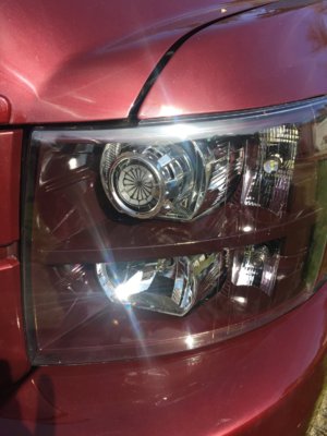

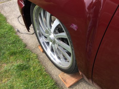

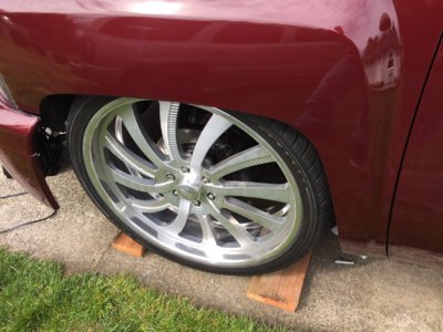

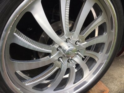

I never was a fan of the spiked lugs and I had a set of Gorilla's around but I needed a set of true locks so those came in and I swapped out the fronts. Here's a couple before and after shots. IMO this looks cleaner. I can't do the rears until the axles get installed. Also took another headlight glam shot. I applied the Trinova Liquid Wax today and I'll get a few shots later.

Which locks did you go with?

Durobans
