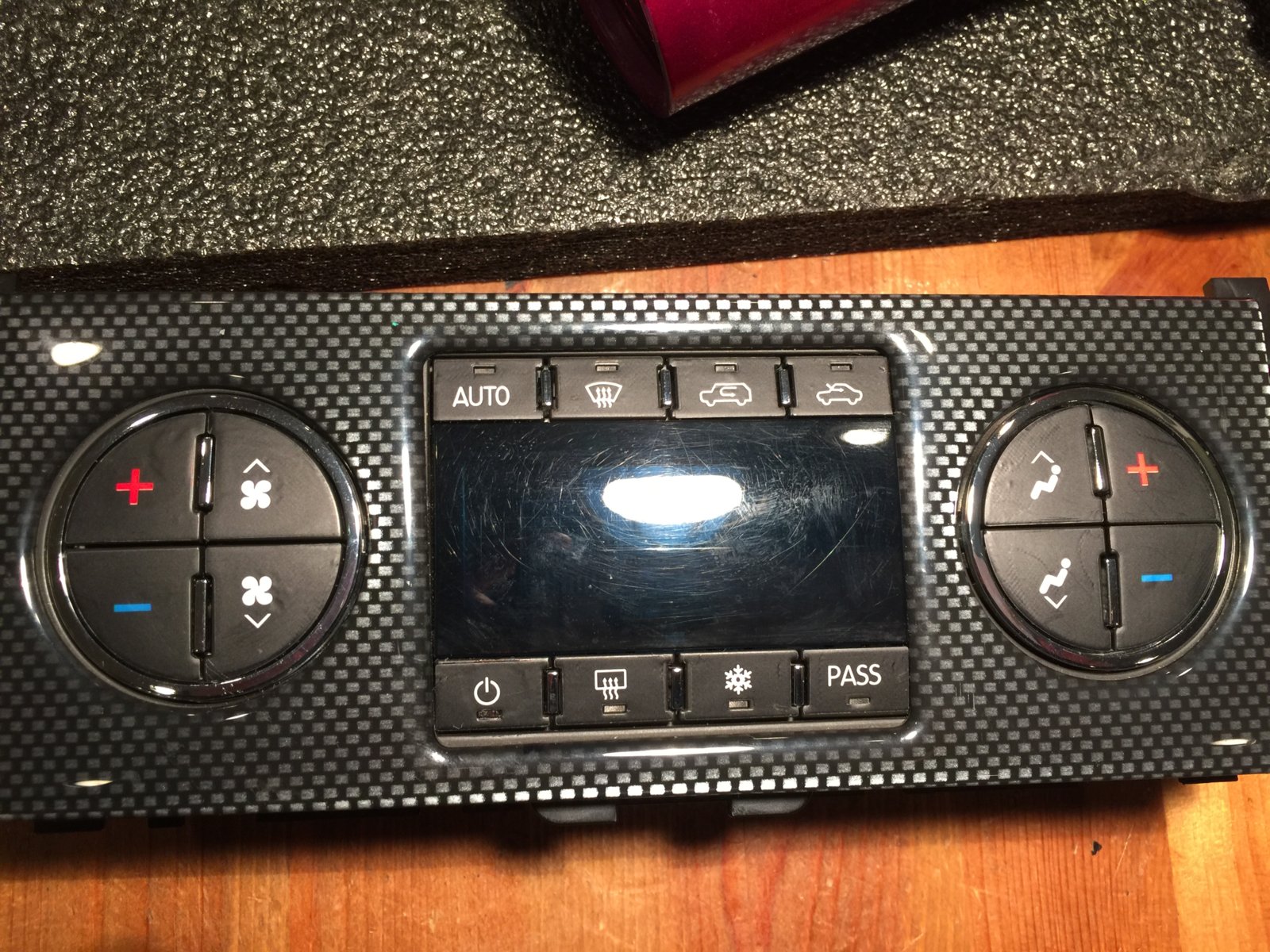

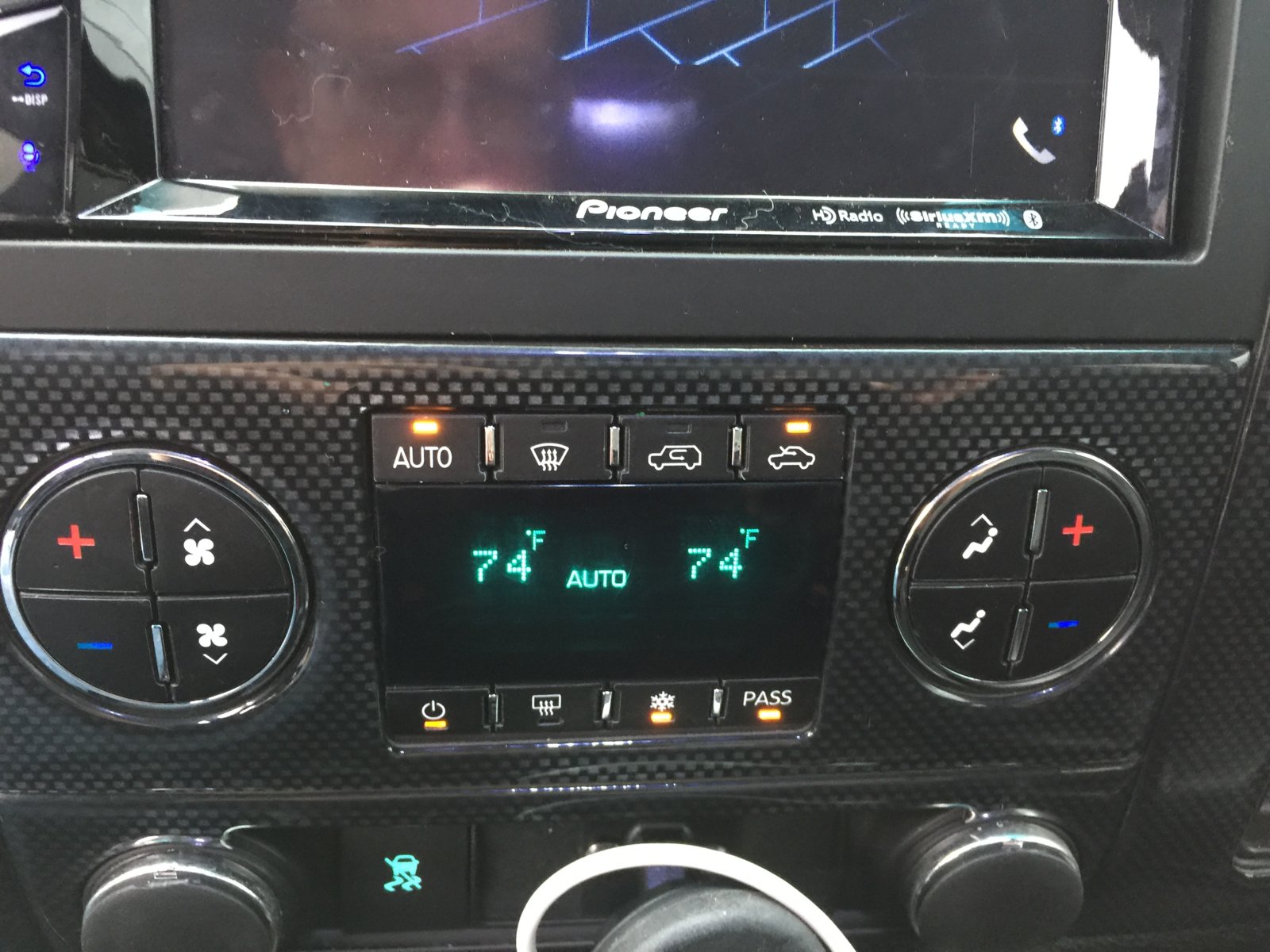

I also got the stickers for the HVAC controls and installed them. It looks pretty damn good during the day but at night it's not perfect. The backlighting for the symbols is not perfect like original, maybe because there's no way to line up the graphics perfectly. But it will do for now. If I find another control on Amazon warehouse deals for $85 I'll probably buy it and hopefully it will be the right one.
View attachment 195562 View attachment 195563 View attachment 195566 View attachment 195567
I scrapped the original symbols off the buttons, with a razor blade, before applying the stickers to avoid interference with light transmission.
52,954
Well, I bought 2 sets of stickers so I might try that. The instructions said to use a sharpie to color them in if they're too worn off which I didn't do but I never thought about doing that. Any pics of yours?
I would have to wait till it's dark to get any night pics.

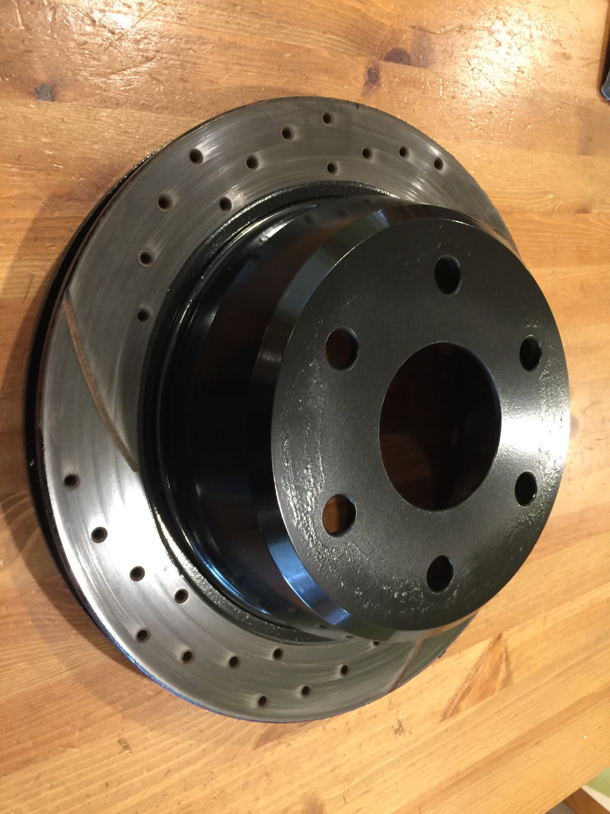

I couldn't get the rotors surfaced because they're drilled and slotted. They said the lathe would catch on all that. But I decided they will be ok for now. I was running them on The Beast without an issue for months. So I painted them at least with some caliper paint.
33,342
51,832
Maybe hit them with a DA sander?

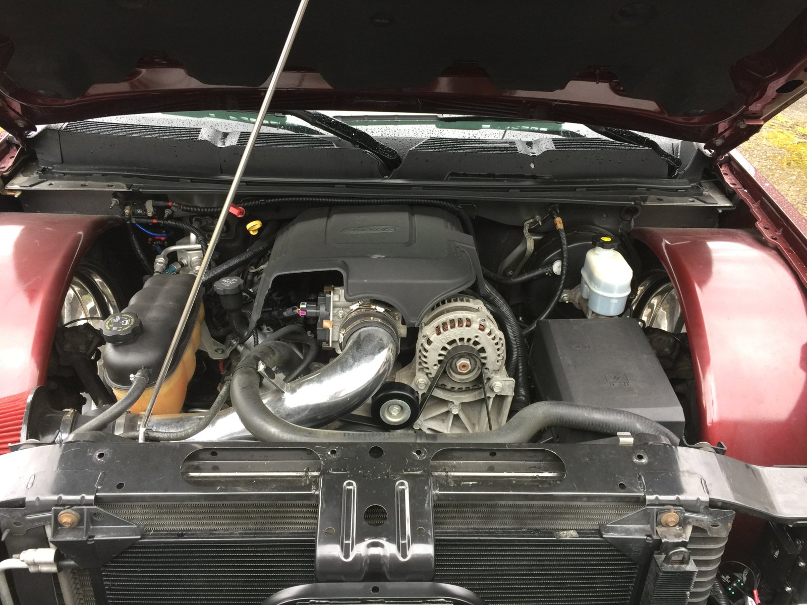

In case anyone was following another thread where some new dude was asking about his bagged POS and trying to educate me about the fact that I can install a York engine-driven air compressor for my system and I mentioned that most guys have to sacrifice their A/C compressor and that dude thought he was smart and shit and tried saying I didn't need to lose my A/C...let me set that subject straight. If you have a half-ass bag system ,you might have room but if you're tubbed for 28's like I am you won't have room. I barely have room for my relocated fusebox and overflow tank, as you can see. I have no room for any such compressor here.
Pads will wear into the grooves right quick.... ive used worse....lol

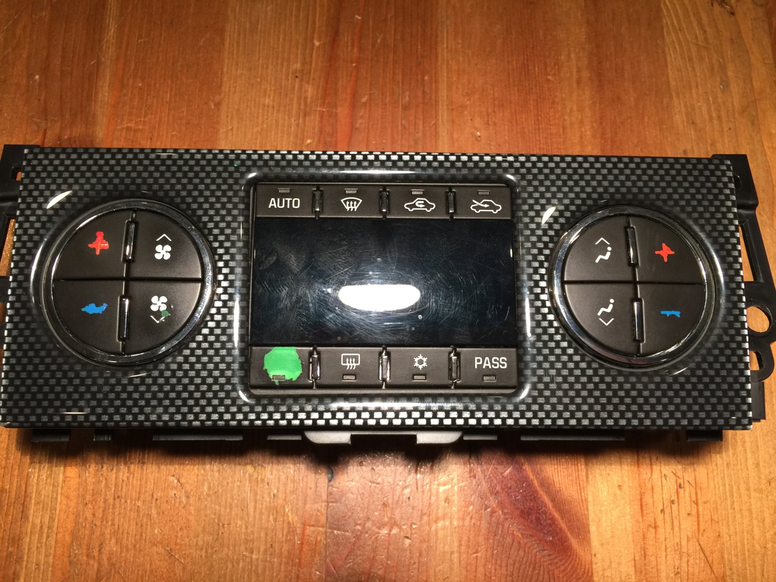

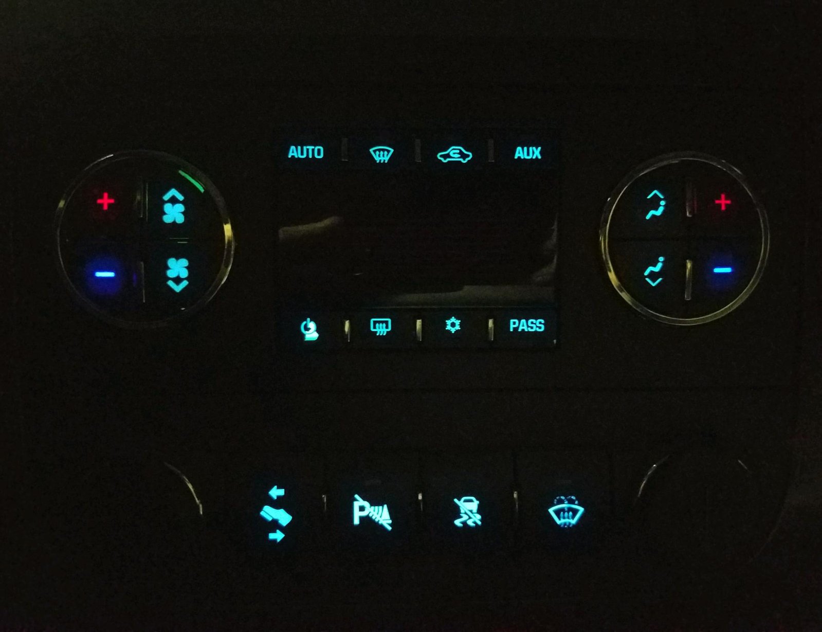

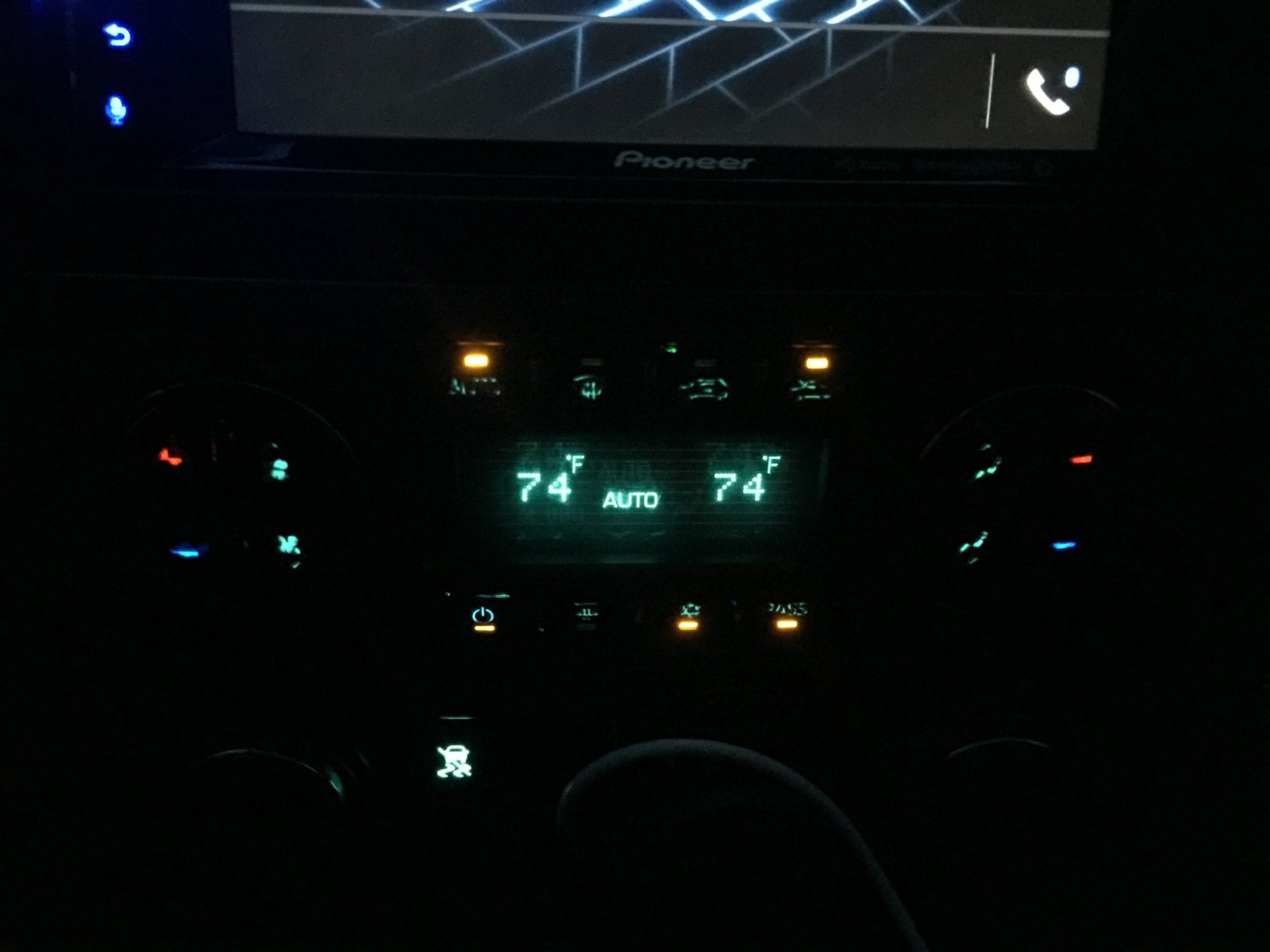

So here is a night time pic.
I wish I could remember what I did with the spare stickers I didn't use... looks like I need at least one for the power button.
I can't remember all the buttons I covered with stickers but I know for sure the drivers side temp and fan buttons are stickers.
52,954
Damn near perfect except that power button. My sets came with 4 or 5 extra power buttons. Anyway, no bleed through at all. Did you scrape everything off the buttons or just the centers?
kbuskill
Mar 11, 2017
5,861
9,931
NE. FL.
Actually, full disclosure, I had my wife clean, scrape, and apply the stickers while I installed the head unit.
I told her to just scrape the centers but she kinda buggered up the drivers side blower up button.... you can see a little green peaking through around the edge if you look closely.

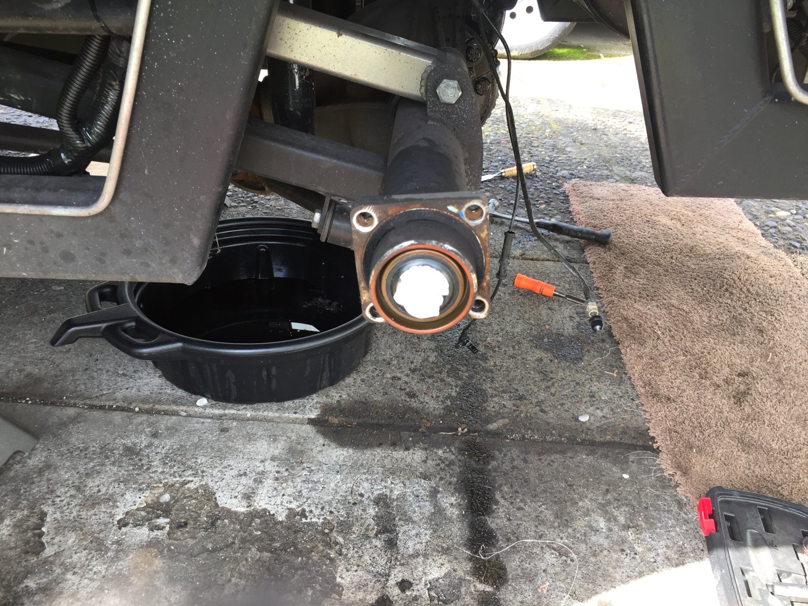

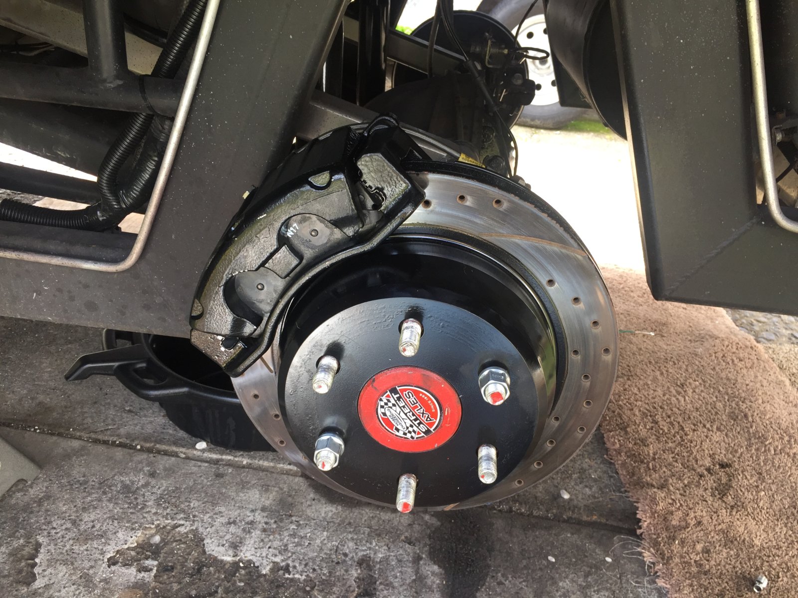

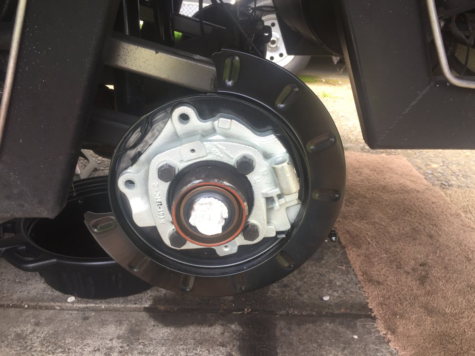

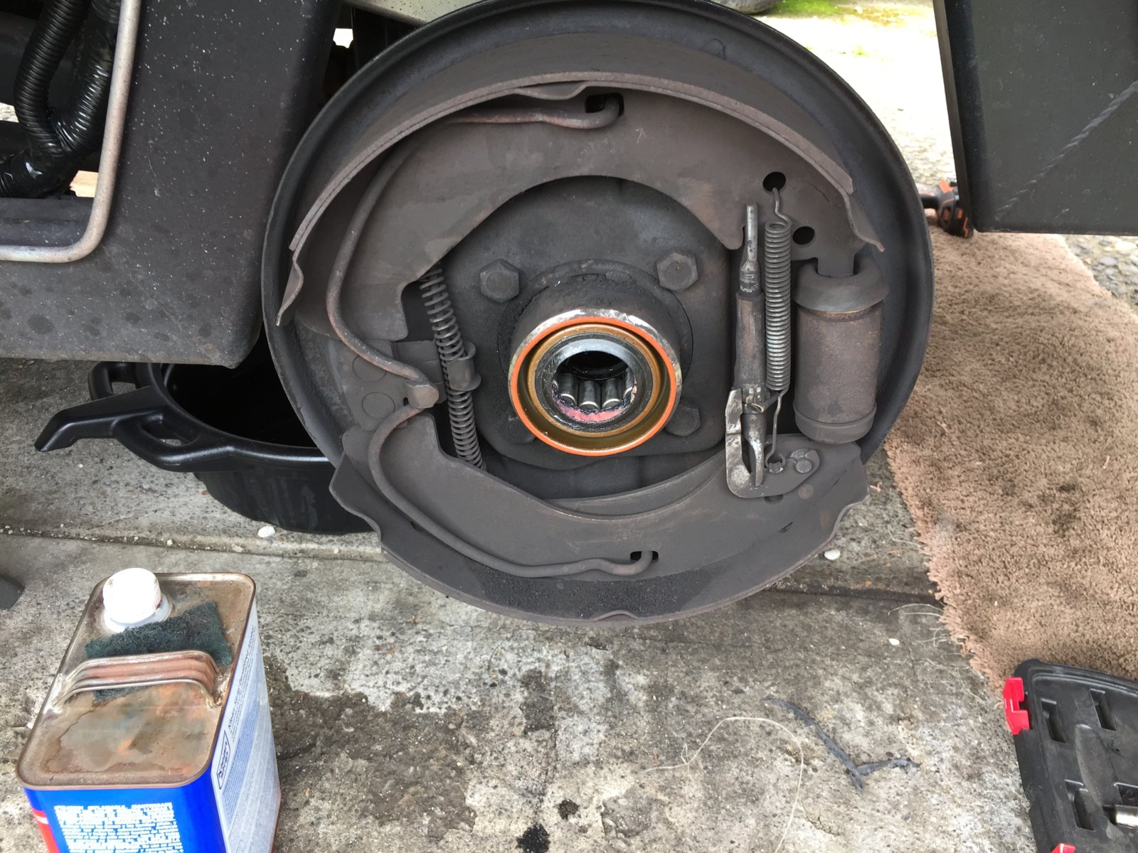

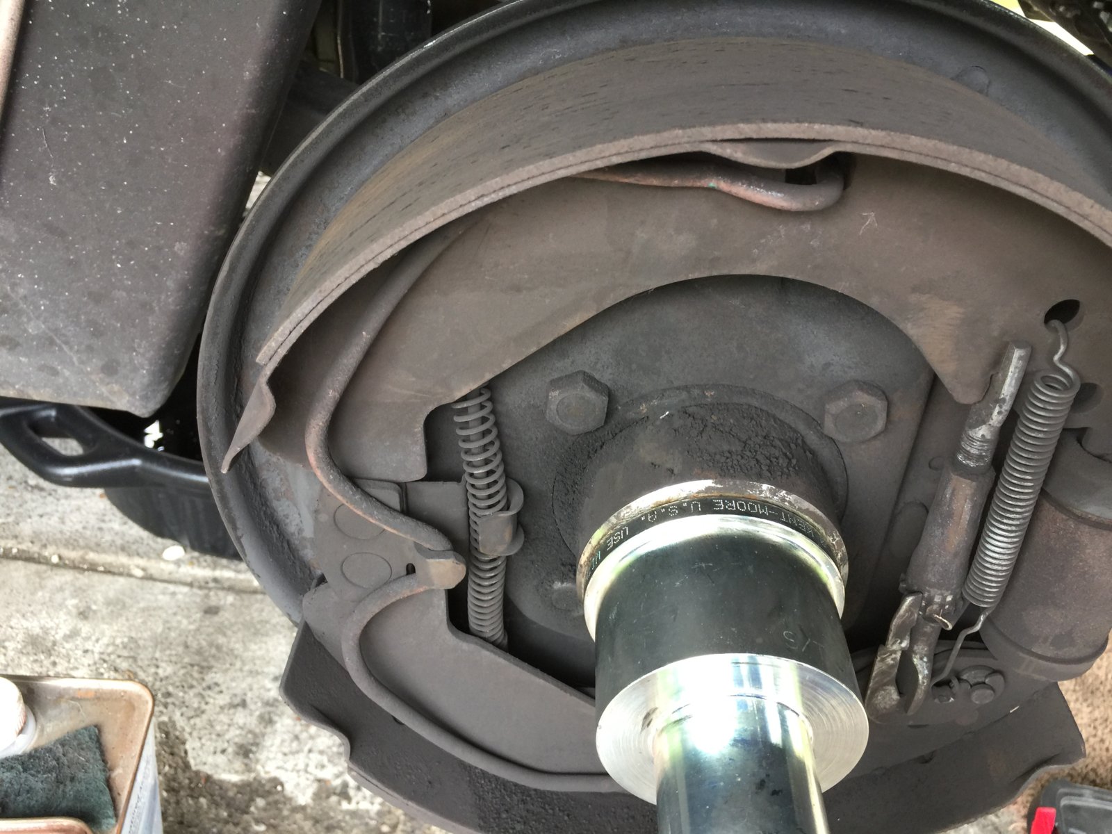

I got a whole bunch of loan-a-tools at O'reilly this morning and drained the diff and pulled the driver side axle. It looked pretty good and I slipped the ABS ring on it to see how it holds onto the axle and it's kind of weird. It isn't exactly super tight but it has a kind of black goo inside and when I slipped it on the axle when it was out of the rear end it left this stuff on the axle. I tried the old one first and it spun pretty easy and had what looked like silicone oozing out of the holes inside. Anyway, I replaced the ABS ring (and it's a good thing I bought the special tool or I would have had no way to set the depth correctly), then the bearing, then the seal. Then I removed the drum assembly and installed the disc brake backing plate and dust shield and went to reinstall the axle but I hadn't read the part about temporarily reinstalling the pin inside the diff that holds the axles in and didn't realize that pin also locates the spider gears so the 2 small ones fell out. I found the thrust washers and got them back in and reinstalled the pin temporarily. I was nervous because somebody tried to tell me I'd need spacers for the brakes but everything fits perfect. And even the brake lines will be easy; I won't have to cut the old ones and do a double flare because the connections are right at the center top of the diff and I'm just gonna get new shorter hard lines and bend them so they fit to the stainless hoses.

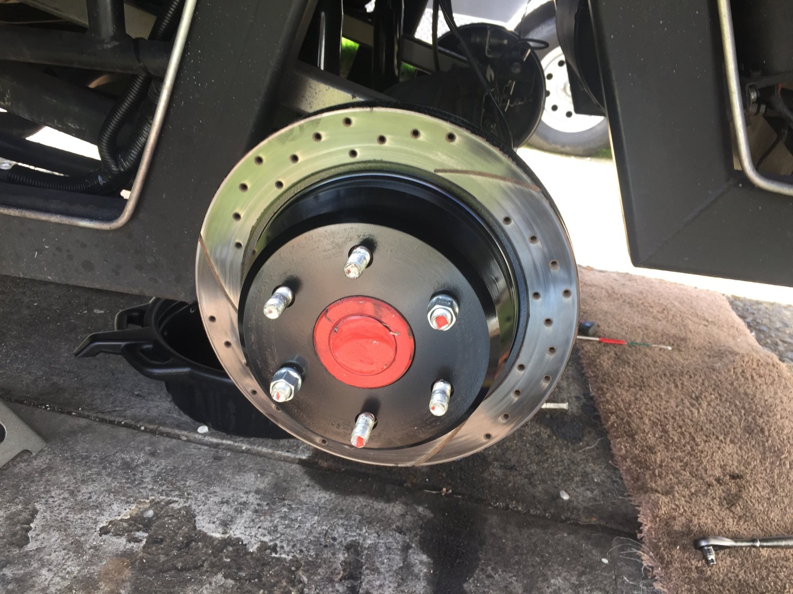

It's been so long since I've done drum brakes that I even forgot how so by the time I was done removing them I was thinking the disc brakes better work or I might never get the shit back together. Anyway I got the driver side done except the brake line and the passenger side should be easier since I'm just replacing the seal and doing the conversion. I think I'll wait until tomorrow to finish it.
View attachment 195713 View attachment 195714 View attachment 195715
Def lucked out with the lines. Looks so much cleaner.
52,954

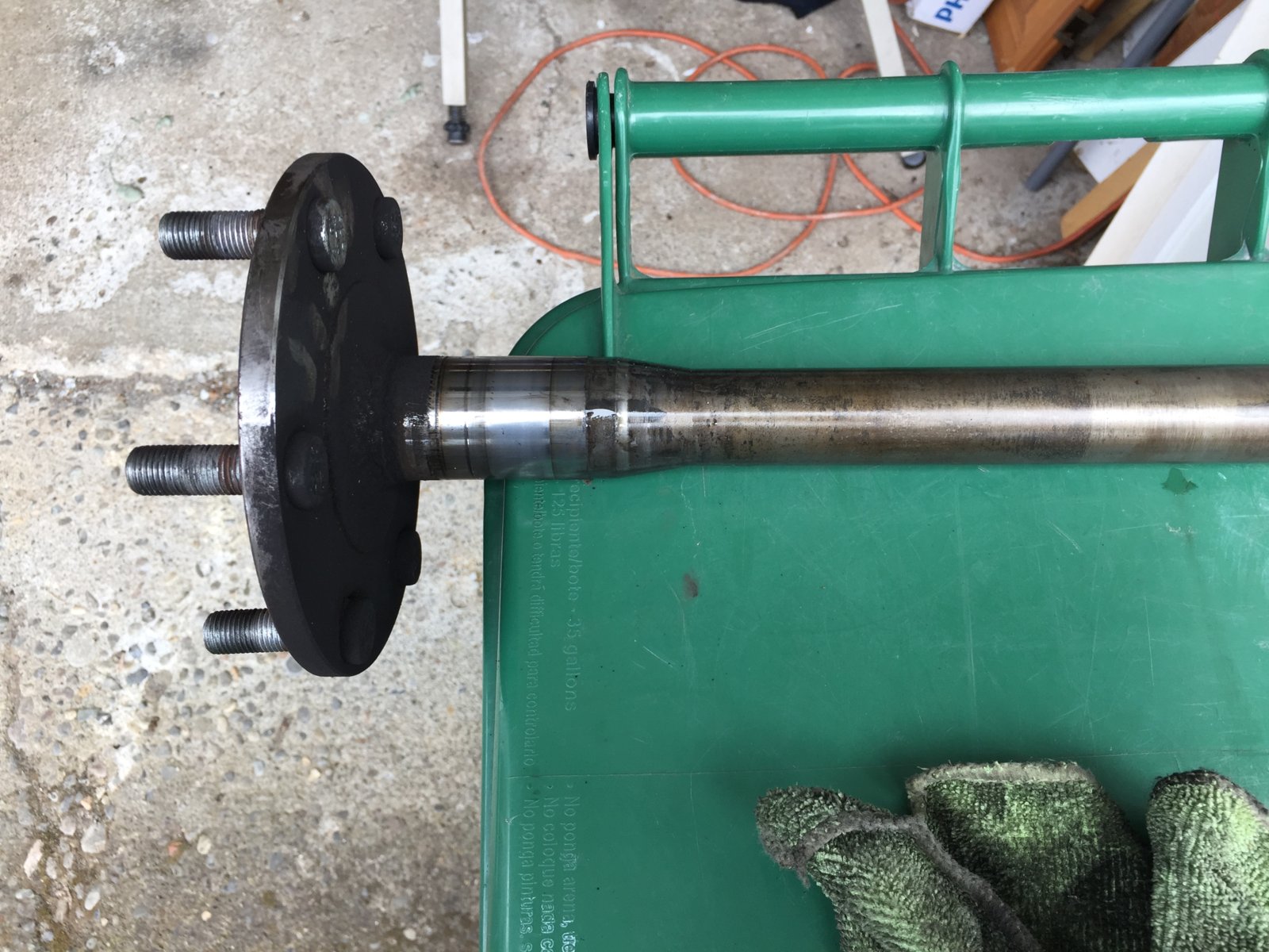

Well I did not luck out with the ABS ring. I forgot I hadn't checked to see if it's still spinning freely and it is. I think there's something wrong with the axle, as in the machining where they turned it down to a smaller diameter starts too close to the outboard end. I've reached out to Mosier axles to see if there's a measurement from the end that I can check. The ABS ring is actually so loose that I can move it up and down a little and I used the correct tool to set the depth when I installed it so I'm pretty damn sure it's not the ABS ring. In fact the original was probably Ok too. I am kicking myself for not taking measurements on both axles while they were out but I'll take them both out tomorrow and compare. If one's different I'm gonna get them to ship me a new axle. This is upsetting to say the least. AAARRRGGGHHH!!!
